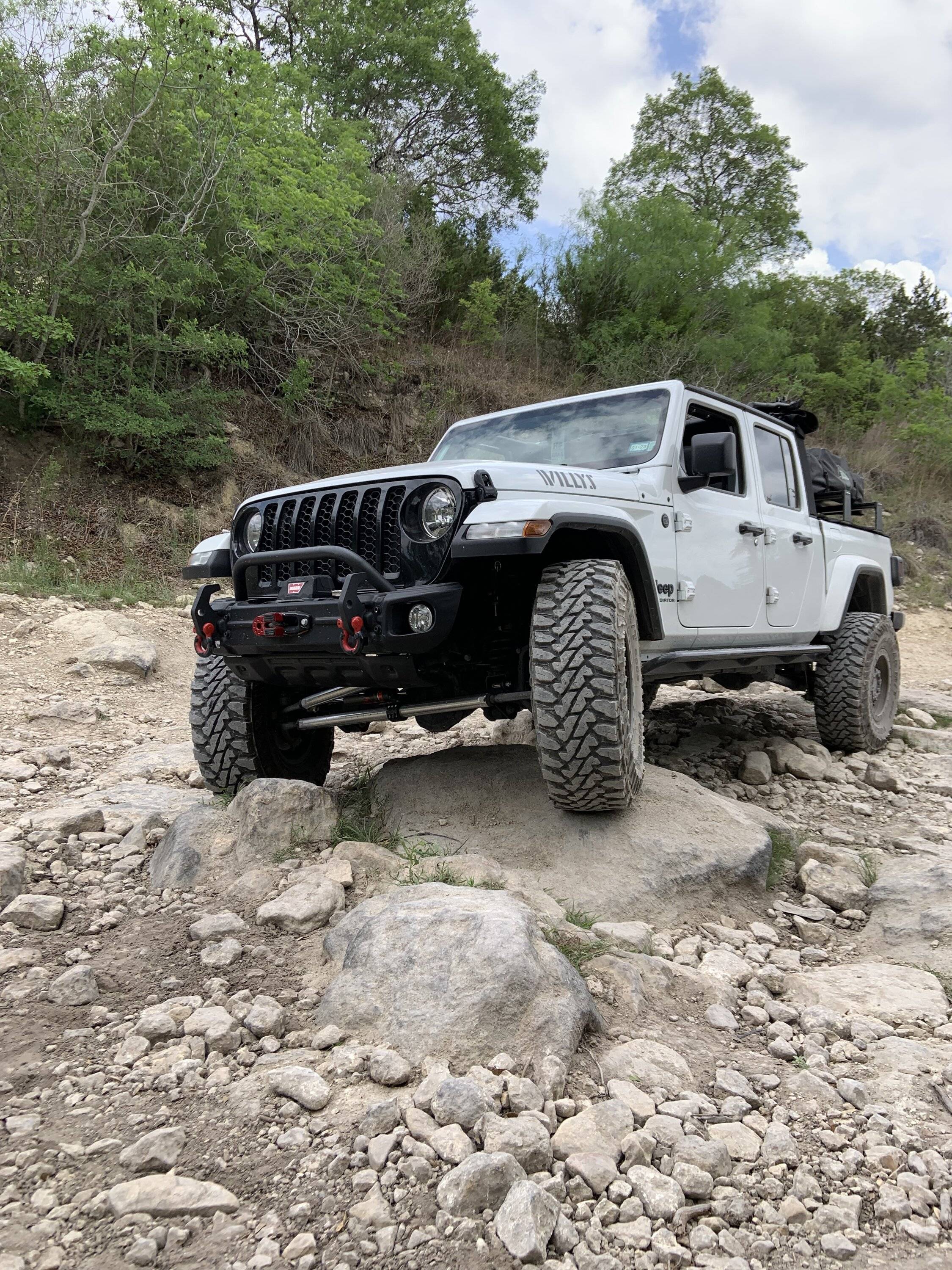

I think I'm going to pull the trigger on a ball joint delete kit, and it just makes sense to do the knuckles while I'm at it. I'm running a 2.5" Clayton Overland plus kit with a 1/2" spacer up front along with RPM 2.5 ton steering. I know these kits over deliver on their lifts, so I'm probably right on the edge of the height that would be required for a drag link flip. Trying to decide if I should order the knuckles for a flip or not.....
