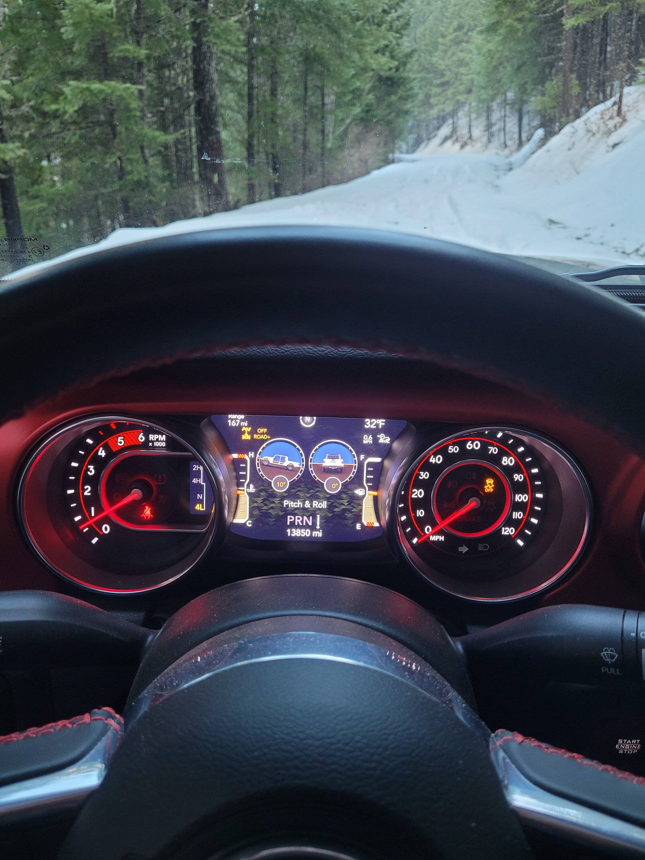

Went for a quick drive today, wanted to test the offroad+ and duck mode out.
Jeep Gladiator Driving in 2 feet of snow 20221231_160252
Seems to help. I had more of an issue climbing the hill on my own than the Jeep did using all the tools at hand. With the snow quality, the only way I was going up that hill was to crawl up it. The duck mode was better at holding the throttle just right.
