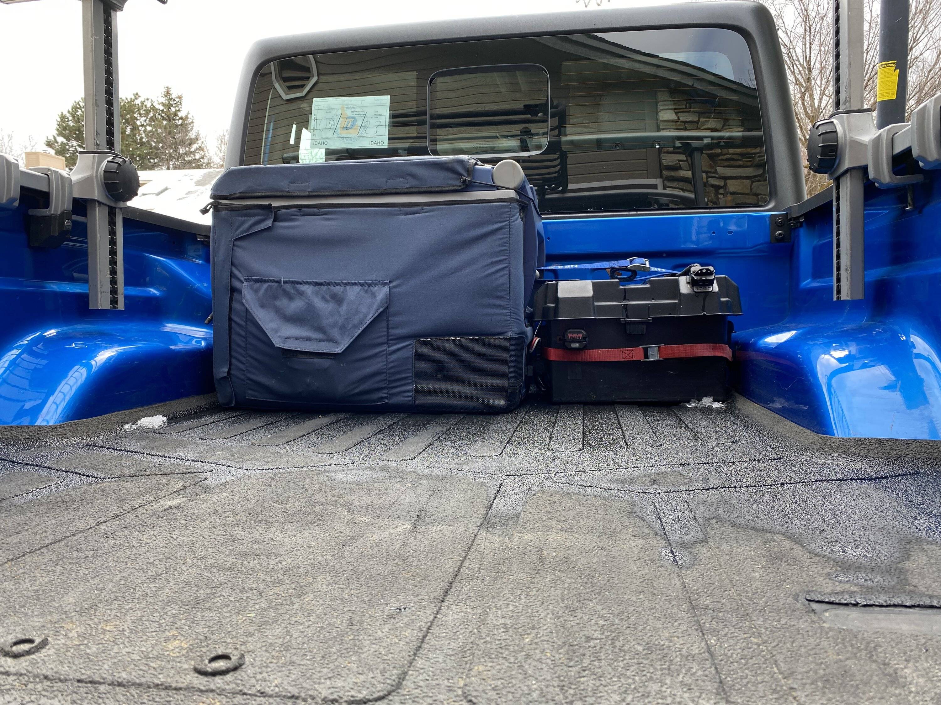

Currently using a group 31 First Interstate Marine battery in the bed to power winch, lighting and bed accessories. Note: I kept that battery completely separate from the JT’s electrical system, due to the complex and fussiness of the entire JT system, not to mention the lack of bs that I’ll receive from the dealership for attaching said extras to their denial of warranty work. Charging is done through a small attached battery tender every couple of weeks. I’ll post some pictures next week.

This is the battery (G31) in a Wmart $12 box and in the best location my bed. Not platform connected yet. Still welding on the frame that will quick mount to the bed, it will house the ARB and the battery.
ARB changing port mounted on box wired to battery and fused.
pigtail battery tender plug hardwired to battery.
1/0 welding cable from battery with Anderson connectors that leads to winch on front bumper - Big amp breaker (marine) also mounted on the box.
Warn remote sensor for the winch mounted to the box and a toggle control hardwired as well to the box for back up.
this setup runs the fridge for 2.5 days on a charge, if you pre cool the fridge before packing.
I’ve done several pulls with the winch and no issues. But plugged into the tender that day after winching. So for this setup has worked for my needs.
hope it helps.

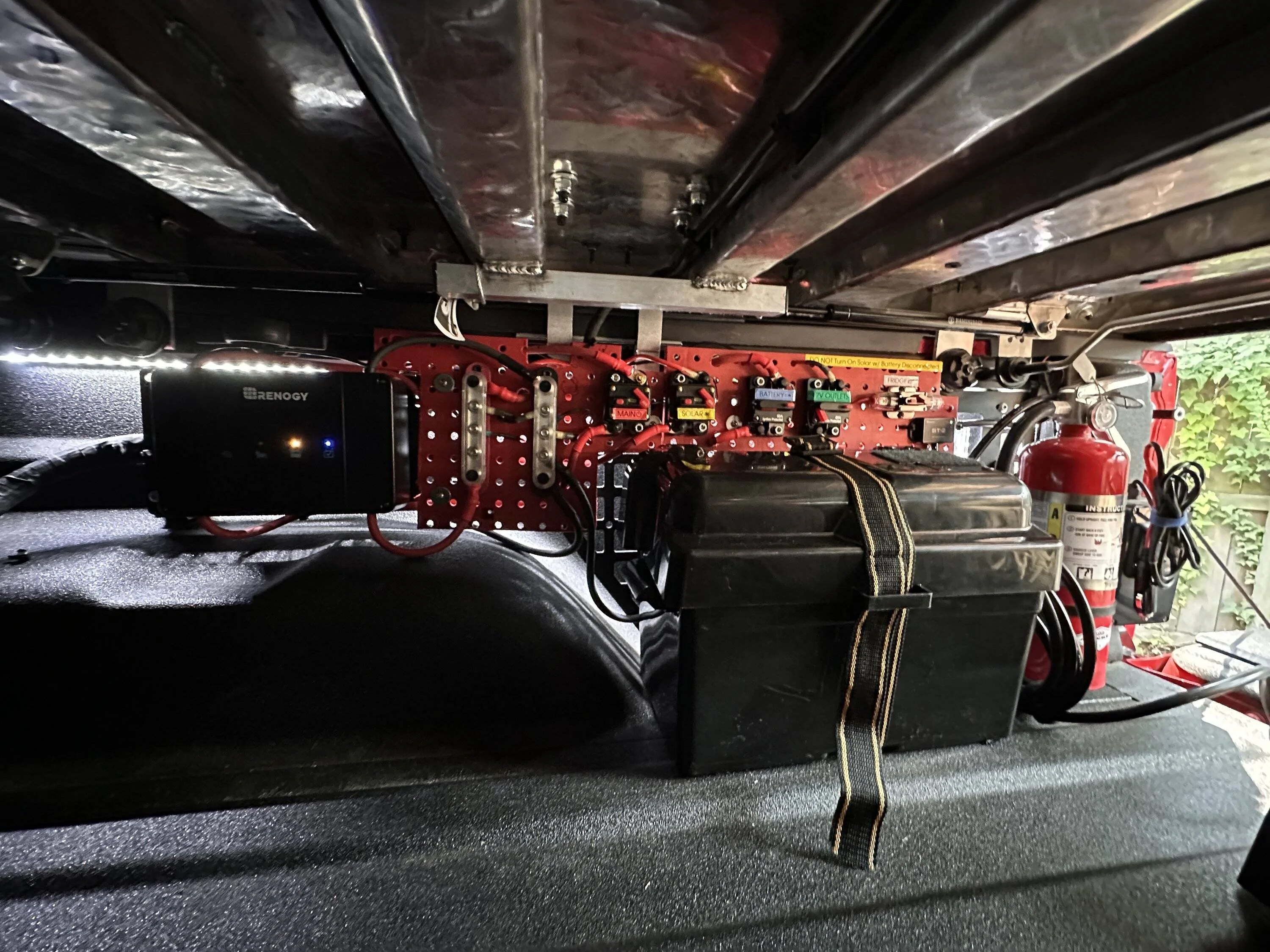

Not sure from the wording of the OP if you mean a dual battery or a house battery, but here’s the thread on my setup.
Jeep Gladiator Dual Battery - Bed ? IMG_1872
https://www.jeepgladiatorforum.com/forum/threads/renogy-lifepo-house-dual-battery-install.71866/
I don’t run driving lights, winch off of this. That still runs off the starting battery. I’ve never needed a dual (parallel) battery for winching. My utility, camping, awning lights, fridge, inverter, water pump, etc., run off of the bed batter.
I’m in the process of redesigning the box/mount for the battery itself. I’ve got a tender port for the starter. I’m going to add a switch to allow the tender to charge the house battery too, but my solar panel usually handles that
