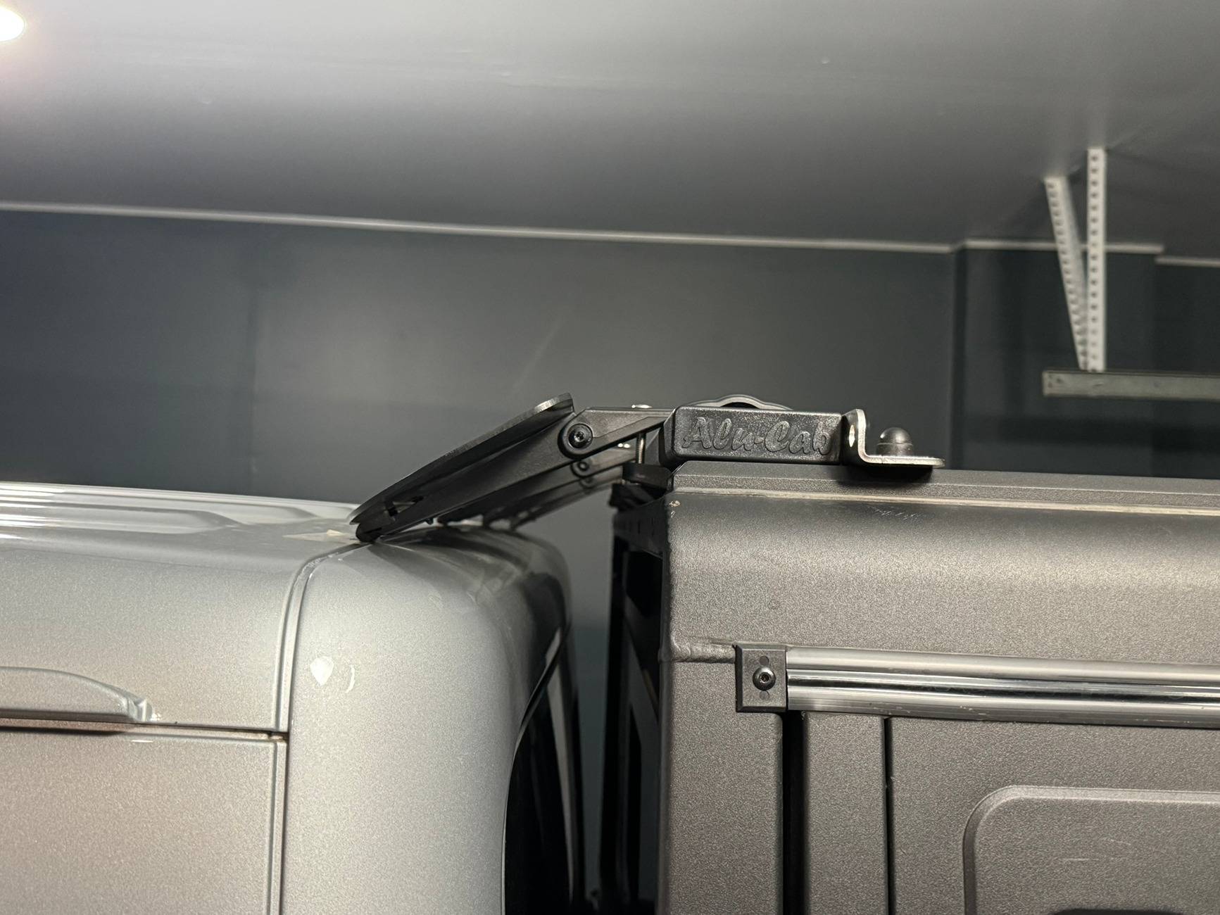

As I said last night I have the earlier version of the canopy and it looks like I have about the same gap as the OP without any buffeting. I do leave the crossbars on all the time but I don’t know if that comes into play.
Looks like @smlobx might have a slightly wider gap from cab to canopy. Is this adjustable at all - more to the rear to widen the gap?
Has there been any front end mods that would modify the airflow over the grill/hood/windshield?
Does opening the windows eliminate the buffeting?
I’m wondering if a small air dam at the top of the canopy would be enough to divert the airflow… like you did with the cardboard, but from the canopy forward different lengths/angles to see how narrow the gap needs to. be to stop the buffeting.
someone else mentioned a plate between canopy and bed rail gasket to extend toward the cab. For a down low air diverter - maybe only needs to be a little wider than the cab vent to divert airflow to the sides away from the vent.

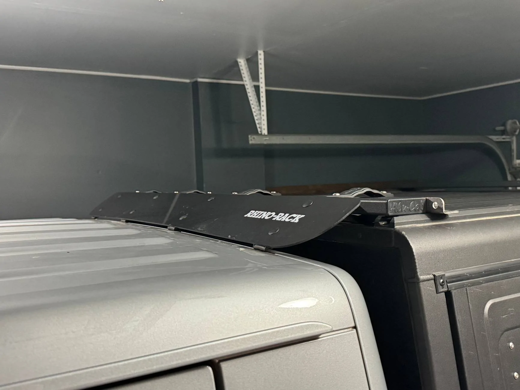

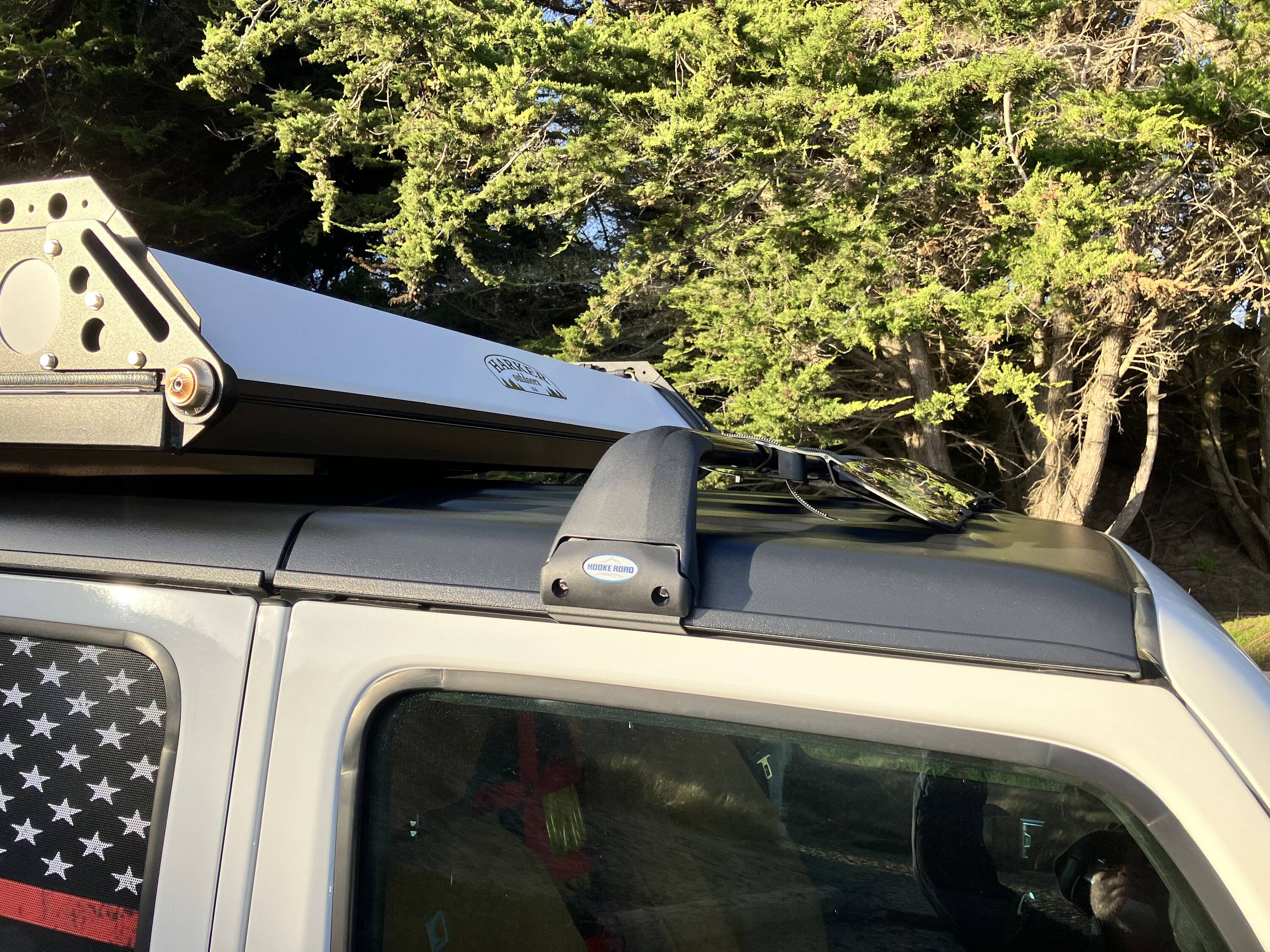

Hi, updating this with the results. So as stated earlier the tubing in between the cab fixed the issue, but was a poor solution. I ended up installing a fairing that bridges the gap and this entirely fixed the issue. Here are the parts I used:
- Alu-Cab Load Bar 1250mm - Black
- Alu-Cab Low Profile Load Bar Mounting Feet
- Rhino-Rack Wind Fairings - 50 Inch
- 3M Clear Paint Surface Protection Vinyl Film
Obviously the feet then are resting on the top of the cab and rub. To lessen the long term damage I installed small strips of the film under the rubber feet. If they get dirty, they will occasionally squeek when the cab is rocking, so clean it off.
I am happy with the solution for now, although obviously not great that I felt the need to do this or my ears would have driven me to buy a tacoma. No data on how many MPGs this is giving me, but I feel like I am able to take corners much faster now.

You can probably move that deflector back away from the cab so it is not rubbing on the cab. Let the front edge hang into the gap and it might solve the problem without the potential for paint damage.
