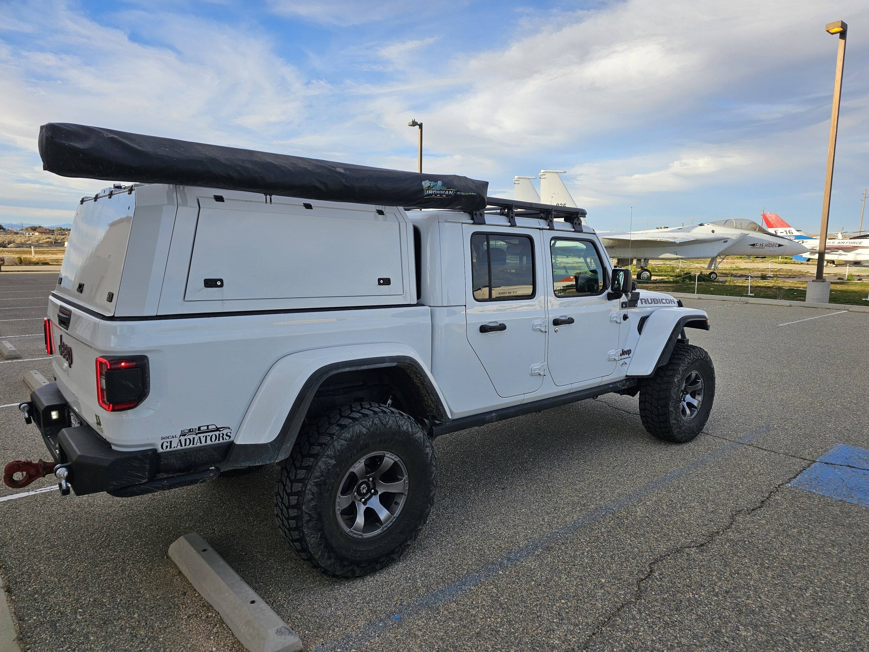

I have a DIY seat delete and a non RSI cap (damn near same) and don't have that noise issue.....
Off the top of my head, it the cardboard on top worked, why not get a peice sheetmetal and place it between the bed and the cap horizontally between the cab and the bed.... makes a small inconspicuous wind deflector just above the vents
I would think the platform rack you have is disturbing enough of the a slip stream over the cabin to prevent the issue OP is having.
That being said, what cap is that?
Good theory, but I just installed that rack about 3 days ago. Lol.....
Its the Chinese version, and uses same latches as RSI and its a great top, well made and solid
I stand corrected!
Probably has something to do with whatever variance between the AluCab and the Chinesium's shape is on the leading edge then.

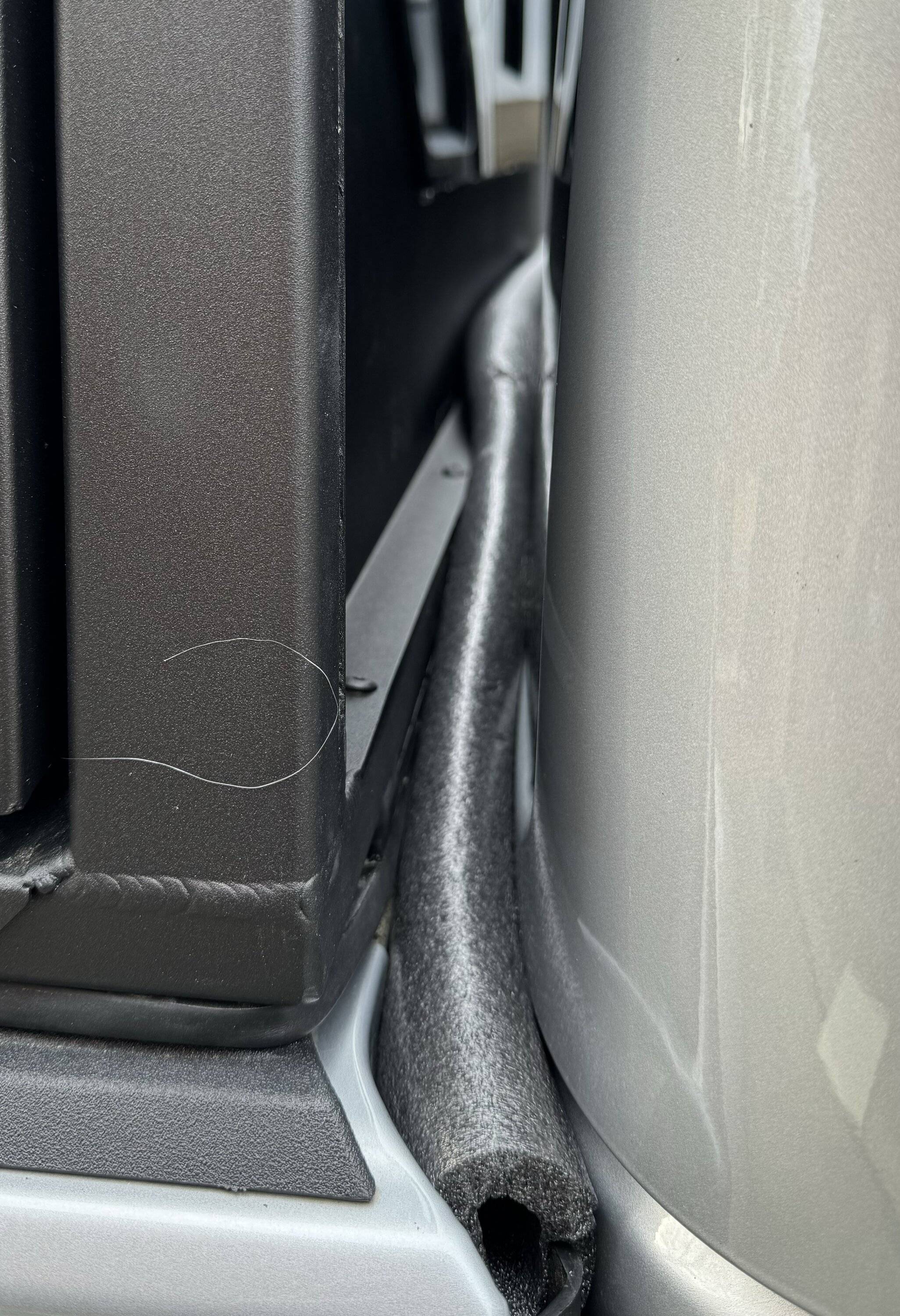

For now I have some insulation installed and it seems to have fixed the flapping and reduced the cabin buffeting. Still might look into a simple gutter fairing to try and really fix the problem and give me .25 mpg back.

That will collect road grit and grind it into your paint finish. I wouldn’t leave it there for long.

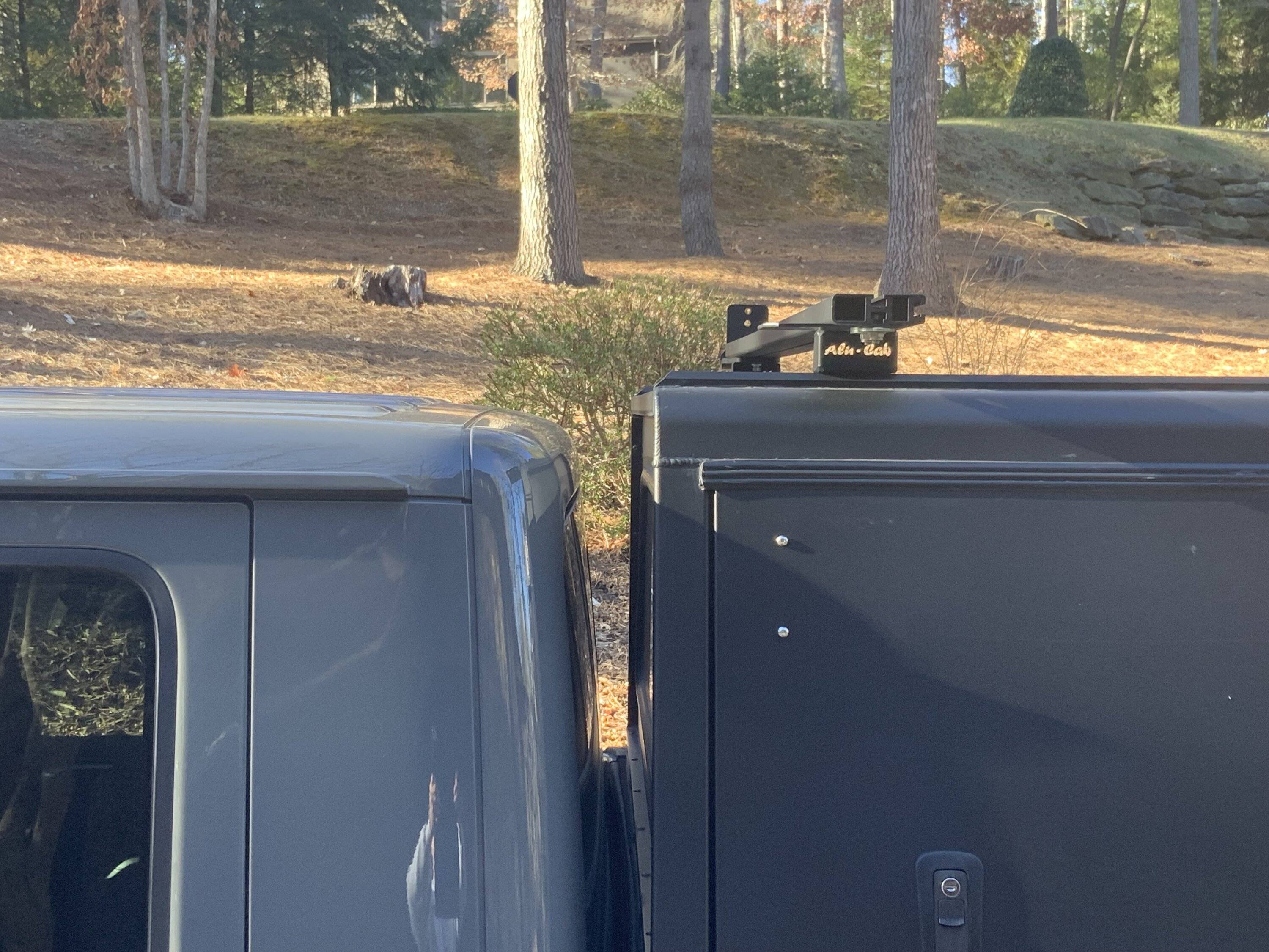

This is what I’m working with
As I said last night I have the earlier version of the canopy and it looks like I have about the same gap as the OP without any buffeting. I do leave the crossbars on all the time but I don’t know if that comes into play.
If you were closer, I would sell you my spare gutter roof rack cheap as I had to buy a complete set. Hope you figure it out.
Might be the seat delete combo and tinnitus ridden ears. I’ll try some sound foam covering the rear wall too.
That crossbar probably does cause enough negative pressure up there to move the air slightly differently. That could be a relatively cheap fix.

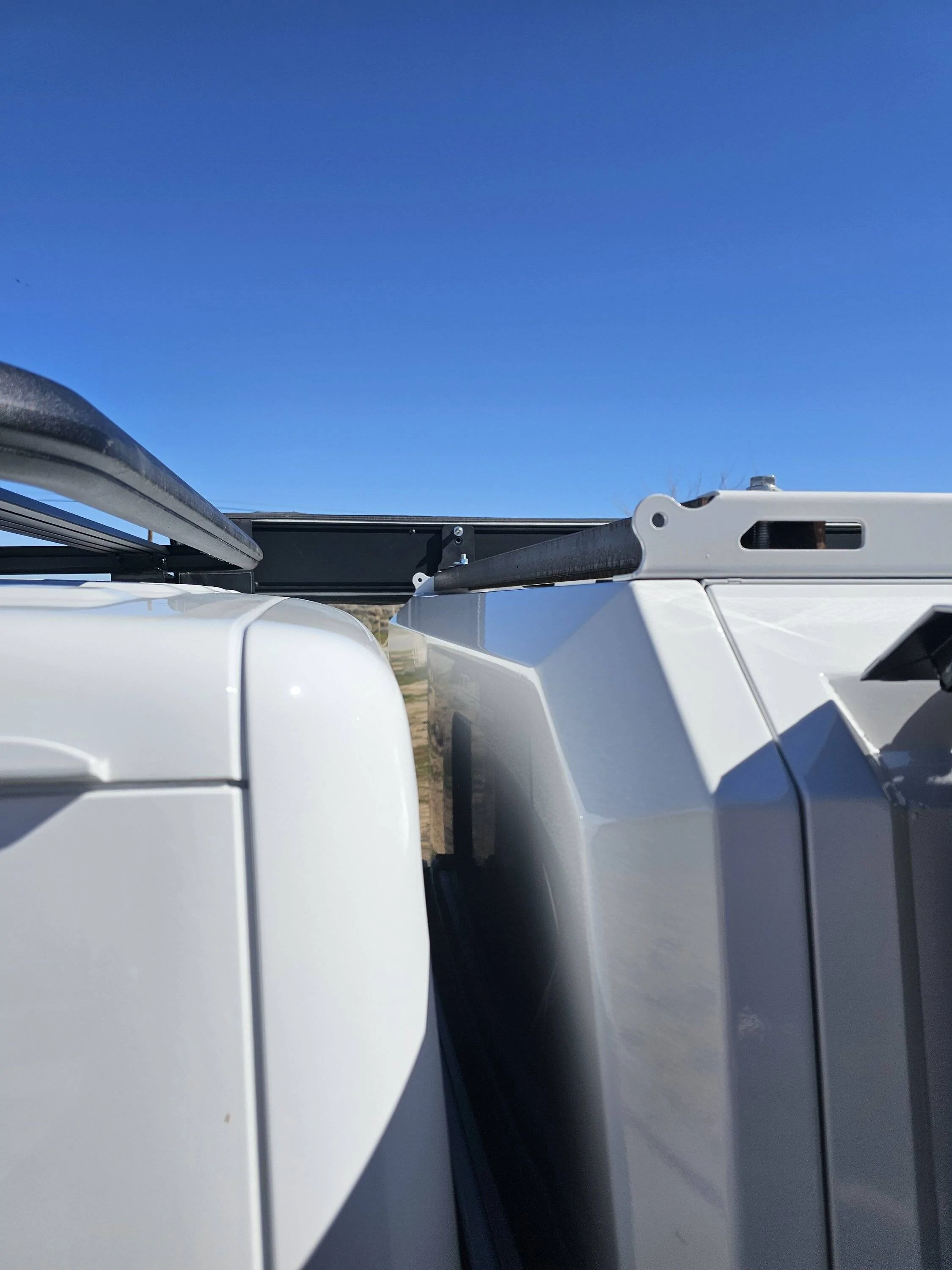

I did also confirm that I can stop the flapping noise and somewhat stop the ear pressure (not totally sure) by placing several towels and a 2 inch thick piece of foam pressed up against the back of the cab where the seat once was. So the theory of slowing down the air has some merit.
I have removed the noodle after more thinking about the paint damage. I’ve ordered an alu cab low profile cross bar/rack and a rhino fairing which should extend forward and complete cover the gap. I hope this works and offers a more permanent solution.
Longer term I’ll be removing that flimsy plastic rear wall and replacing it with something like the goose gear rear plate and maybe putting some dynamat on the back wall and acoustic foam on the goose plate.

I doubt the rear seat delete has anything to do with it
The bed cap is causing the buffeting. The rear cabin vents are the entry point for the air. I think it's easier to block those vents to stop the buffeting than to fab something to the roof.
You don't want to put a sheet of metal/plastic on top of the roof because there is a small amount of movement of the cab relative to the bed, so anything mounted to the bed rack that's also stuck to the cab will rub the paint off the top of the cab. OP If you want to buy a rack and deflector to put up top then go for it, if you want a cheaper option then block the vents.
