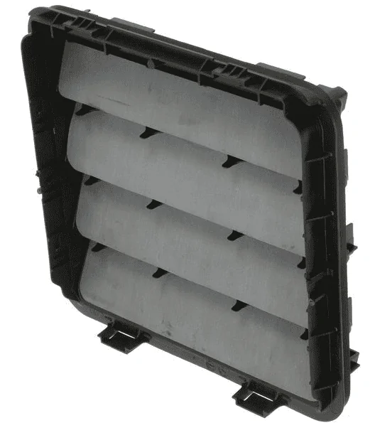

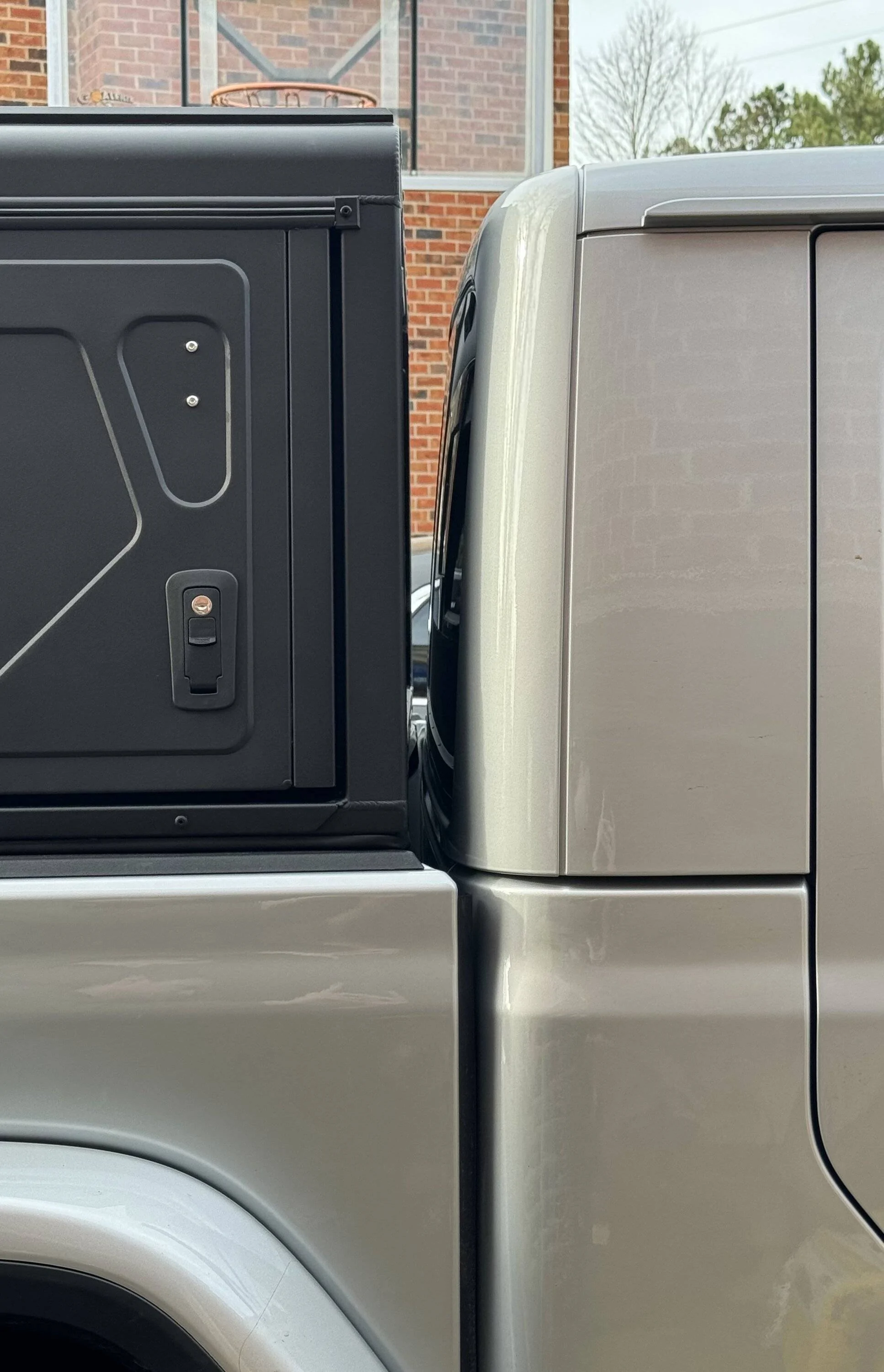

There are two vents on the back of the cab (behind rear seats). Not sure if they are freely vented to atmosphere or if there is a flapper/damper. It's possible the low pressure area between the cab and cap is creating oscillations in pressure and relieving through the vents (into the cab). The tape mentioned above would be a cheap way to check if the height (and gap) of the cab is having an impact.
Yes, those are the vents I’m talking about. They are free to air if you look down from the top of your bed. If you look down the crack and close your doors, you can see them flare out.

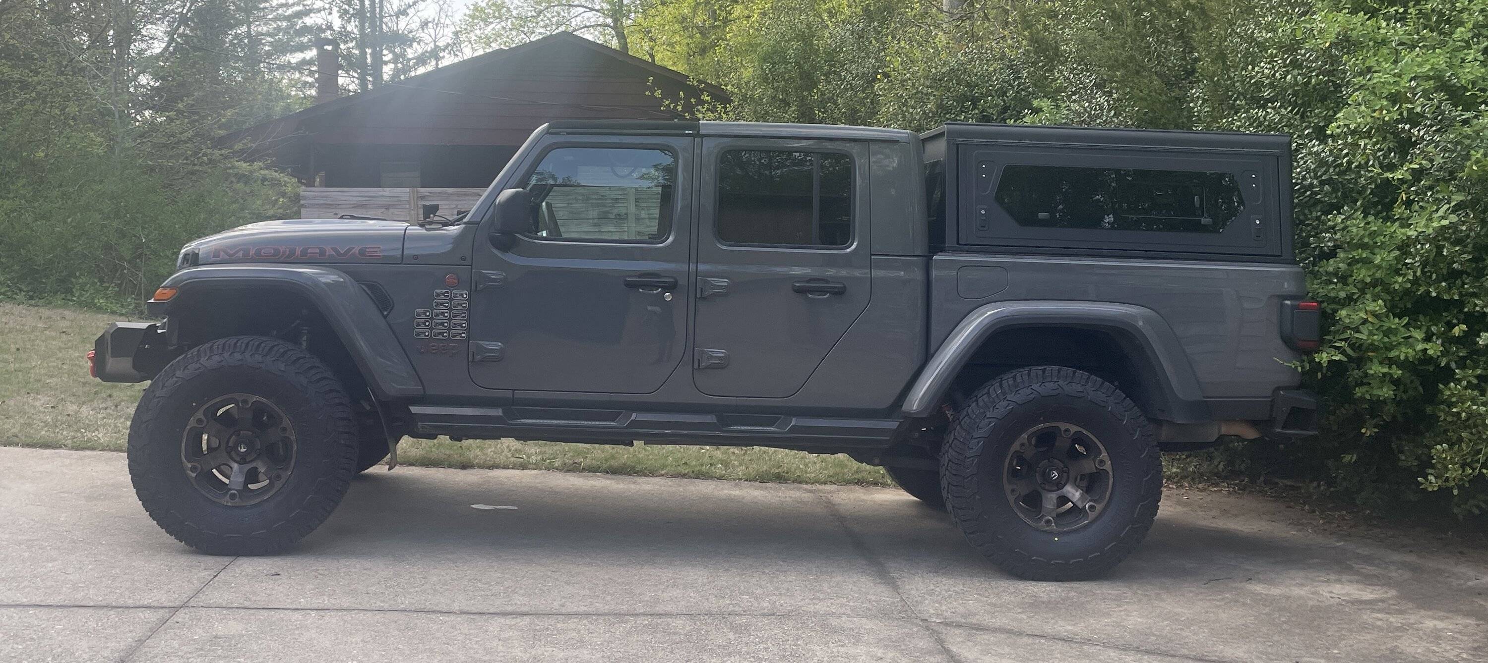

This is what I’m working with

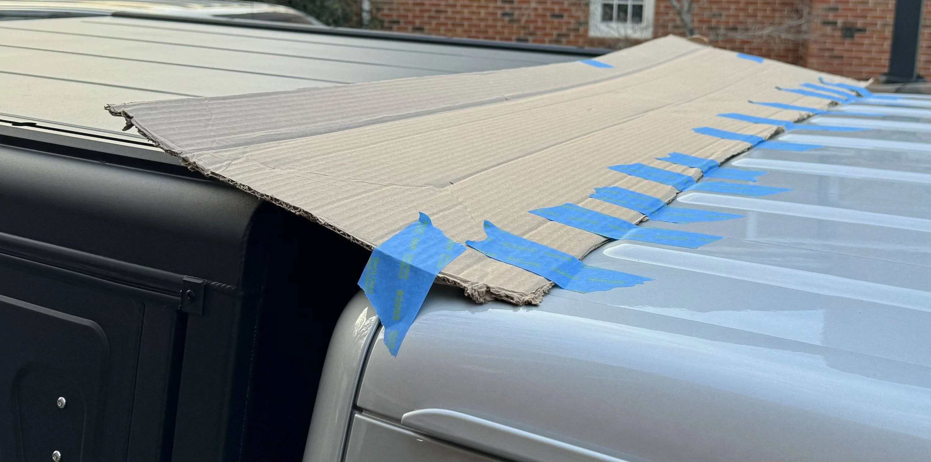

Cut a water weenie in half and put it between the cab and the bed. Make a highway run and see if it changes.

So I think you confirmed the issue. Now what to do about it?
Yeah, that's tough. I am extremely disappointed in the alucab right now. A lot of the images I see there's a massive rooftop tent spanning the void, so no wonder there's no issues. I've only had it for about a month, but I doubt there's any amount of refunding AVO will do if I want to swap for a smartcap (which I would honestly do at this point, having the bed cap stick up 3" above the roofline is absurd).
Now I am considering buying
The fairing seems too arched so I don't know if this will do. I might try the pool noodle suggested above and see if that helps at all.

Another option might be to put an aero load bar across the roof and mount it low, like a spoiler in front of the canopy leading edge.

Maybe something like this to get air over the topper?
JcrOffroad: JT Roof Rack | Jeep Gladiator (2020+)
I was thinking the same thing…. But with the rhino rack or front runner platforms…. Add some more utility. Not a huge fan of any racking system that mounts purely to the gutters, have yet to see one that mounts that way with a company willing to state a “dynamic” load rating…. Front runner and rhino are the only two I know of built well enough for solid claims. ???
