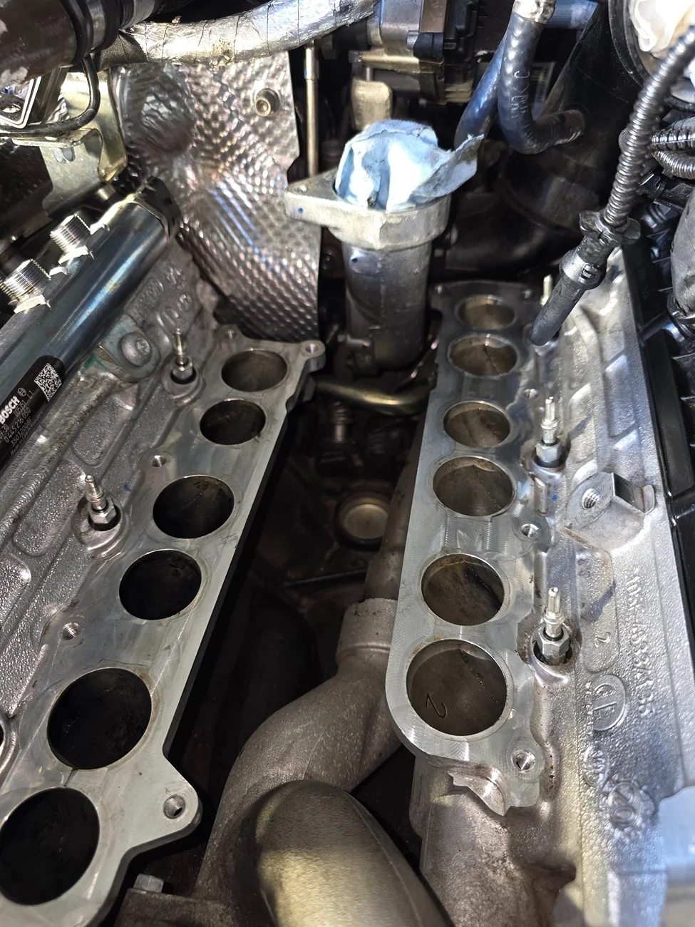

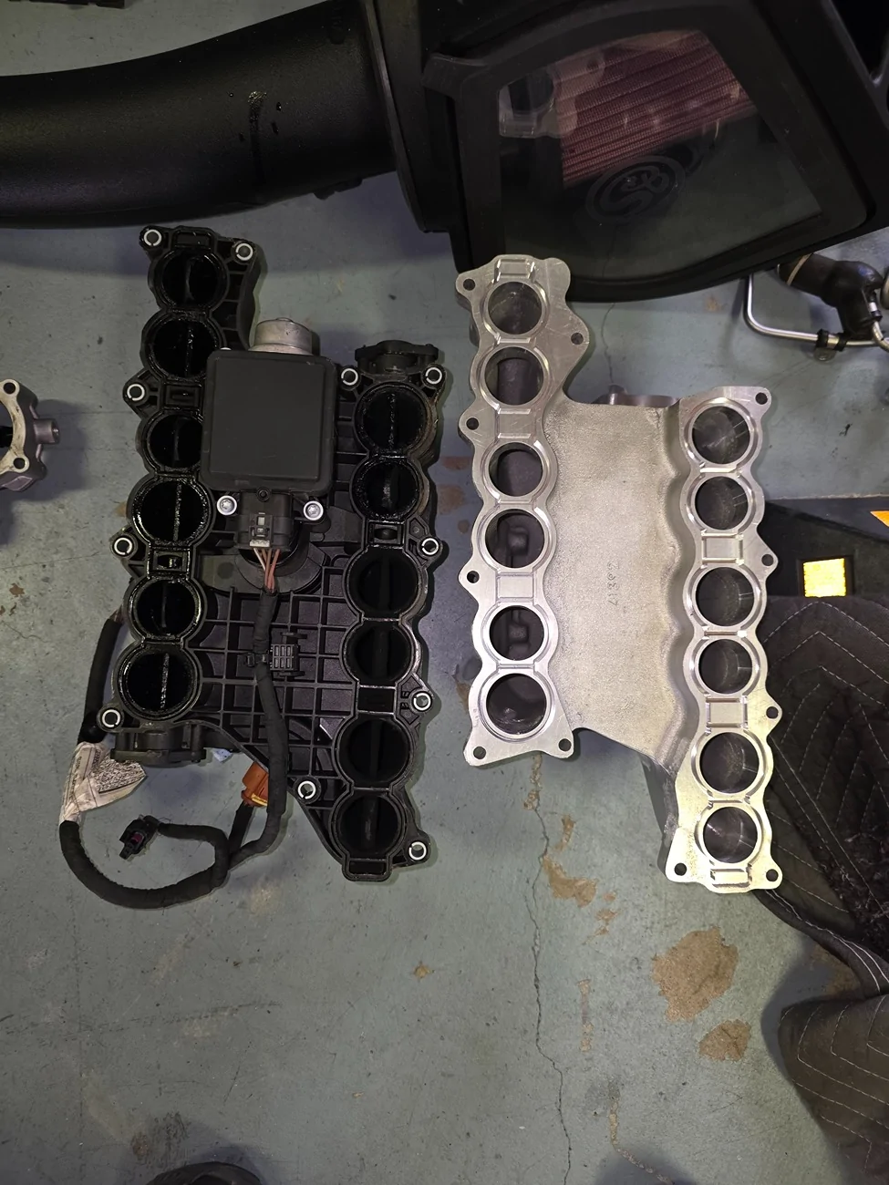

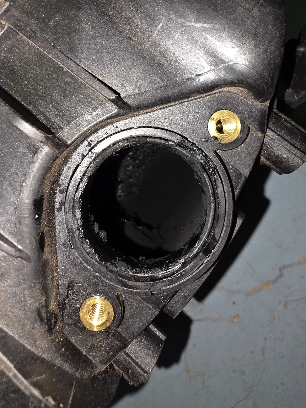

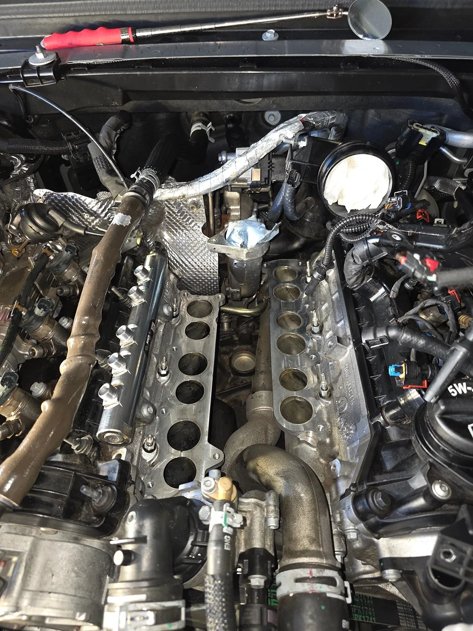

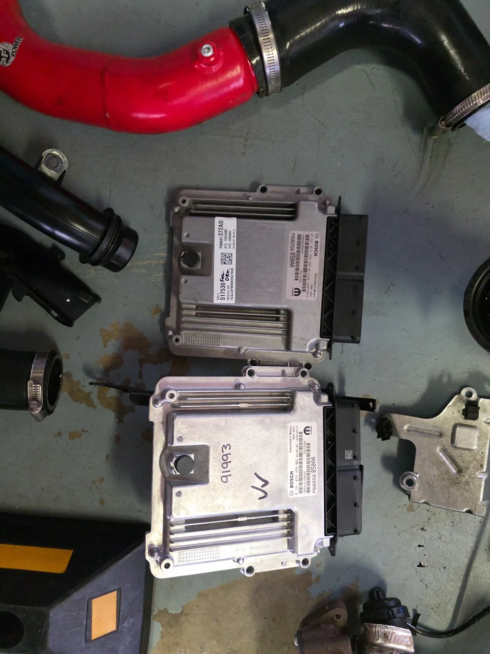

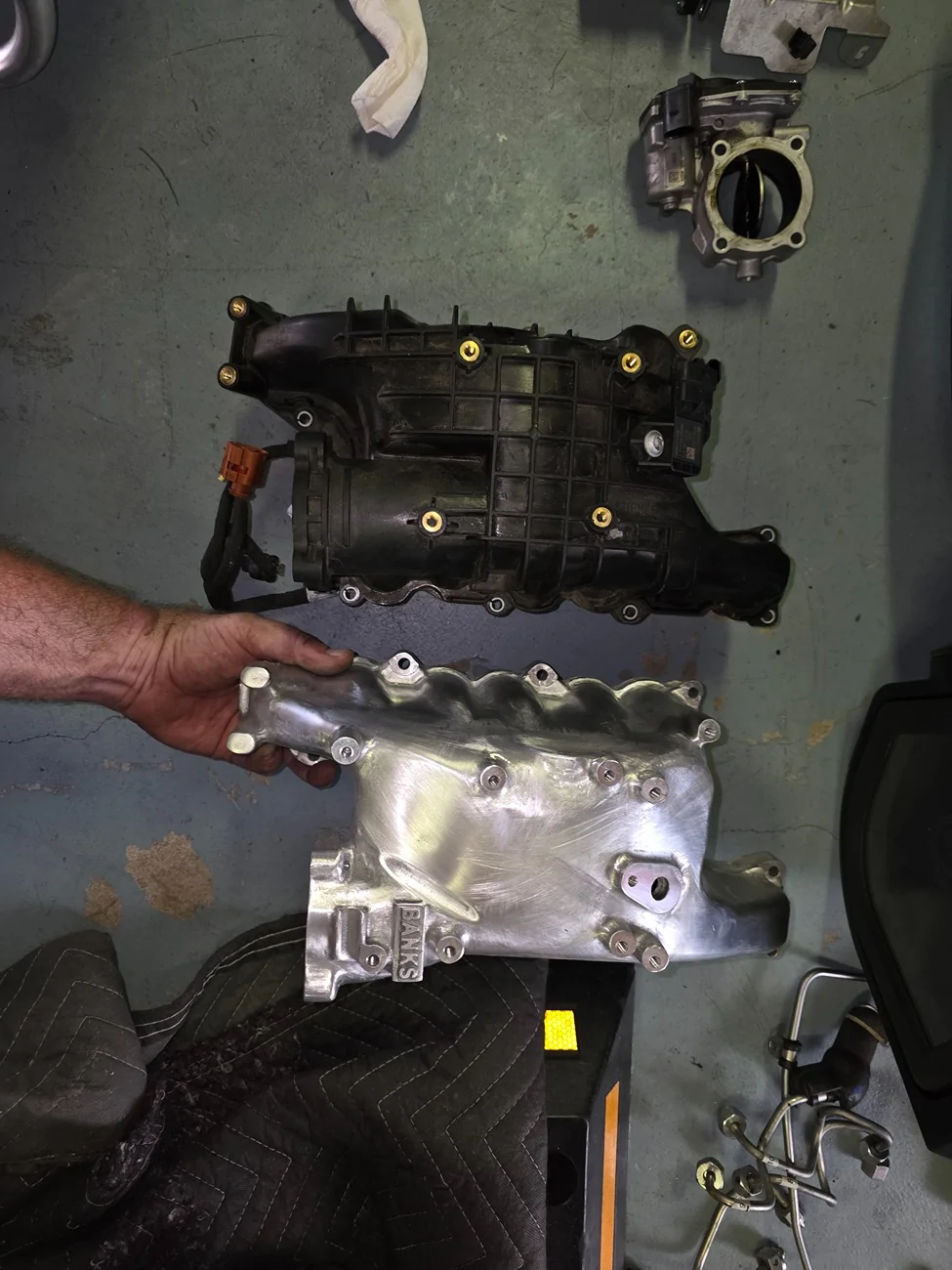

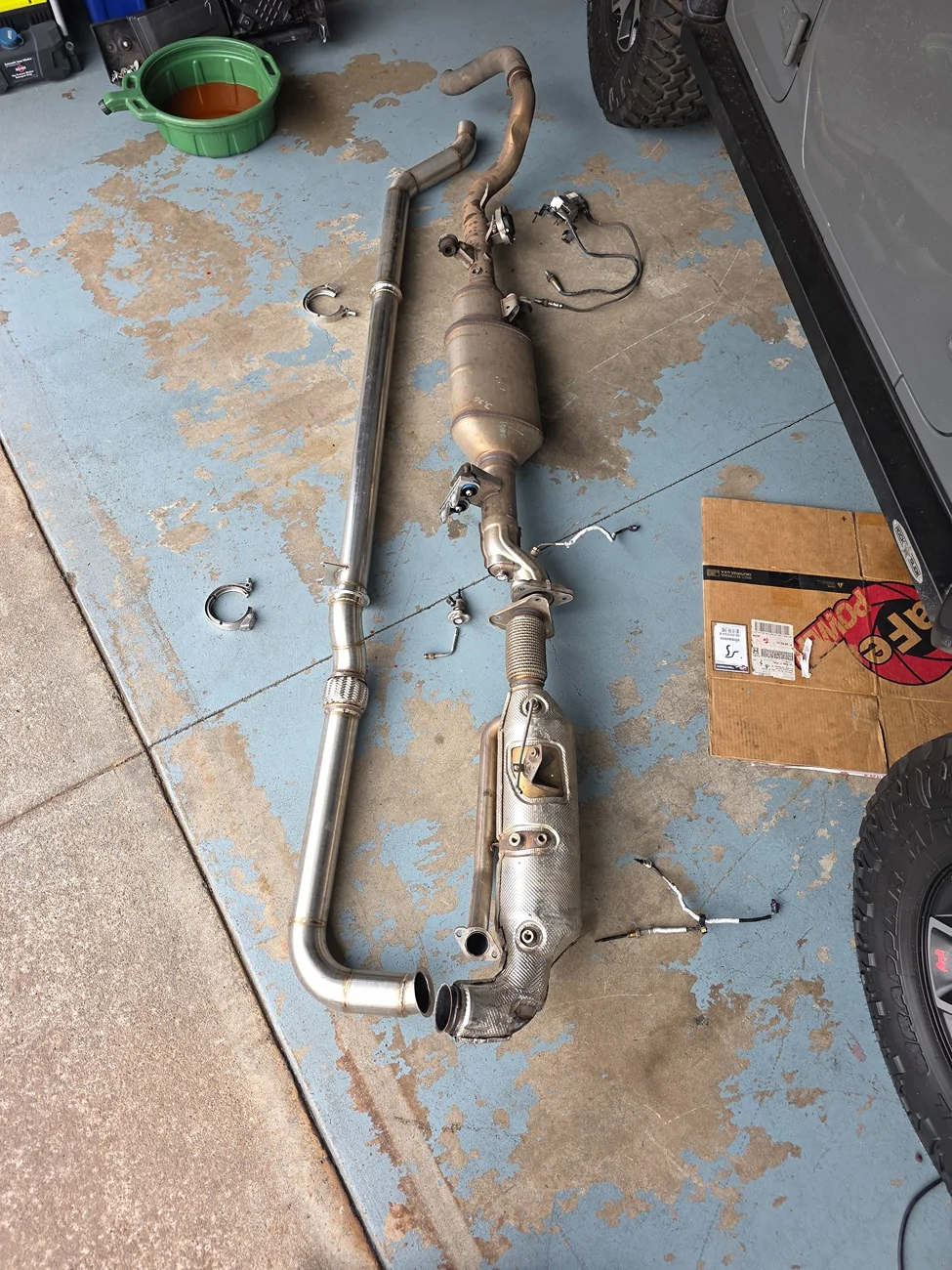

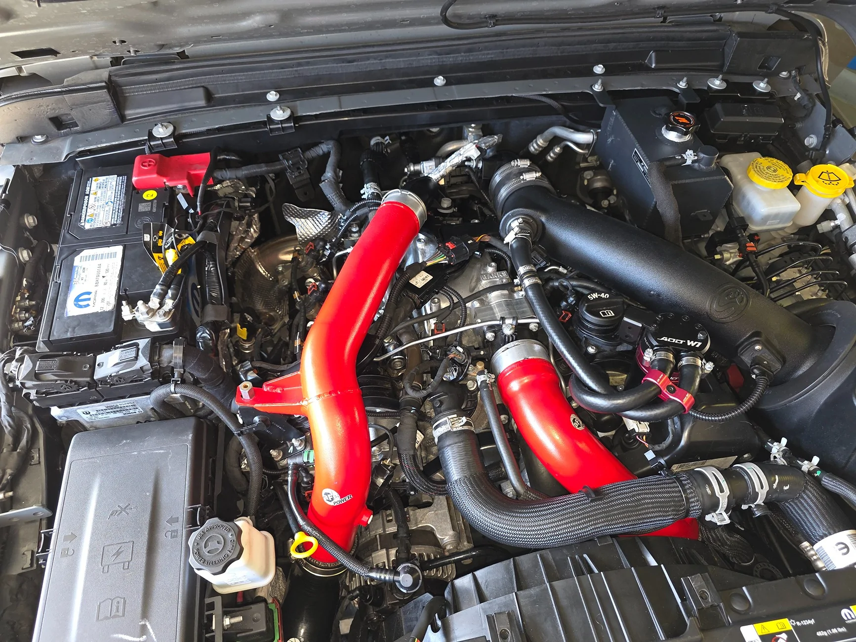

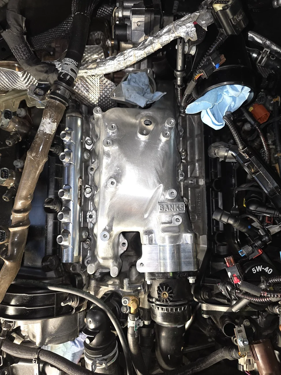

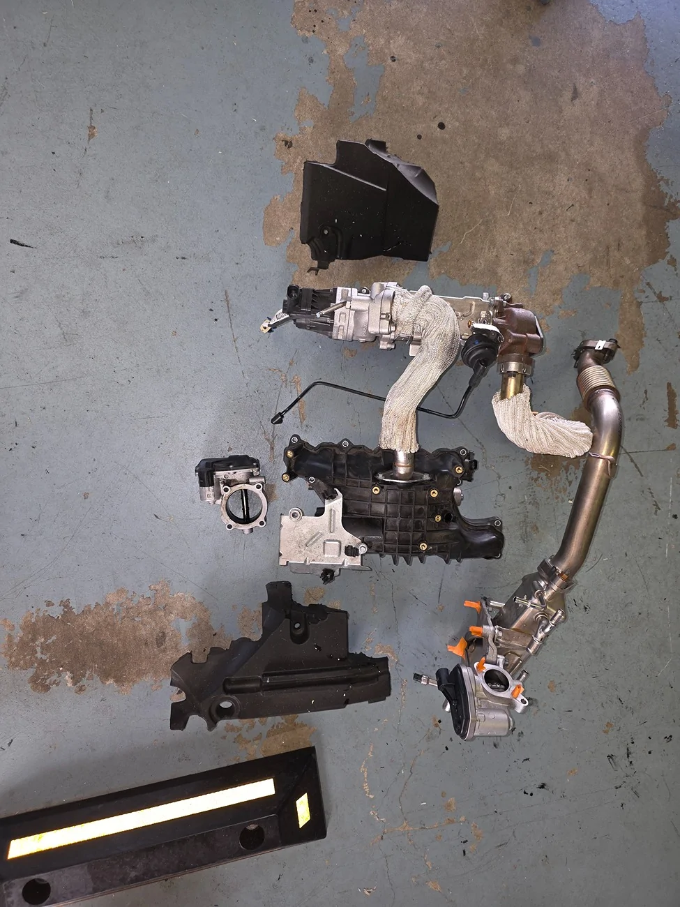

Folks, I have successfully deleted my Wrangler recently using Diesel Dudes tuned ECM and exhaust. I have also installed a Banks aluminum intake manifold with no issues on a 2021 3rd Gen by the way. I completely removed the DEF tank, EGR and EGR cooler, and exhaust. Took me about 2 1/2 days doing everything in my garage, no lift.
10 outta 10, luv it!
I think that Im gonna start gathering parts for my transformation. Found the intake for $800 last night, the throttle delete for $150ish, then all the other stuff is readily available... time to start collecting for the build. I should have bought the intake from Banks when I first saw it in 22 or 23...
Thanks for sharing!
