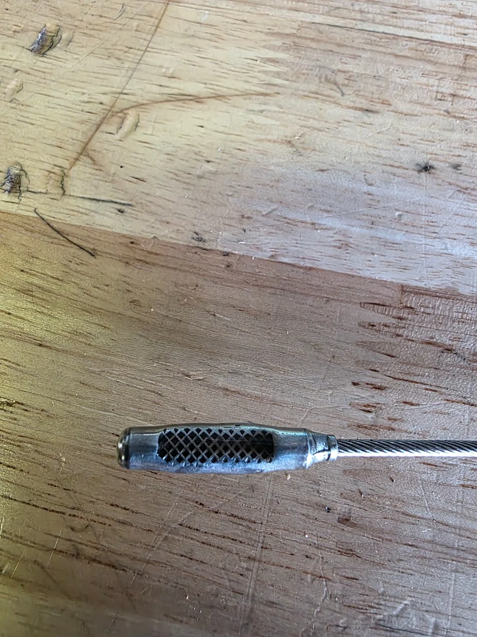

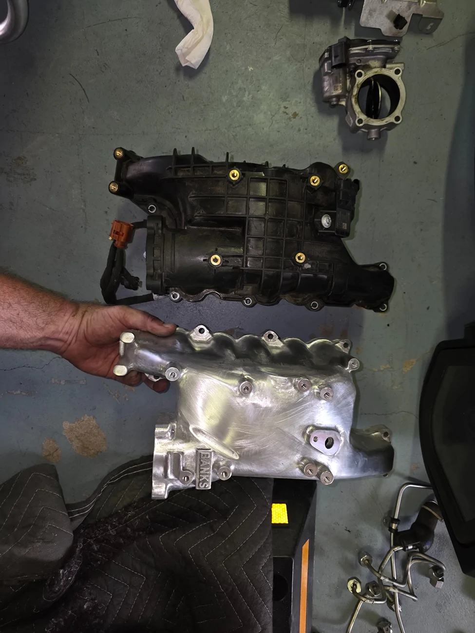

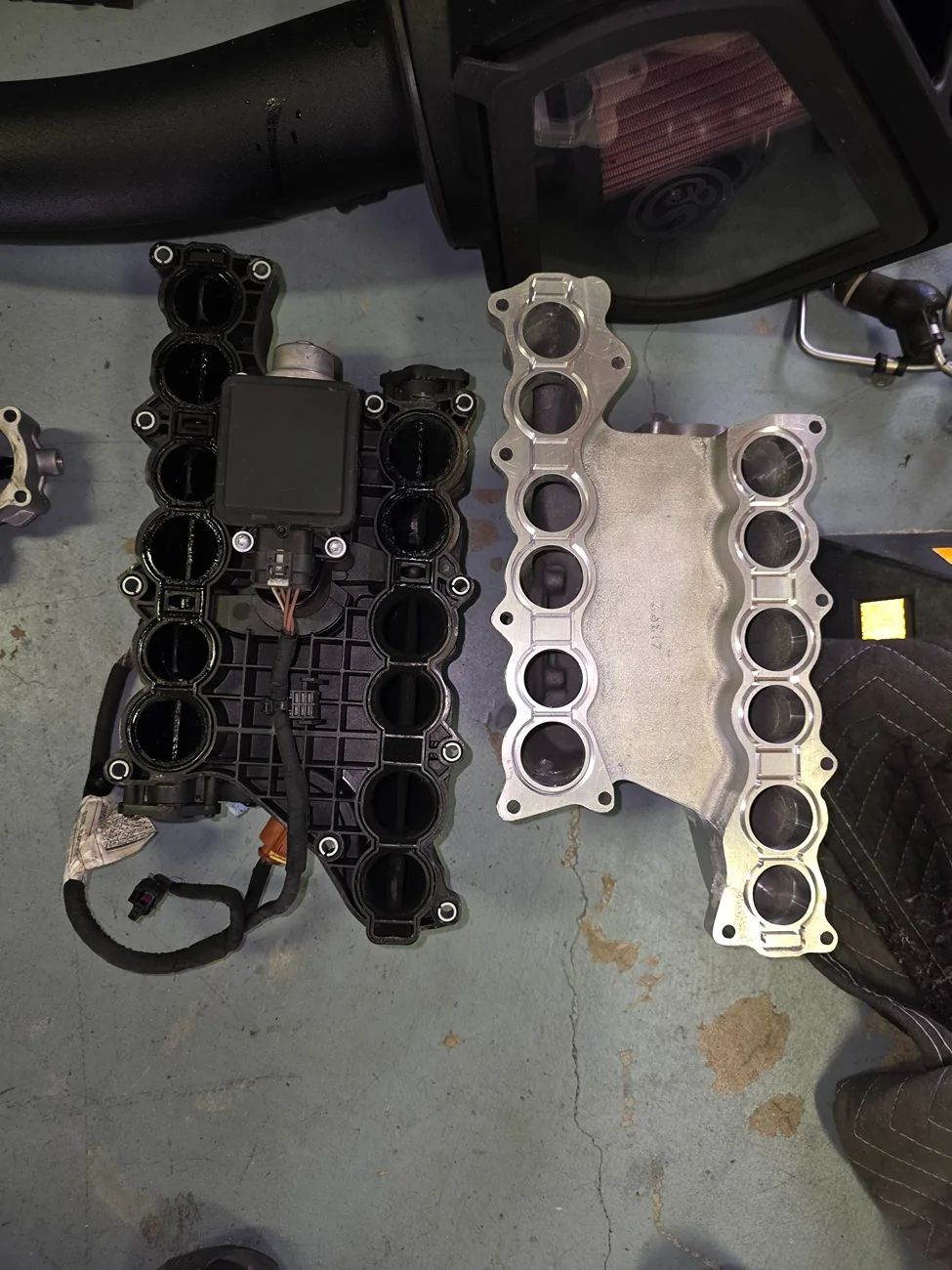

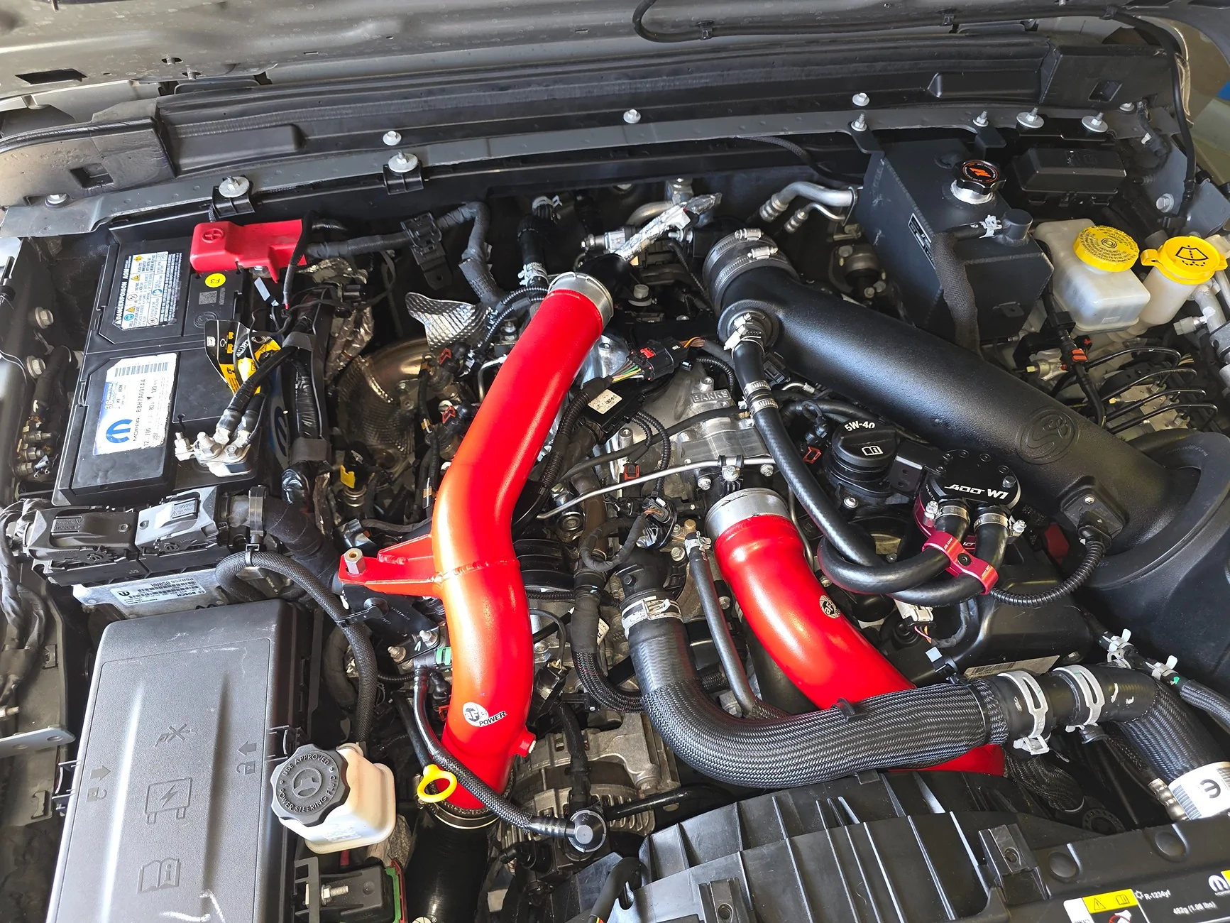

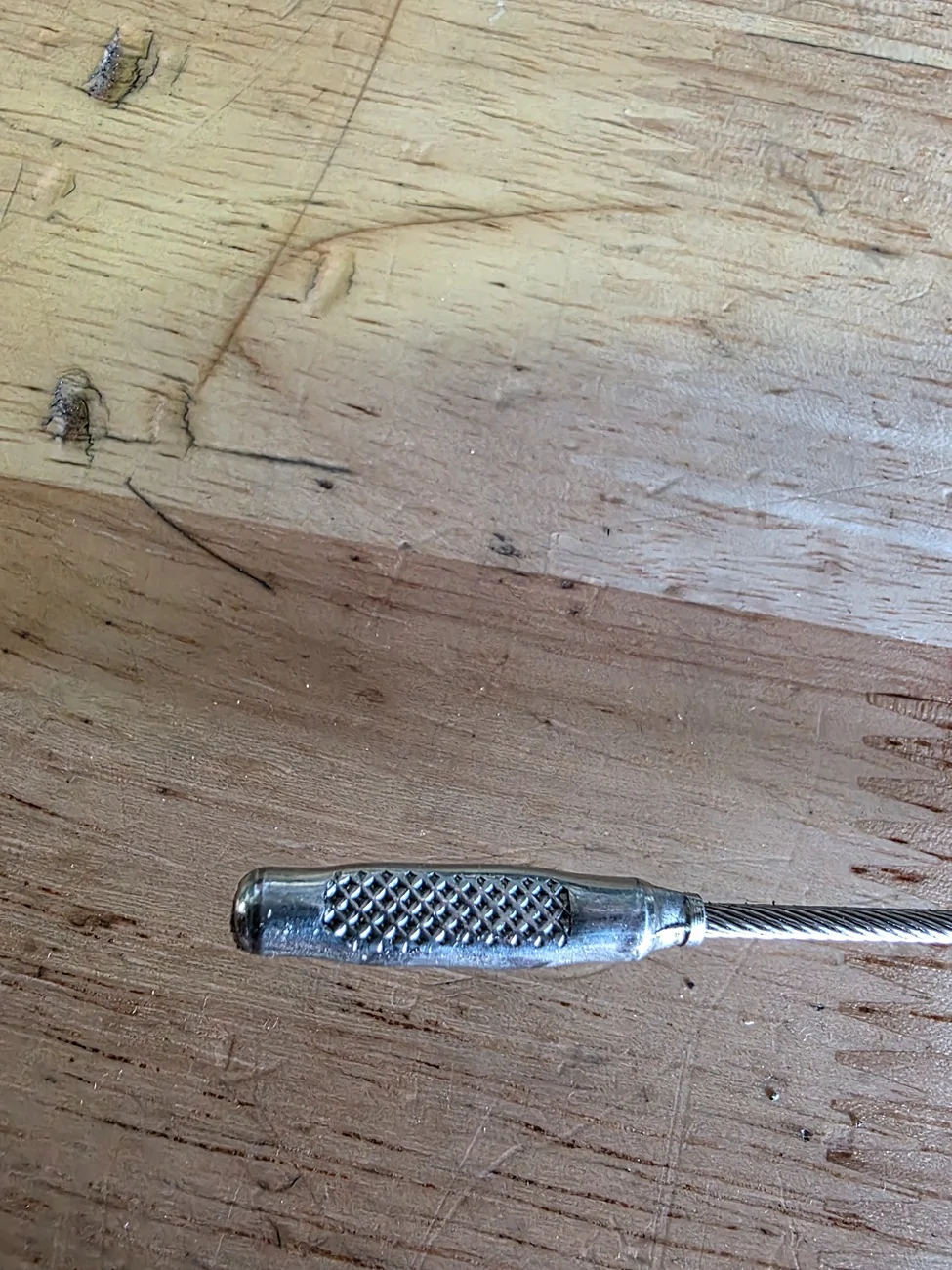

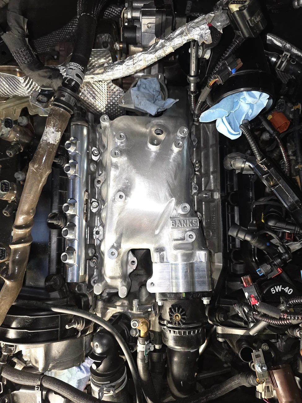

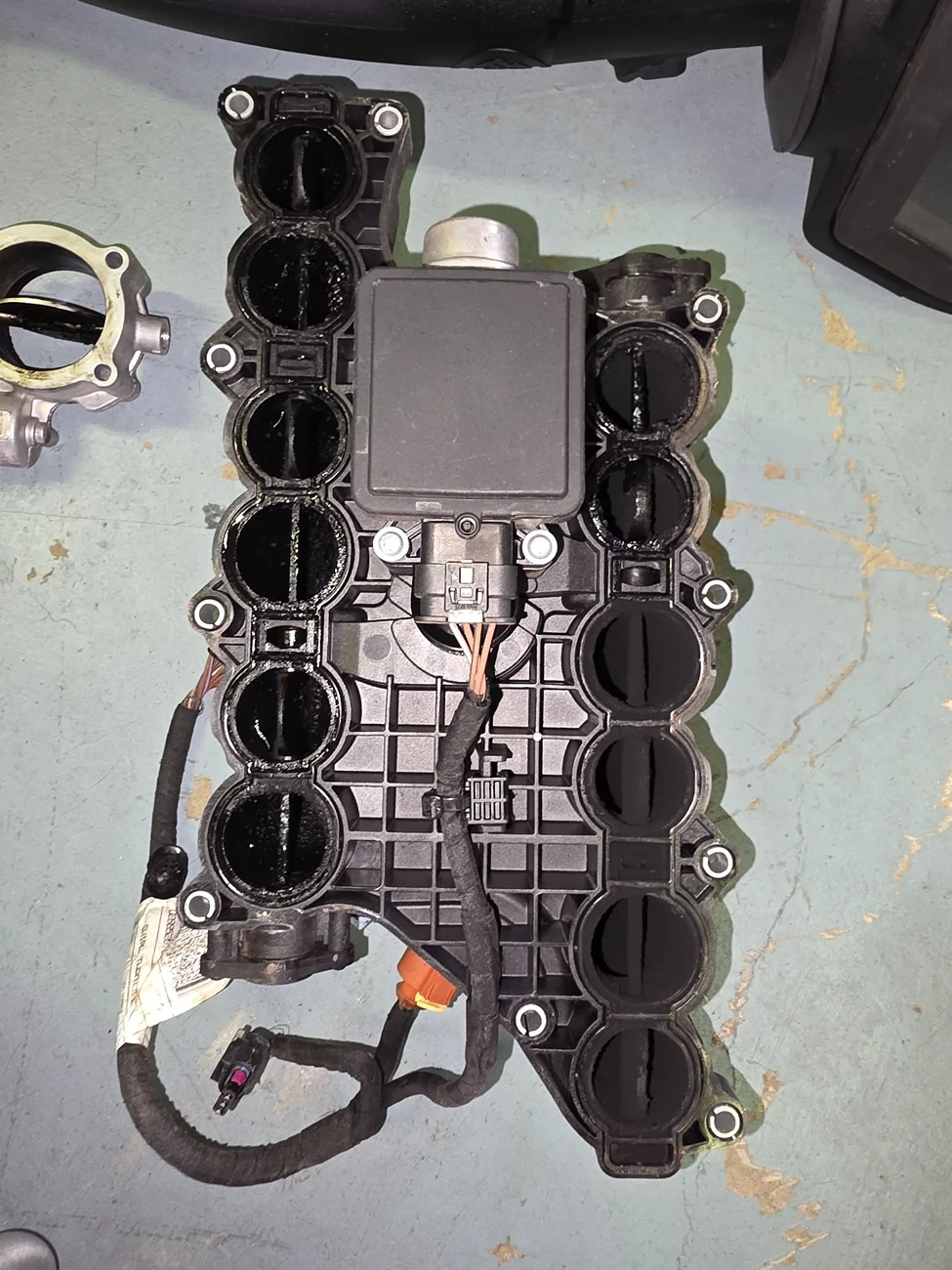

Well folks, I completely deleted my 2021 3rd Gen Ecodiesel Wrangler and added a Banks aluminum intake manifold, AFE charge pipes, S&B cold air intake, The Diesel Dudes tune and exhaust, and a few other goodies from Dirty Diesel. It is running great! But the oil change reveals how clean it runs now! WOW! Two photos, one with a clean dip stick and one after 200 miles cleaner than expected. Let me know what your thoughts are.

I’d say that’s pretty impressive!

Link to the Banks intake please?
I bought mine early last year and sat on it for a while until I had everything I needed. With that being said, I don't believe Banks is offering it anymore. You could always call them. I have seen some on Ebay for around $800.

You have an ADD W1 catch can? Doesn’t throw any codes/CEL for it? Could not get mine to not throw a code? Went with the EOC after messing with it for weeks.
I did at first but then adjusted the length of the hoses to make them as short as I could and I believe that helped adjust for pressure and or volume and it stopped.

No worries. Any questions you have along the way shoot them my way. The install isn't as bad as a lot of folks make it out to be. Take your time and be light handed with the plastic clips. Also, I recommend ordering new intake gaskets from your local parts store. OEM fits the Banks.
