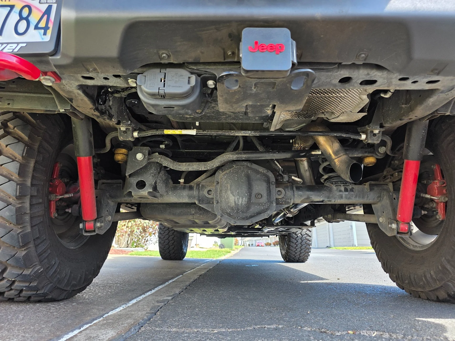

Nope left the cover off. I like to see everything. Good luck with your project! You won't be disappointed. I would not do business with EOC. I even removed the DEF tank. Weight and just one more thing to get hung up on the trails.
Thanks, I originally tried EOC because they are nearby and it would have been an easy trip to have them do it while visiting the in-laws in BC. I have since given up because they never returned my calls to schedule an appointment. It will be more fun doing it myself anyway (the wife keeps saying I would enjoy doing it myself rather than letting someone else do it). I do have the EOC catch can though and that will be it from them.
Good you pulled the DEF tank, same thing I will do when the time comes.

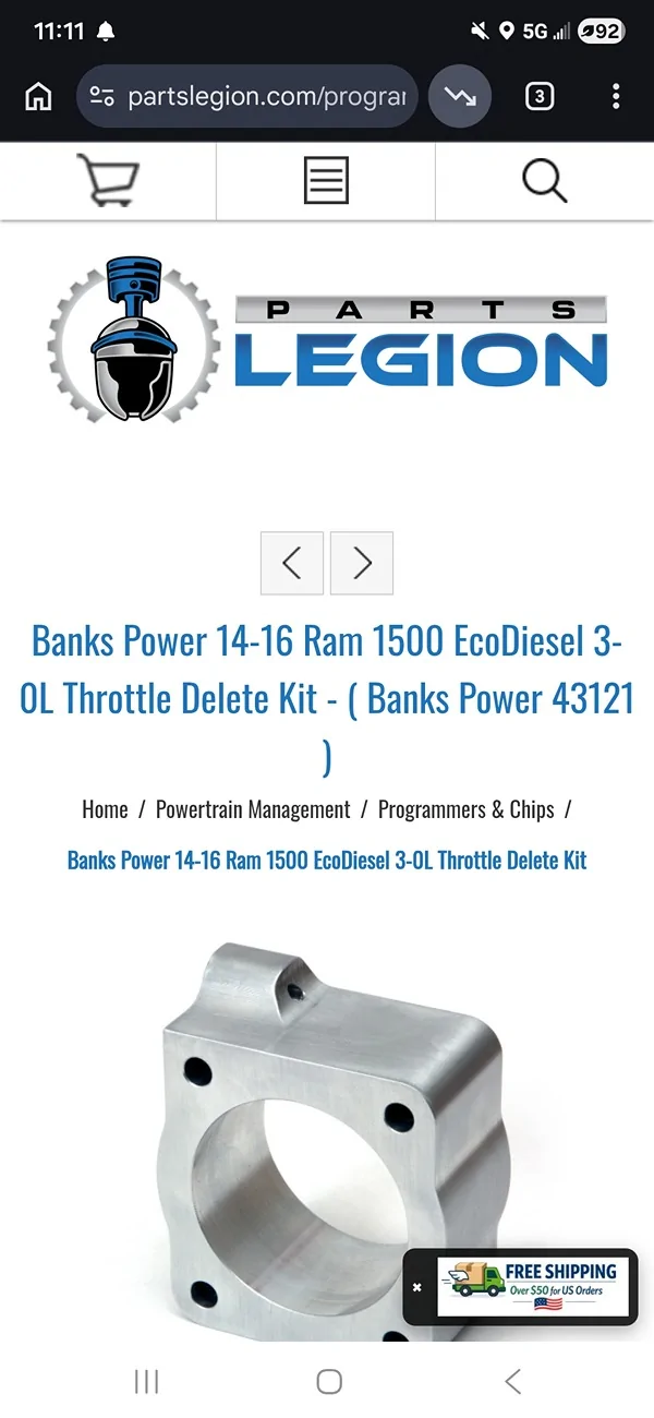

@nate10
I have the intake manifold coming. Does the air inlet butterfly delete come with it? If not included can the stock one be used? I have removed the butterfly. Having trouble finding the
Banks Power 14-16 Ram 1500 EcoDiesel 3.0L Throttle Delete Kit - 43121
nate10
Nate
Jan 13, 2026
44
96
Hawaii
2021 Wrangler Ecodiesel
Military
@nate10
I would think you could use the factory unit with the butterfly removed and any penatrations filled or plugged. Of course not plugged in either. Another option would be to have a machine shop mil you one up from billet.
