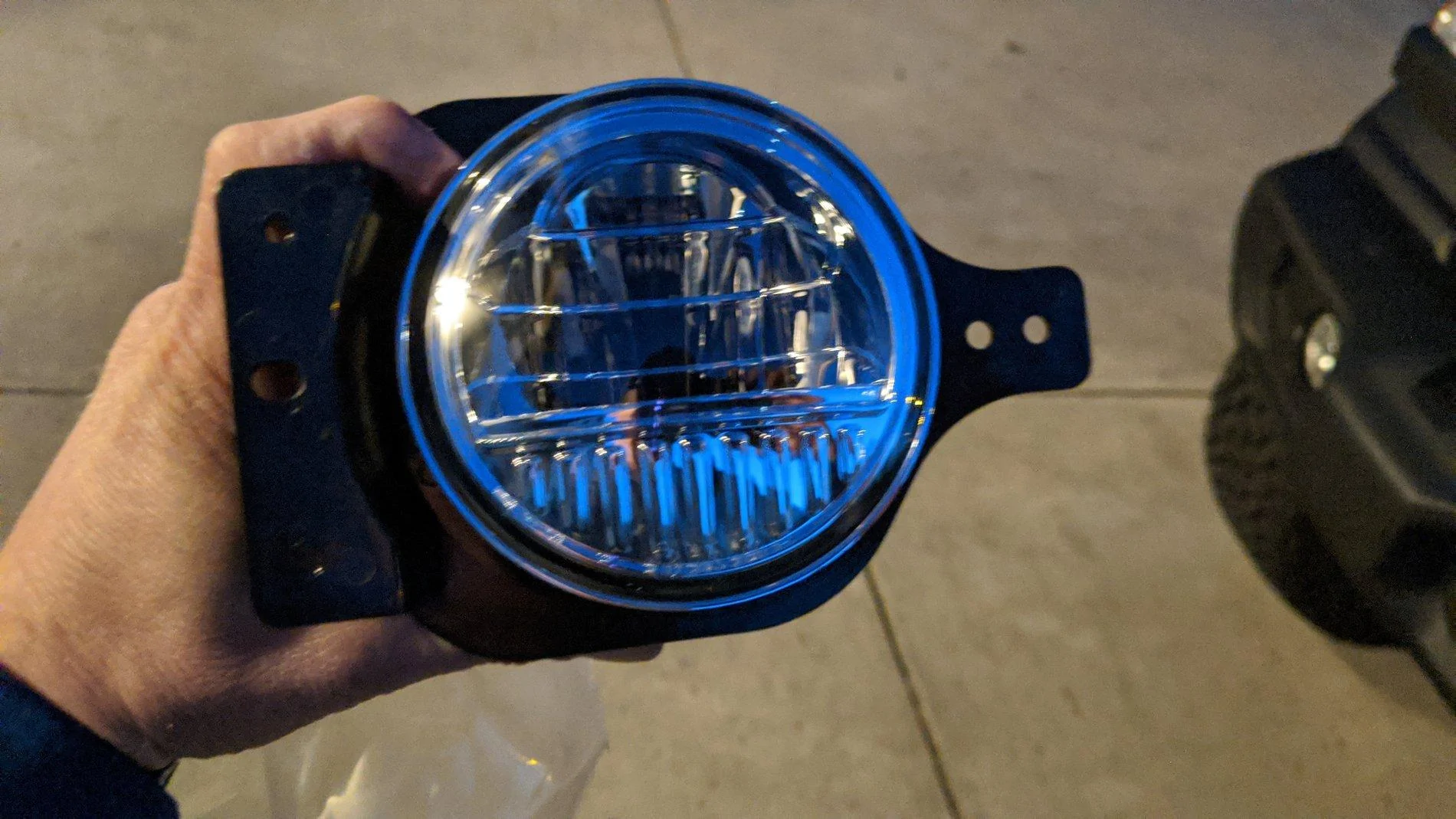

I got these from a company I used to deal with back a few years ago, loyo. I got them when I ordered Halo Headlights and Foglights for my buddies JL. Total shipped for everything was $170 and that included my foglights and the retro fit bracket for the JL so he could install the 7" headlights. My portion was $30. I'll have them installed tonight. They look like this.

look nice.post some pics after install.
