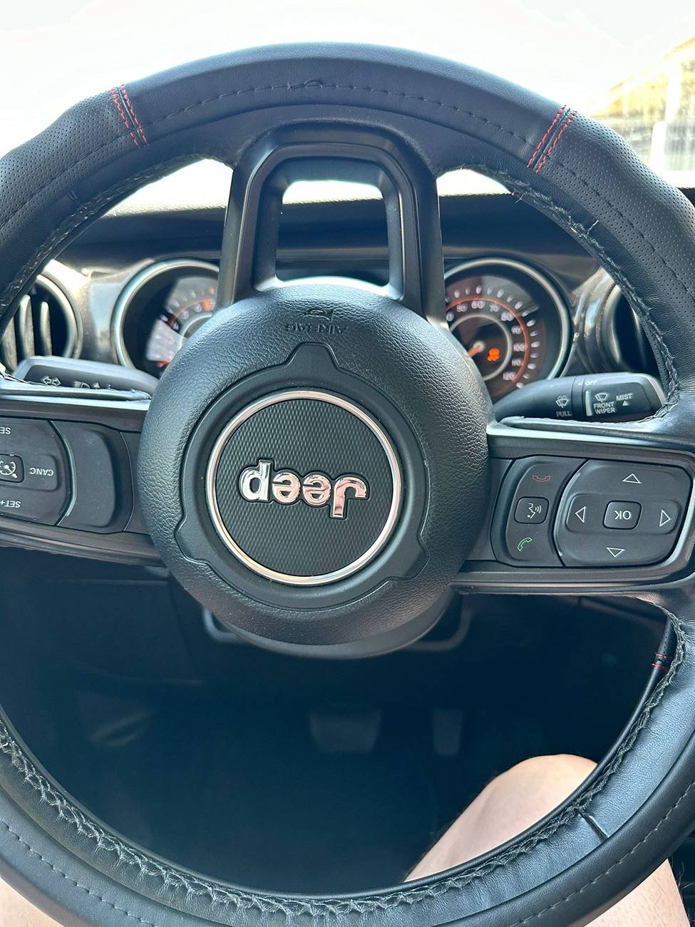

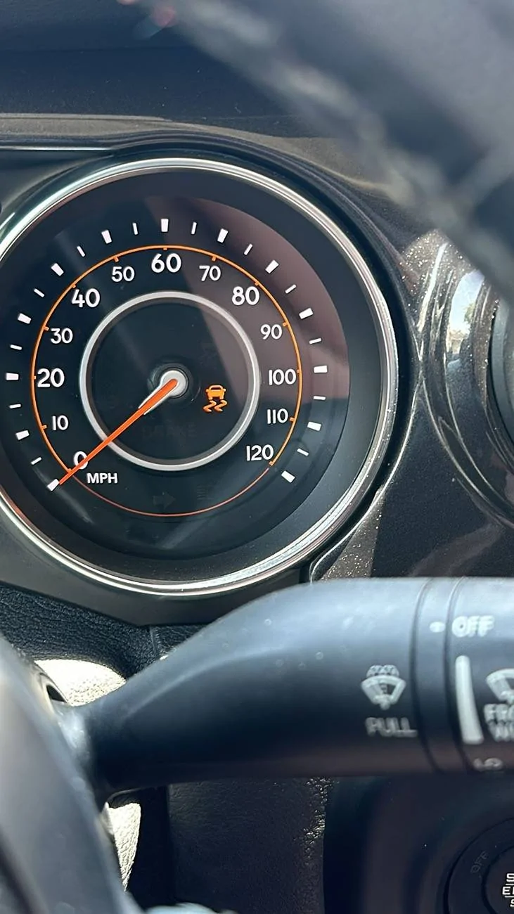

Hi I am new to the group, and not long ago I acquired a 2021 Gladiator 3.6L
The thing is that a few days ago, I probably hit a curve, and the ESC control light went on; not only that but my steering wheel is upside down (but the tires are straight) and the turns are off, it doesn’t make the turns as it supposed to do. The off road setting says that my steering wheel is about 12° to the left, even though the steering wheel looks like is at 0°.
Do u guys know if it’s something that I can repair by myself, or I have to take it to the shop?

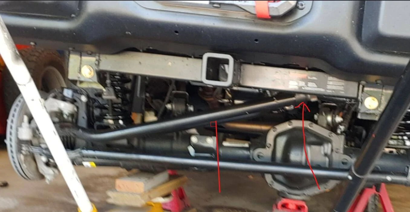

Steering wheel over 180 degrees off while going straight is a damaged part - hit something hard enough to cause something to bend or jump threads (such as the adjustable drag link) Sensors are correct - it's messed up! LOL
this adjustment area on this bar - drag link - is where I'd start looking. COULD be tie rod - the one that goes from left wheel to right wheel, but I'd bet more on the drag link from the pitman arm of the steering sector over to the right steering knuckle.

There's no threads to "jump" on the pitman arm or pitman shaft. That's a tapers, splined joint. The only way that's coming loose is if someone somewhere along the line left that nut loose, re-used an original nut or failed to put loctite on the original nut (new ones come with thread locker in them)
Properly set, those tapers, splined joints take an act of congress and some military action to get them loose. Much much much stronger chance of the drag link being bent or that clamp not holding and the threads got shoved in. (as my photo points to)
As the drag link as some less than straight shape to it from the factory, it might not be easy for a novice to see a bend that doesn't belong, or a bend that has been increased by force.
