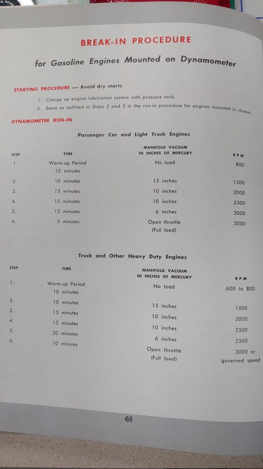

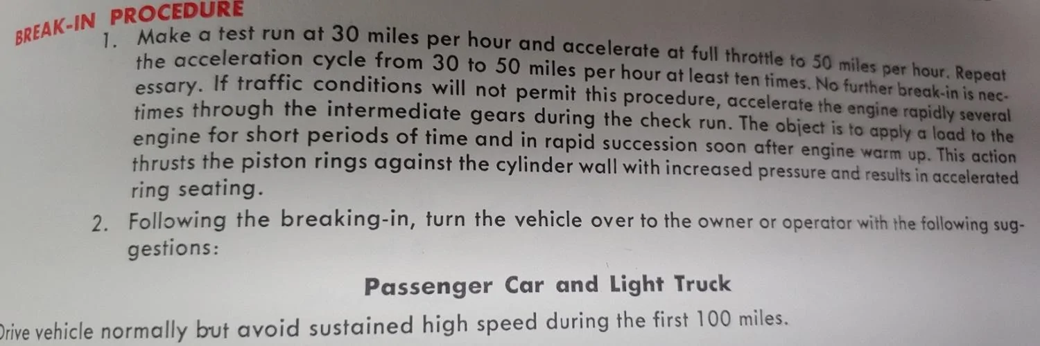

There is only one way to properly break in an engine and to see how its done, watch airplane (piston) engine break in videos, and you'll get an idea how a piston engine is SUPPOSED to be broken in.
Basically, after the engine is rebuilt and re installed, the airplane gets pushed to the runway, once they get clearance, they start the engine, smash the throttle and take off.
That's it!
The idea is to load the piston rings and to keep the walls from glazing.
Any other fluff is completely wrong and is only put there to keep engine manufacturers from getting sued.
To translate that into cars (and motorcycles), you have to find space to very the rpm and load(!) by accelerating and decelerating up and down, up and down to about 75% of redline, in lower gears as much as possible.
The enemy of a new engine is the freeway and constant rpm. This is what you must avoid at all costs if you plan on keeping your Jeep for a long time.
I have done this to every car and motorcycle I have ever owned, and it works wonders.
251
40,651
54,401
Actually, it's the other way around. Break in oil does not have any additives. Just oil.
Wrong- break in oil is simply the oil that's put in at the factory. It's GOT to have the protection of any oil. Additives are what make it protect - anti-foam, corrosion inhibiters, etc.
It used to be the OLD TIMERS would use non-detergent oil for break-in. That's since been shown to be problematic.
I've built many engines, and some of my friends have built many many dozens - same oil goes in that will be used later.
If you want proof I'll post from an SAE engineer on the topic.
Frankly, there is NO SUCH THING as break-in oil. It is simply what the first oil is. I used the exact same oil I was always going to run on every single engine I have ever built, including that engine in my SX4 now that has 33,500 on it since my rebuild.
I've been building engines for all sorts of purposes since the early 1970s. Cars, trucks, motorcycles, even go-karts and lawn mowers - don't forget tractors.
If you put in oil that doesn't have the same protection you expect down the line, you can mess up an engine really fast.
251
40,651
54,401
That's it!
Looks like I need to post the bits from my college engine books, and from Perfect Circle on engine break-in.........

Vary the speed as much as possible at first, no UNLOADED high RPM. Heavy acceleration a few times - with a load - don't let it downshift and wind up tight, but don't lug it.
The book is way over-kill, IMO. Varying the speed and load is where I've had great luck.
I build the engine, get everything just right (where you can set timing and carburetor, etc.) check for leaks, check fluids and pressure, and drive it.
The idea is that loading flexes things, wears off the high spots of rings and cylinder walls, bearings and crank journals.
Jeep Gladiator Engine Break In Procedure? engine-break-in_car
Jeep Gladiator Engine Break In Procedure? gas-dyno-break-in
