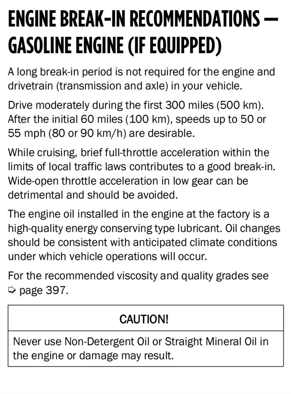

All personal opinions aside, it's in the manual.. doesn't sound like the OP violated any recommendations in the manual. For others, no, low gear full throttle is not recommended and advised against explicitly. Full throttle from higher gears though, is recommended, so the details matter, at least in regard to OE recommendations.
It's your vehicle though, everyone drives theirs differently so I'm sure break in is a fairly forgiving period as long as you're reasonable.
Also, no recommendations for early oil changes, rather to follow the same guidelines as all other oil changes. I have no doubt that'll remain a widely contested thing.
I personally drive it casually for the first 500ish miles and gave it a couple good highway pulls after reaching temp. The truck has treated me well, not burning any oil and can easily get 18-20mpg in the summer on 35s.
Enjoy the truck
Enjoy the truck
