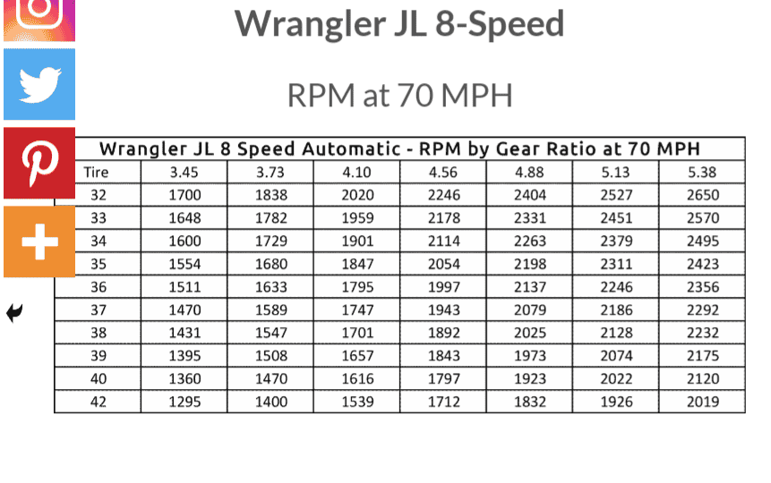

My goal is to stop it gear hunting 7th-8th at 50mph and higher. Yes, re-gearing will make the intermediate gears shorter and I don't need or want that. If the shift from 8th to 7th was more seamless, I would be okay with it downshifting like an automatic is meant to do. But, unlike all the other downshifts, 8 to 7 is not seamless. I'll be on the gas pretty hard trying to maintain speed in 8th. When it finally downshifts to 7th, that much pedal makes it accelerate vs maintaining the same speed. If I could reprogram the transmission, I'd do that instead (but I still think it could use 4.56 vs the factory 4.10).

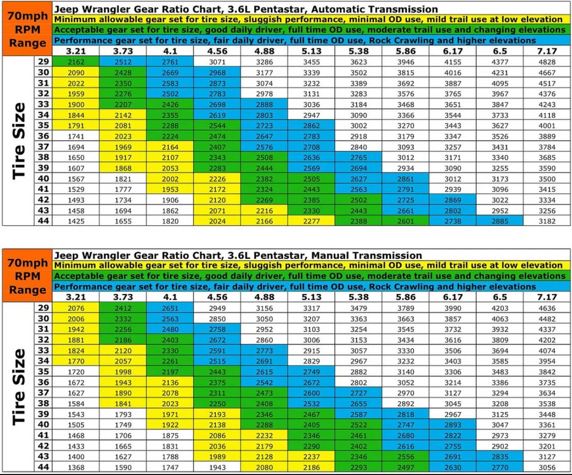

I signed up today to get 4.56 gears installed. It'll be a few weeks before they get to me. It'll put me at >2000rpm from 63mph on up and will run 2550rpm@80mph.

Jeep does put factory 4.88s in the JL Rubicon with the Manual transmission and 33” tires. My wife has that combo in her JLU and it‘s awesome. I wish the Gladiators had a similar factory option. I will say she complained a bit about the really low 1st gear initially, but got used to it. I love driving it and wish they had a factory 4.88 option in the Gladiator.(I have the stock 4.10s in my Mojave)

Thanks for the reply. If the manual is awesome with 4.88 then the automatic should be awesome with 4.56. I hope so because I just had it done yesterday. I have 500 miles of easy driving before I can get on the interstate at the speeds I normally travel to really test it out.
MT high gear is 0.72. AT high gear is 0.67. Equivalent differential gearing for AT would be 4.88*0.67/0.72 = 4.54 so 4.56 is right on the money.
