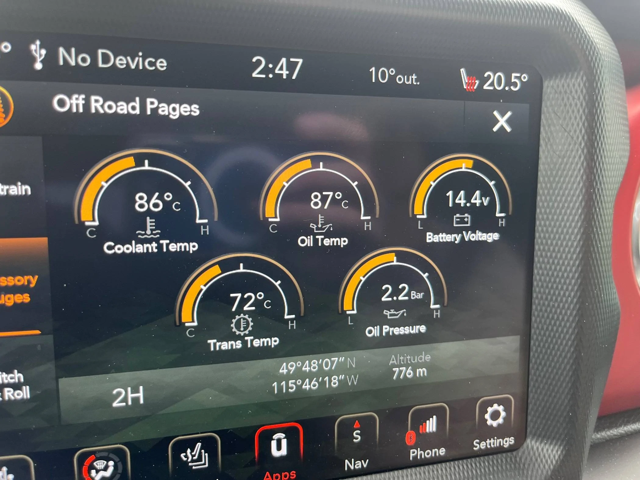

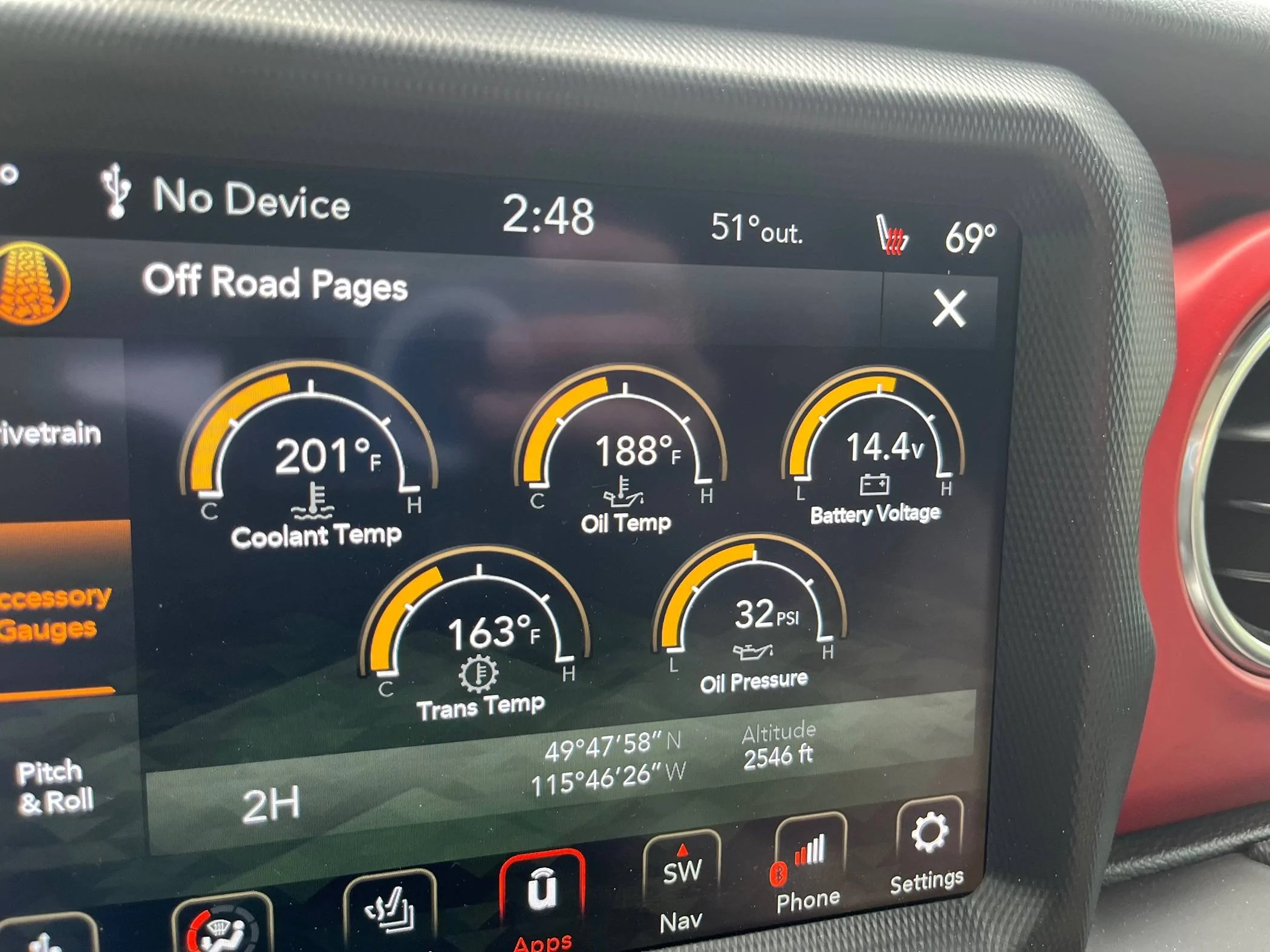

I’d be a bit worried if I saw this, and in fact I did see this temp right after I picked up my truck from having the second engine put in and the oil filled was extremely over full by 7L. I didn’t check the level but trusted it was good. My immediate trip was 1500 kms and on my way back I saw that temperature and called the dealership. The service manager wasn’t alarmed by that temp and I carried on the highway and got home and did an oil changed to see all that oil in there.
Now, I don’t pull a trailer but can get loaded down with stuff and go on long trips of a 1000-2000 kms and I’ve never seen those temps except what I just mentioned.
We just did a road trip to BC and the photo is typically the range my engine stays in. It can get hotter but nowhere close to 235.
Want to try an experiment? Turn your heat and air completely off and drive around town. Watch your heat reach 222 degrees in traffic. If traffic is moving too much for that then just pull into a parking lot and let the truck idle for a bit. It’ll reach 222 then the fan will kick on. Then take it somewhere with a good length incline (leave air completely off) and watch the temp rise to the 230s. What you see might surprise you.
Around town with ac blowing at all coolant temp won’t get much over 205.

Furthermore, when someone says “designed to run hot” they may be referencing the fact that the electric fan doesn’t even kick on until 222 degrees and doesn’t reach max speed until the low 230 degrees. At least that’s what I’ve experienced through paying attention. So if that’s where the engineers set the thresholds then that’s how they designed it. (Running AC changes this fact because running AC forces the fan on no matter the temperature of coolant)
235 scared the hell out of me too. Still not used to it.
