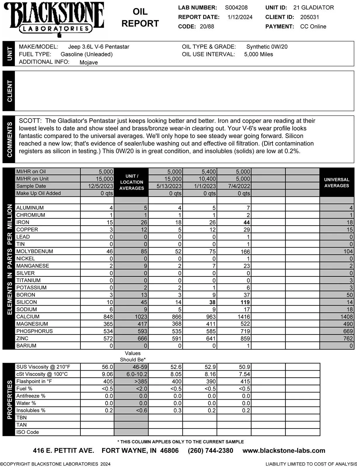

I would highly recommend getting an oil analysis done. There is quite a bit of ticking to these engines sometimes that have nothing to do with the valvetrain like injectors, exhaust manifold leaks and even the EGR valve sometimes.
I have an oil test kit ready for the next time i change my oil. It is still a few thousand miles out, but I may go ahead and do it this weekend.
250
40,617
54,335
You can take it for a drive, get everything up to operating temperature, then draw oil out the dipstick tube like I do for "in between" testing or when I don't feel like grabbing it from down below.
I use my brake bleeding tools to pull oil out the dipstick tube.
They can also tell me if I'm ok running another 2 or 3 thousand miles on the oil.
