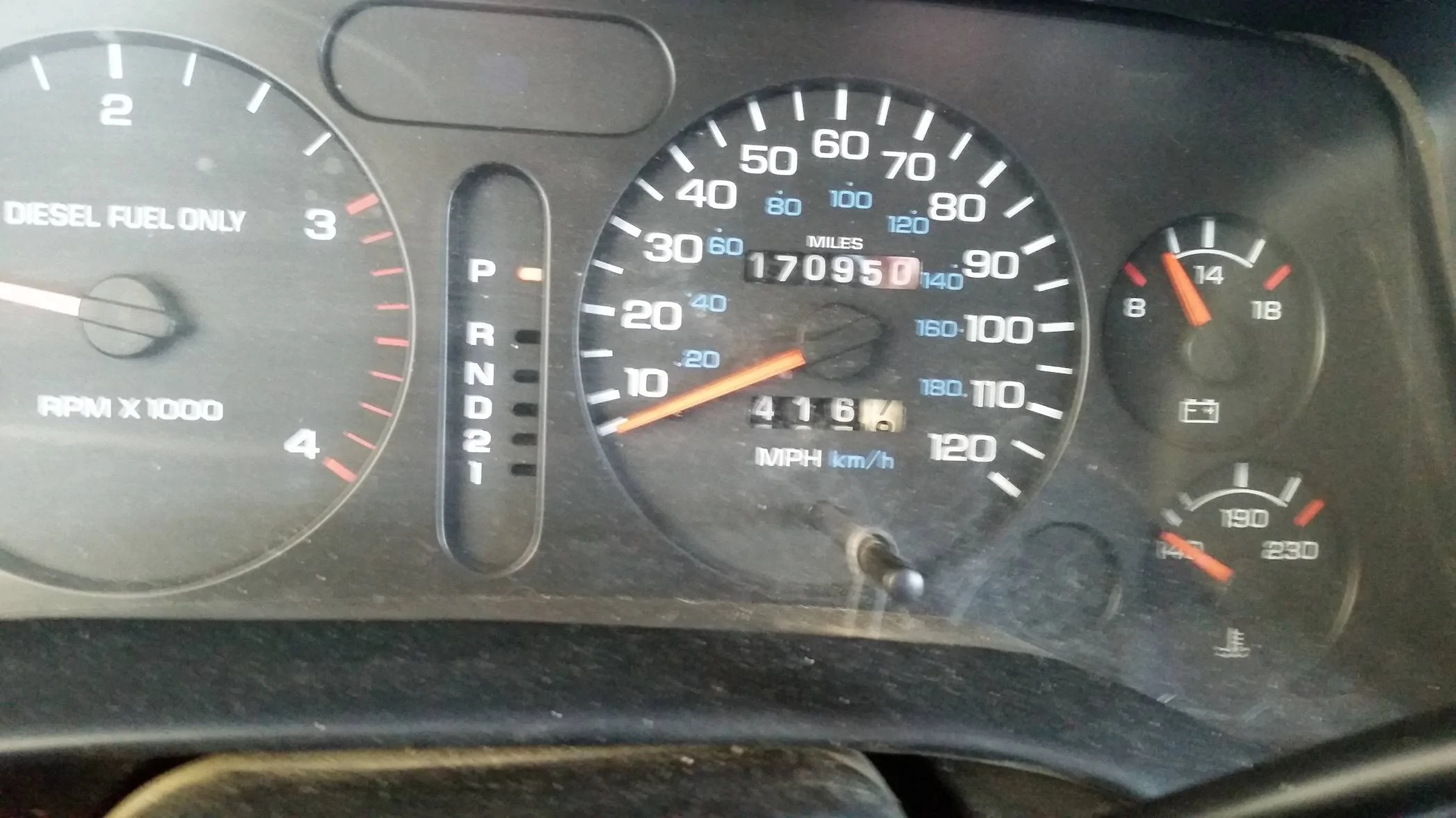

But the Gladiator doesn't even show 230 as a max temp in the red. Anybody who owns one knows that.
I’m not sure where the confusion is here. I don’t think we are following each other for whatever reason so I’ll clear it up.
I know what the temp gauge says in a Gladiator
I know what a temp gauge says in a Ram 1500
The confusion with me started because you made a statement about a truck that was actually about a model different than a gladiator. That wasn’t made clear in the post.
We good. Not sure why this is a big deal.
The way you wrote it could easily be interpreted as YOUR personal limit, not the vehicles.
Remember, no one can tell the tone of your post, so you have to help everyone out by making that part clear.
It's a very common problem with texts, or emails etc.
We only get the words, not the facial expressions, or the tone of voice.
