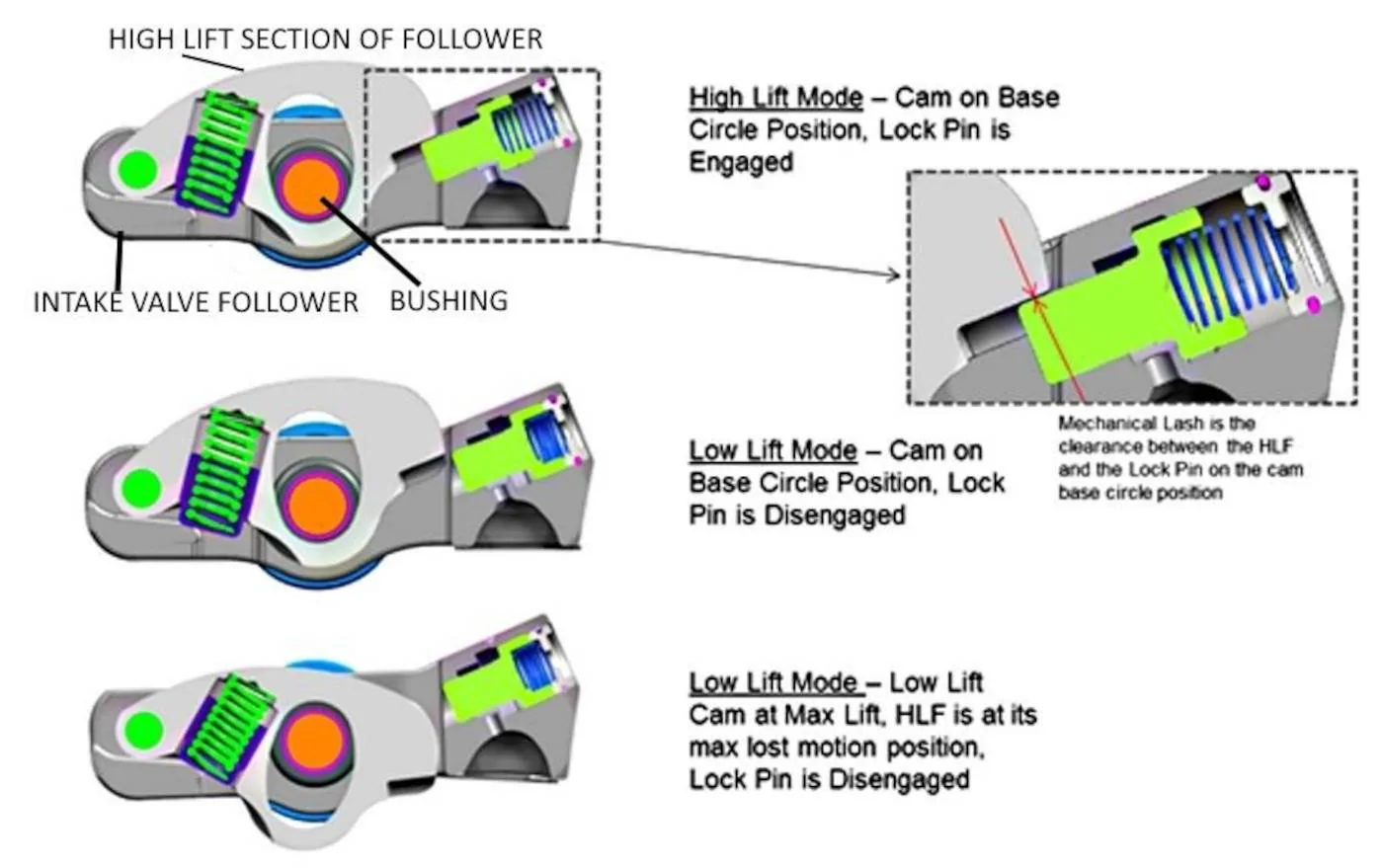

The ticking is all over the place - some hear a ticking and are really bothered - while it may be the injectors, or normal 3.6 valve train sounds.
Others it's something totally different and of no consequence other than annoying them.
Still others - it's an actual concern.
So when people talk of the 3.6 ticking - who knows what they are talking about or referring to as some of them don't.
I have posted a video of my 4.0 here a couple of times - and what the phone picks up is mostly injectors, with some valve train. A problem in that case? Not at all.
Some of the ticking some may be hearing is the high lift part of the follower making sounds as it rides the high lift cam profile, held there by only some spring pressure. There's no real pressure against the cam at idle. There has to be clearance inside that follower so that it can seamlessly move into and out of high lift mode when called for.
By nature of its design it may not be a quiet design. There's actually mechanical lash in high lift mode - wonder how the lash adjusters don't take that out??
I'm into my high lift operation a lot around here with the hills and wind so my next oil analysis will be interesting - if there's no abnormal results, that and the fact mine has the exact same tick as every single 3.6 PUG we've ever owned, I won't worry about it.
What I believe I'm hearing on mine is actually injectors - so I'll figure out what a member here used for fuel additives and see if that quiets them a bit.

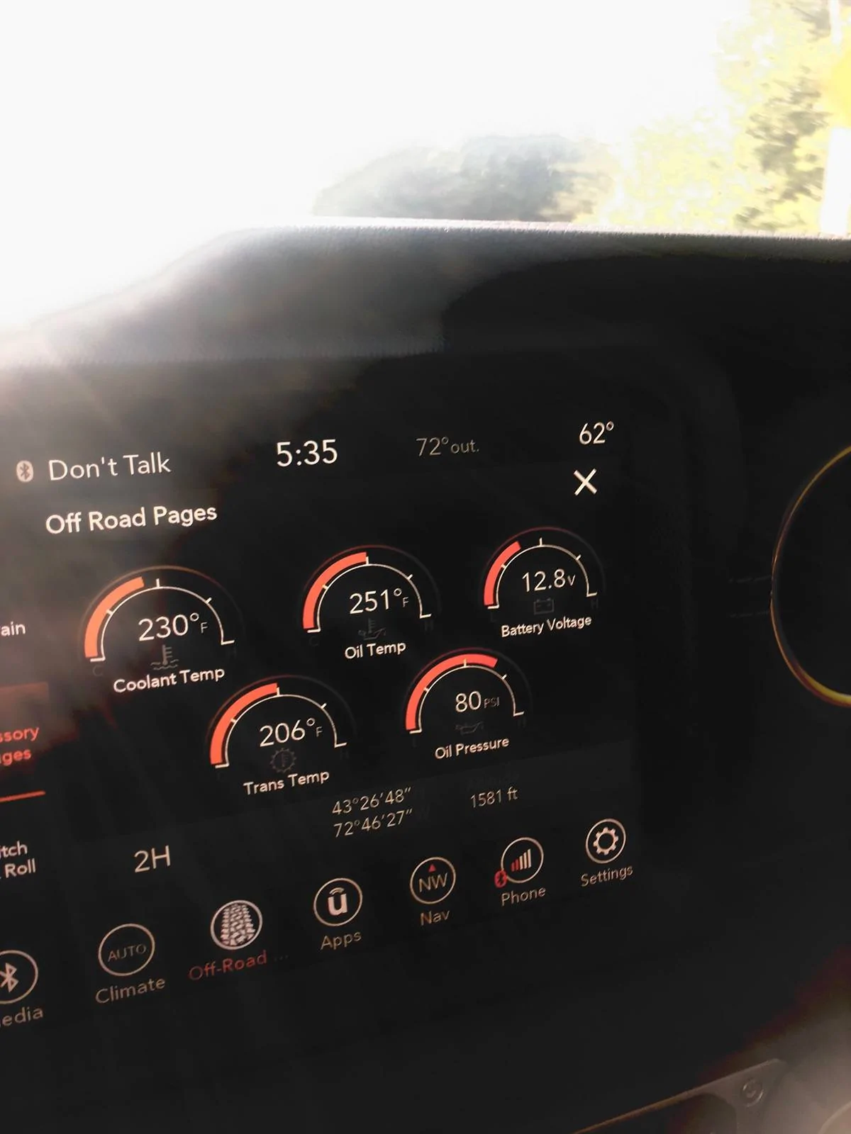

troverman
Mar 31, 2023
114
84
NH
2022 Jeep Gladiator
Jeep Gladiator Engine issues 3.6L 50B158A2-275F-4564-86A1-DD1F32518E30
Pretty routine on mine if you tow anything much. You can see I’m not at altitude nor is the ambient temp very hot. I’ve actually seen 240 coolant which just plain seems too hot for the engine to last if you keep doing this.
250
40,617
54,335
You leave out what you are towing, the weight, the frontage, wind speed, your road speed and so on.
I tow and don't see 230 temps and it's hilly and windy here - a calm day is rare, and we say "not windy" when it's 10 mph. If you are driving into 10 mph wind it's almost as if you added 10 miles an hour to your road speed as far as drag on the vehicle and item being towed.
Your oil pressure is up so obviously you are in a gear running 3,000 RPM or higher - so there's more to that picture puzzle that isn't being seen/shown. Is it a manual, or automatic? Are you manually shifting (if automatic) or letting it shift?
I can't recall ever seeing such temperatures towing 5,000 pounds at 65 mph.
If you go faster than that, there's part of your problem right there.
And if it's a camper with large frontage, that doesn't help any, regardless of the weight of the camper.
troverman
Mar 31, 2023
114
84
NH
2022 Jeep Gladiator
Box trailer, 5000lbs. Automatic transmission, not in manual mode. 55mph, basically calm wind conditions. Everything within spec.
If your at 80psi oil pressure your on the highway or stuck in a low gear really revving on it . Highway ?
