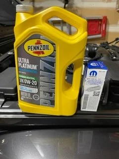

Ok, got it done today and wow, probably the cleanest oil change I've ever done.
