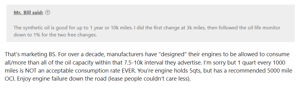

The synthetic oil is good for up to 1 year or 10k miles. I did the first change at 3k miles, then followed the oil life monitor down to 1% for the two free changes.
That's marketing BS. For over a decade, manufacturers have "designed" their engines to be allowed to consume all/more than all of the oil capacity within that 7.5-10k interval they advertise. I'm sorry but 1 quart every 1000 miles is NOT an acceptable consumption rate EVER. You're engine holds 5qts, but has a recommended 5000 mile OCI. Enjoy engine failure down the road (lease people couldn't care less).

Sorry, that 10K miles is not marketing BS. Modern synthetics can go that long with no issues. At least the quality oils can. I've gone many times over 7,000 miles and results come back "you could have gone farther". Oil chemistry and viscosity was fine, and wear metals not a problem.
Correct, and NO reason to not. I've gone over 7,000 on more than one occasion - the test results always come back "you could have gone longer". And hey - never lost an engine. Been at this since the 1970s, tons of experience building and repairing many hundreds of cars, lost track of all of the engines I've built and rebuilt over the decades. People who freak out over going more than 5,000 miles - it's a hoot, really.
