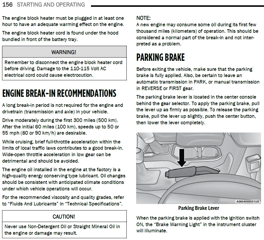

Someone needs to mention what's in the book, so here it is...
The oil & filter change advice shown in two different versions of the Jeep owner's manual (OM), or "the book", is summarized in Motor Oil & Oil Filter Service Intervals. The range in the book is between 4,000 miles for severe duty and 10,000 miles for normal driving ("daily driver"), not to exceed one year or 350 hours. In the book, there is no mention of early oil changes for engine break-in. See "Engine Break-in Advice from the Owner's Manual" below.
The most common mileage service interval that I've seen, for a mixed-use vehicle that is taken off-road or used for towing, is 5,000 miles. For a daily driver, the most common recommendation I've seen is 7,500 miles (or earlier if indicated by the OCIS). There are some owners who change the oil & filter at 50% oil life remaining as indicated by the OCIS.
Or, you can skip the details and just use the Oil Change Indicator System (OCIS). It tells you when to change the oil & filter regardless of the type of driving.
  1. Drive moderately for the first 300 miles.
  2. After the first 60 miles, speeds up to 50 or 55 mph are desirable.
  3. While cruising, brief full-throttle acceleration...contributes to a good break-in.
  4. Wide-open throttle acceleration in low gear can be detrimental and should be avoided.
Source: Page 156 of the online version of the 2020 Gladiator owner's manual, downloaded in April 2025.
