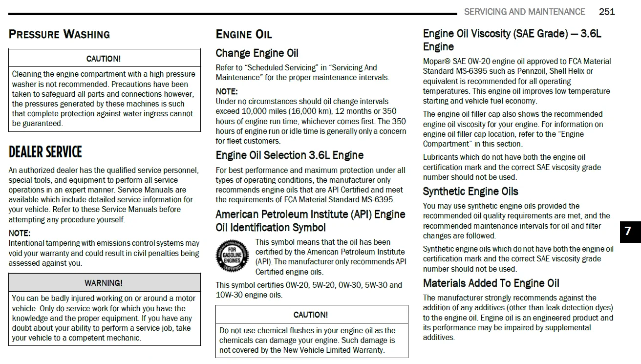

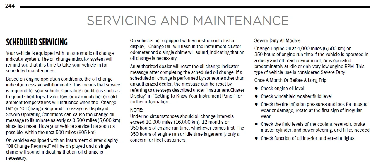

This is a good place for this reminder.
Motor Oil & Oil Filter Service Intervals
Recommended manufacturer specifications: Material standard MS-6395, API Certified, and SAE 0W-20
- Many mixed-use (off-road & daily driver) Gladiator owners change the oil & filter at 5,000 mi or 1 year, whichever comes first
- A good interval for a daily driver is 7,500 mi or 1 year, whichever comes first
- Always change both motor oil and oil filter (as noted on p. 252 below)
1. Under Any Conditions
- Change oil & filter within 500 mi after Oil Change Indicator System message illuminates (no grace period after 500 mi / 500 mi is the grace period)
- Triggered as early as 3,500 mi
- Never more than 1 year or 350 hours, whichever comes first
- In case the Oil Change Indicator System malfunctions (stranger things have happened), follow the limits for Severe Duty or Normal Driving
2. Severe Duty
- Limit of 4K mi, 1 year, or 350 hours, whichever comes first
3. Normal Driving
- Limit of 10K mi, 1 year, or 350 hours, whichever comes first
Viscosity grade: One of the revisions to the 2020 Jeep Gladiator owner's manual, in the online version, is that five API Certified motor oil grades are listed. However, SAE 0W-20 is recommended in the next paragraph on the same page (p. 251, below).
- For an analysis of motor oil viscosity grades, see Motor Oil Compiance Funnel
Engine break-in: If you have a new Gladiator, also see Engine Break-in Advice from the Owner's Manual
From 2020 Jeep Gladiator Owner's Manual, 2nd Edition (published in 2019)

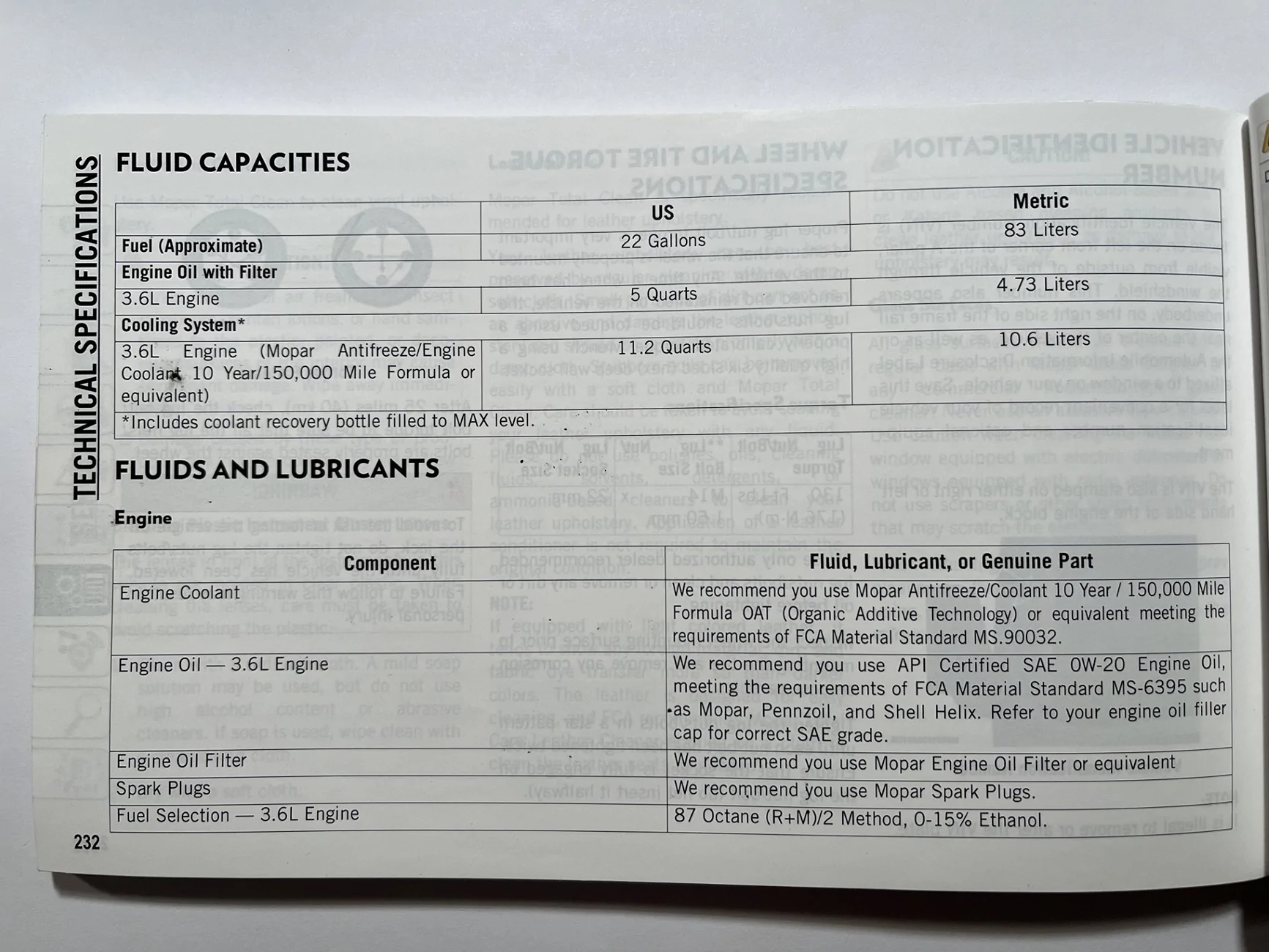

Jeep Gladiator Engine Oil Change Indicator System - how does it calculate remaining oil life? 2020 Jeep Gladiator Owner's Manual 2nd Edition p. 196
Jeep Gladiator Engine Oil Change Indicator System - how does it calculate remaining oil life? 2020 Jeep Gladiator Owner's Manual 2nd Edition p. 232
From 2020 Jeep Gladiator Owner's Manual, online version (downloaded on April 16, 2025)
