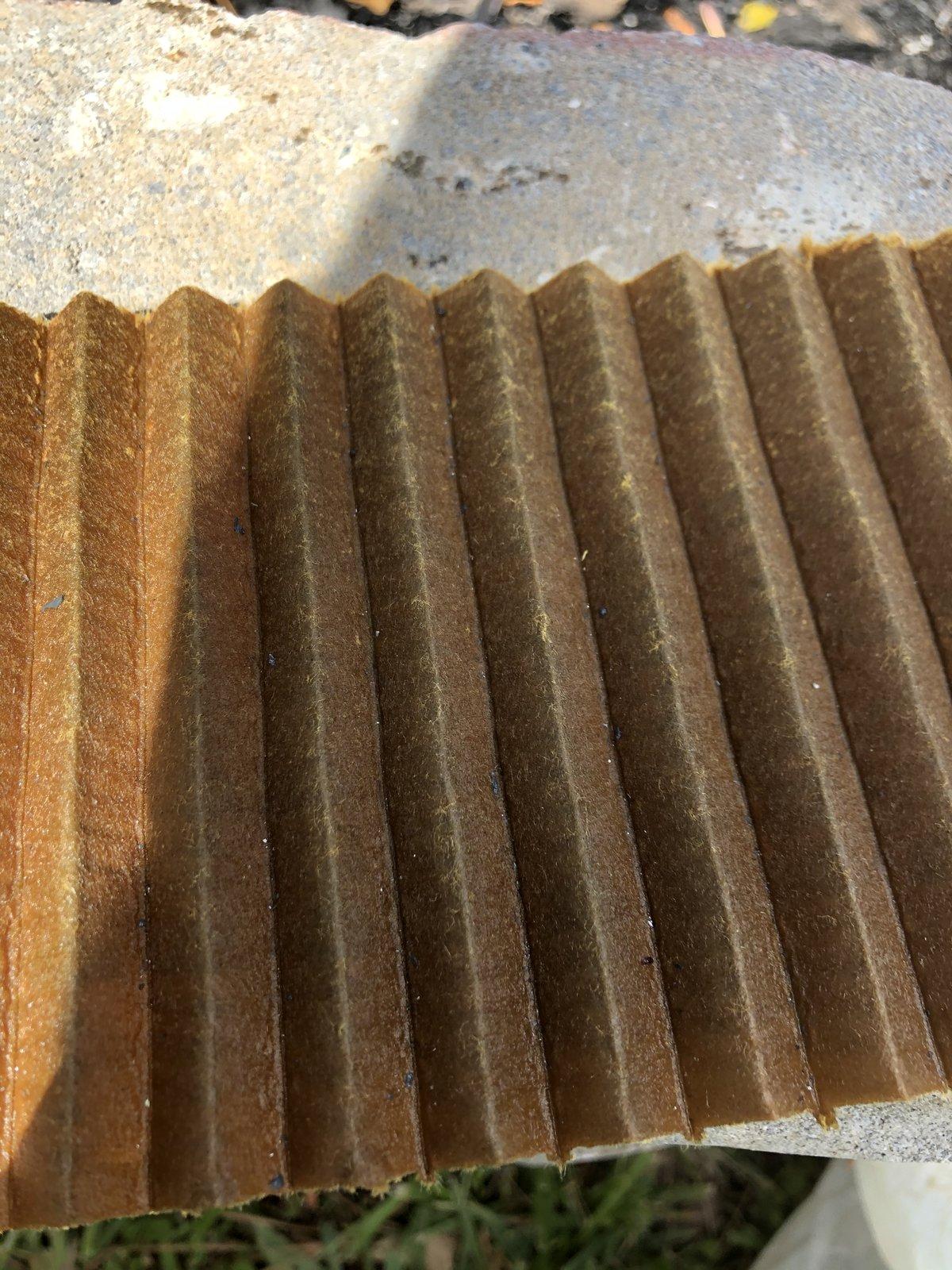

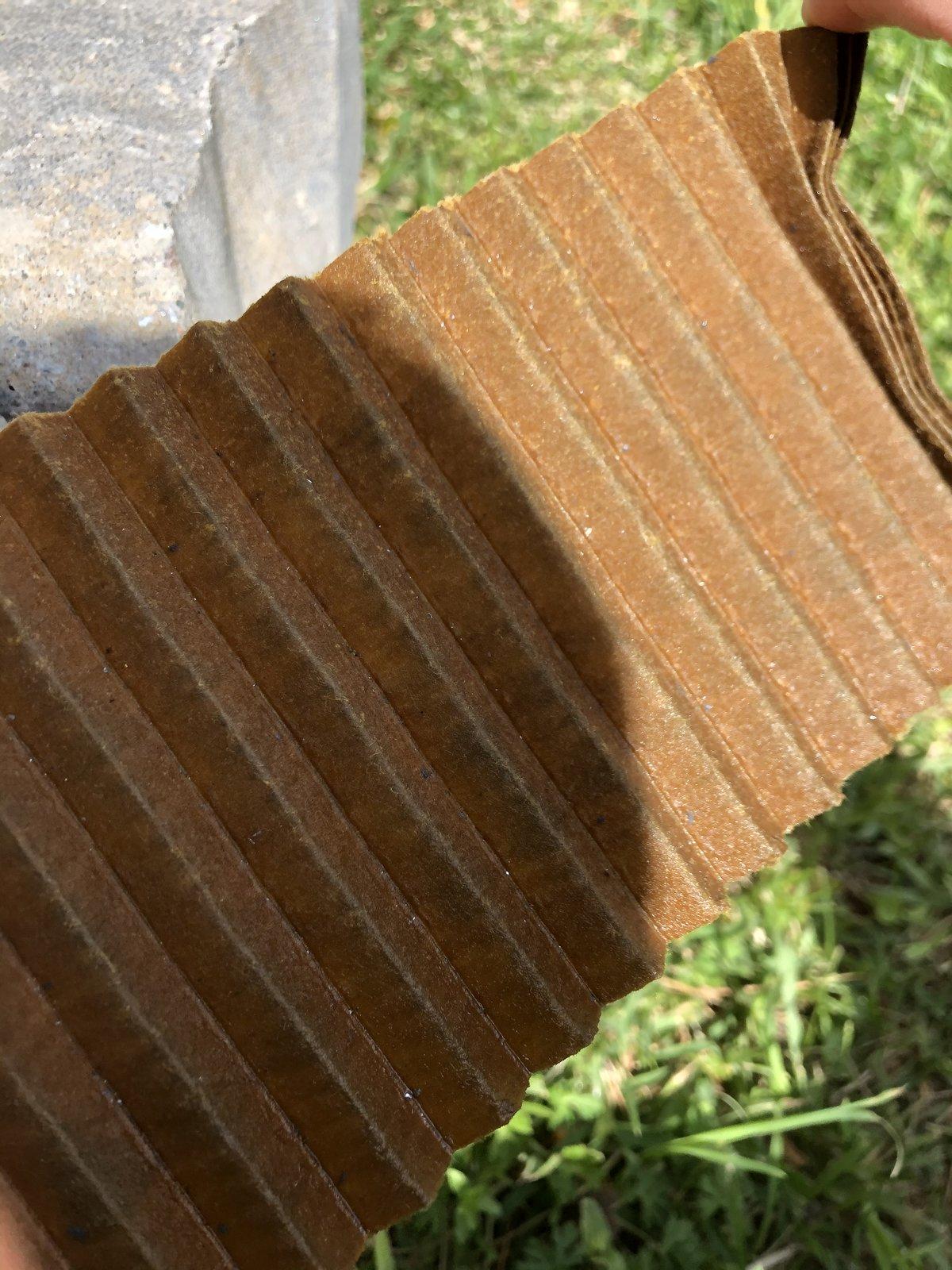

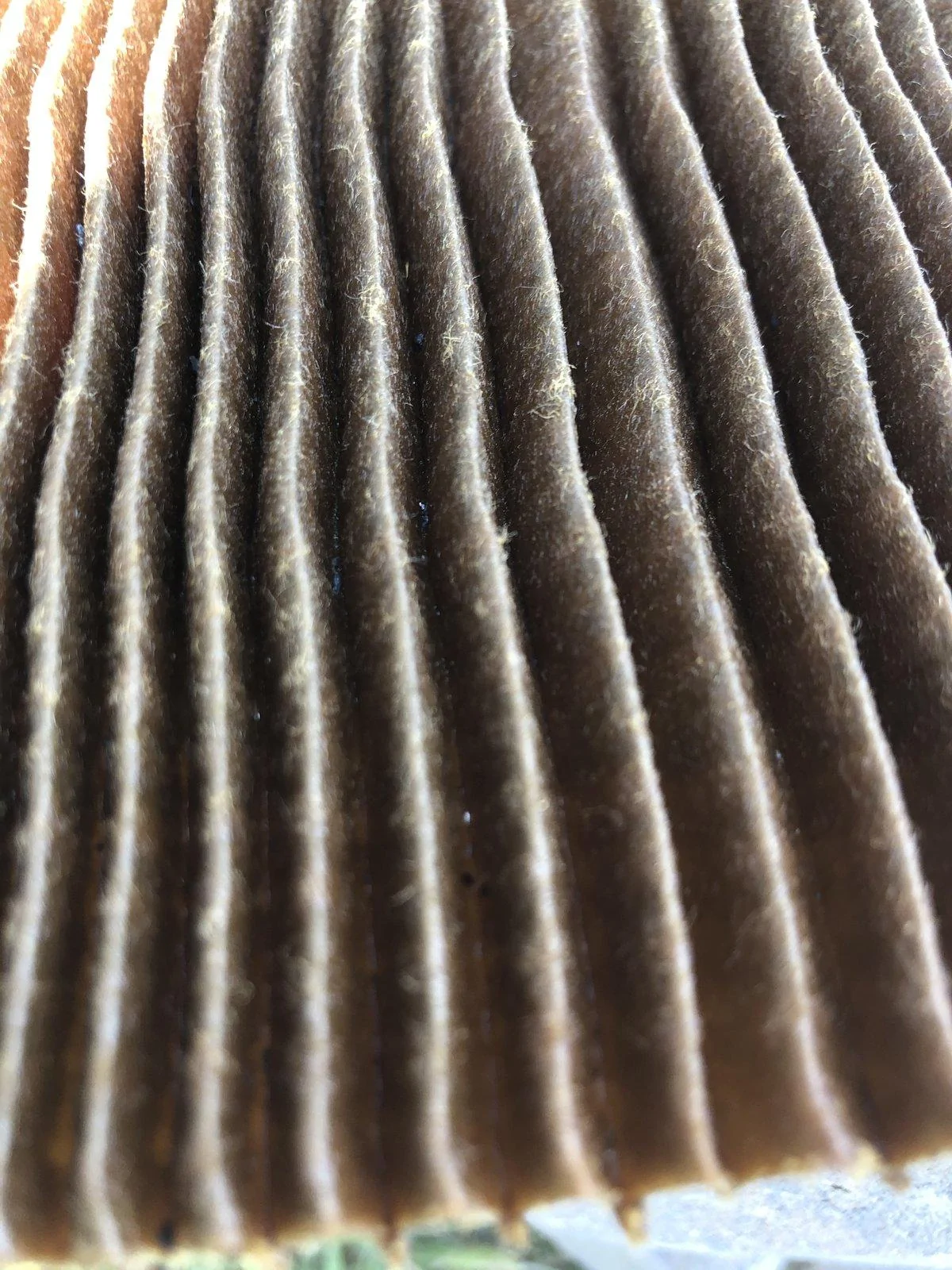

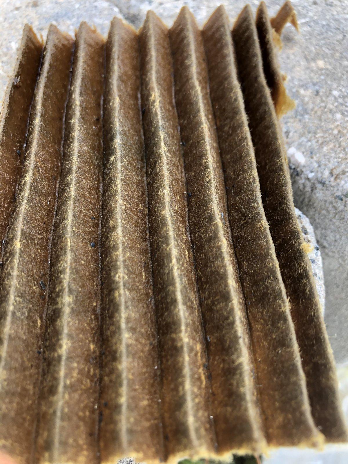

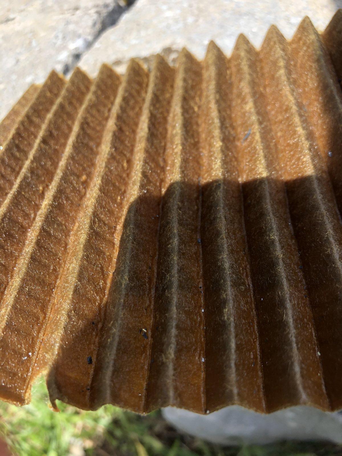

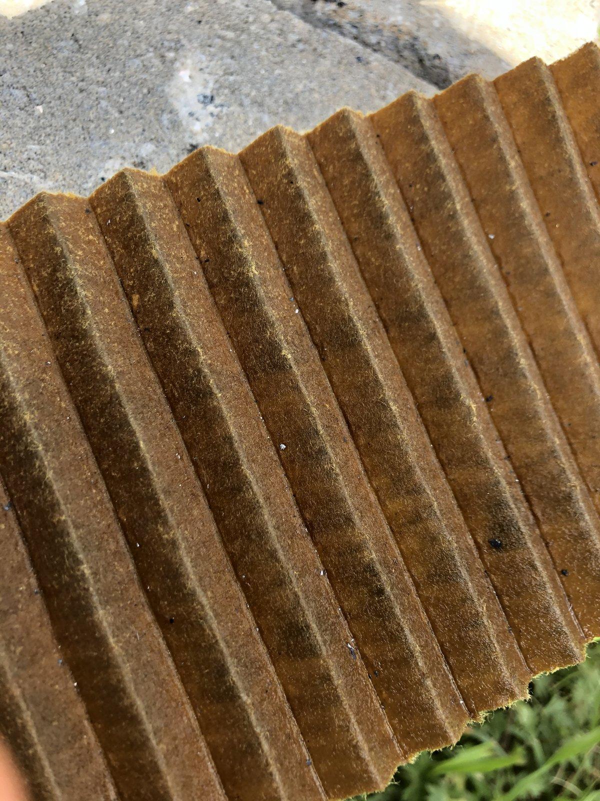

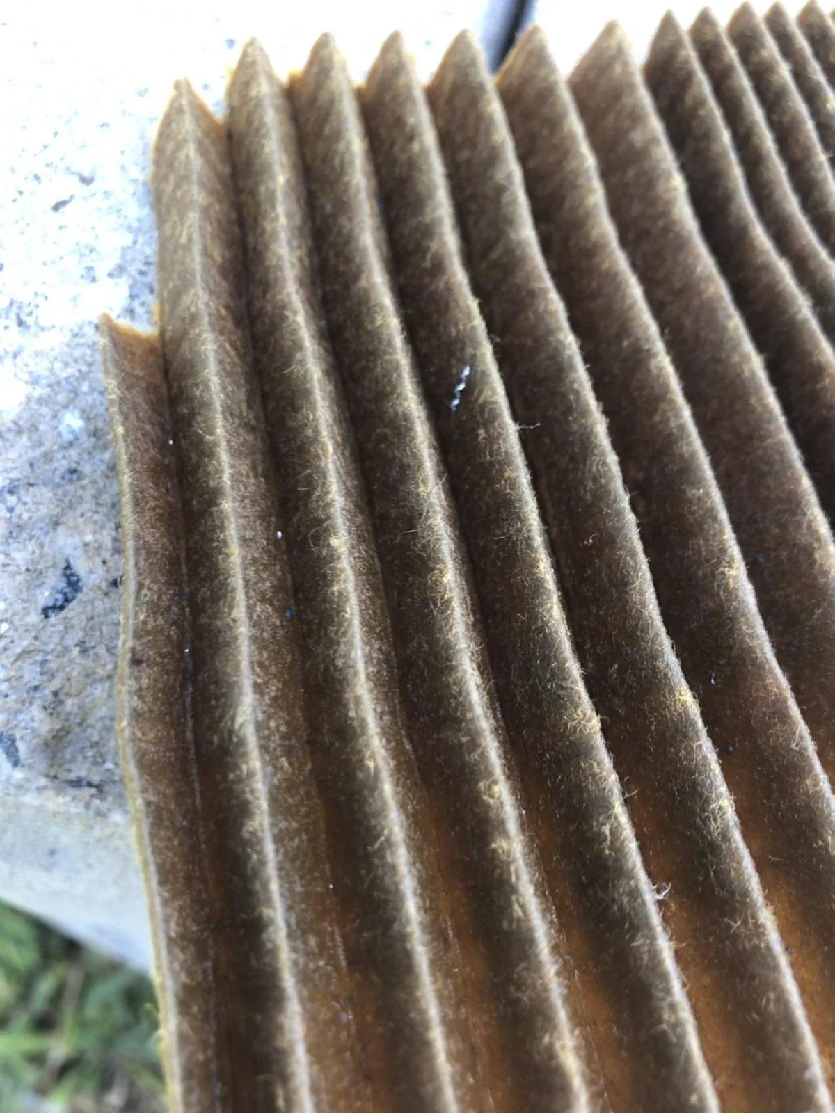

So I just changed the filter in my Jeep with about 1500 miles on it. Noticed that there seemed to be a fair amount of metal shavings that were caught, see attached pictures. Just wanted to make sure it was normal for the Pentastar V6 for the first filter change or if I should be worried?

Following this. I just did my first oil change at 1500 miles also. I did not notice any shavings on my oil filter. But I didn't disassemble it like you did. I looked it over quick, opened a few pleats. Saw nothing, nothing looked unusual.

I wouldn't be concerned -- that's why we have filters. Aircraft owners/mechanics check their filters at every change and what you have there is pretty typical throughout the life of the engine, with the exception of that one largish curly burr. That one looks like a manufacturing remnant.
Auto engines with smaller pistons and tighter tolerances won't show as many metal particles as a norm, so be sure to check your next filter change and I bet it will be improved. If it's worse, then there might be some concern.
Edit: If you want more peace of mind, you can have oil analysis done as a lot of aircraft owners elect to do. I use Blackstone labs and they are great at interpreting what metals (suspended in the oil) to expect as an engine breaks in and ages. If you still have the used oil, it's beneficial if they can see that first baseline sample. If not, no big deal, maybe submit a sample from your next change.

Thanks for the replies, I wasn't super worried as I've heard about metal shavings during the break-in of the engine. Just seemed like a good bit, although the engine is made in Mexico and FCA isnt exactly known for their quality control in the industry.

Looks normal for a new engine. I recently rebuilt the LS1 in my C5 Corvette and I cut open the oil filter after each oil change. (I changed the oil several times in first 2500 miles). Not uncommon to see small metal shavings as the rings seat, etc. Should be reduced in future oil changes.
I also use Blackstone for oil analysis. Probably not needed every time, but doing one every so often lets you build up a history to know what's normal and what's not.

I can offer you insight on engine building. I have built 500 hp v8s and a 500hp turbo 4 cylinder. After the intitial break in its normal to see a little metal as you can only get the oil galleries so clean. This to me looks absolutely fine compared to my break in oil filter engines I have personally built.
NOTE: The biggest thing you need to worry about is brass, not bright metal. Brass means your bushing are getting eaten alive and or your thrust bearing on the crank is under load due to a bad transmission install on the rear of the crank.
Blackstone labs can tell you if bearing material, metalurgy, and oil life based on lab results. I wouldnt worry about it on a stock warranty engine.
Moral of the story, some metal is normal, if you see bronze or copper colored material you should worry.
