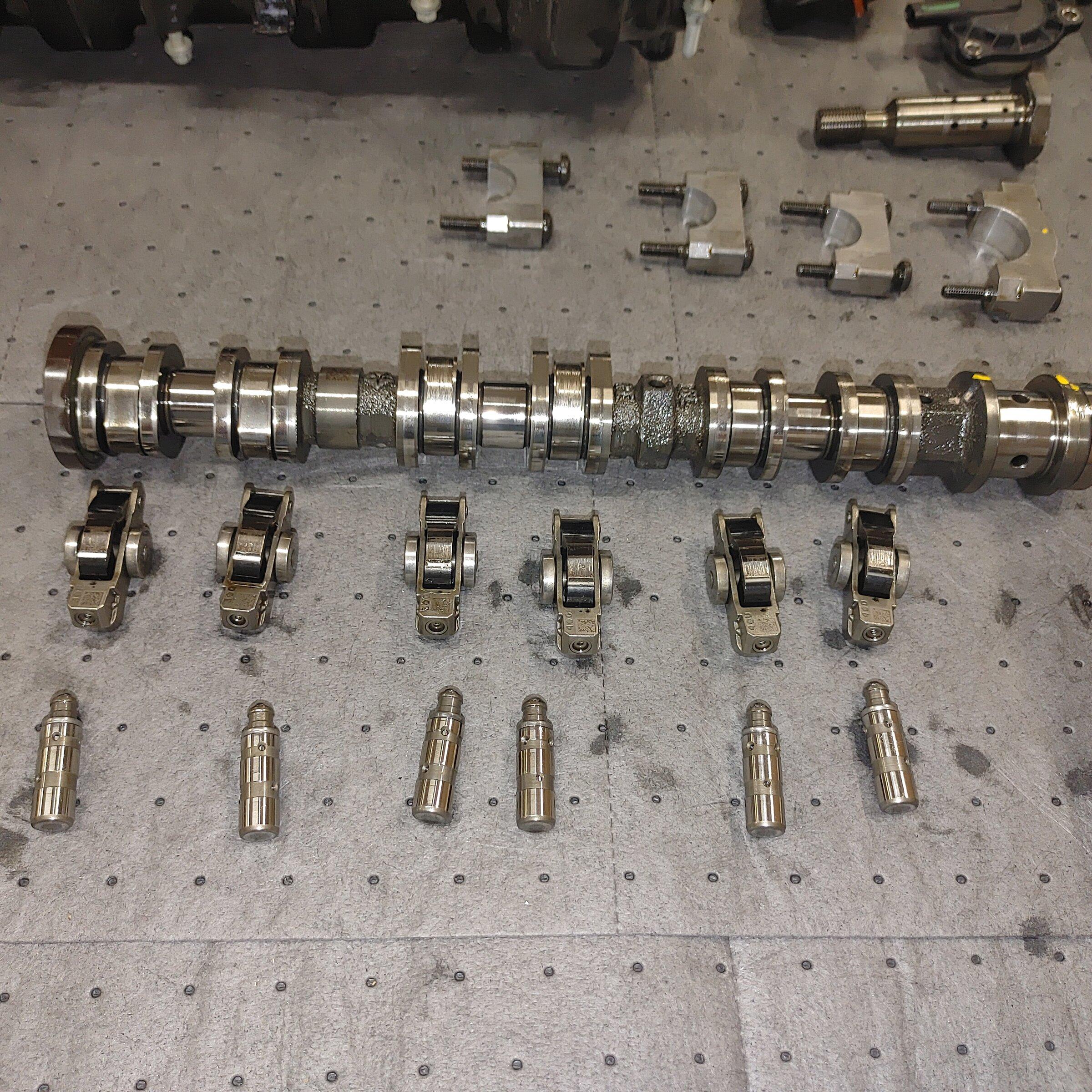

My 20 JTR, 22k miles has a tik tik tik that I can hear inside the cab, middle pass side. It gets most noticeable at 3k and up and speeds up width engine speed. Almost like when you vibrate your tongue I guess, lol.
Is this what you guys are seeing? It's sounding like it doesn't hurt anything but sounds like crap.

Your cam sounds like it is going flat. That description sounds about like what mine was.

I have seen 5 of these now. My guess is they are more widespread than they should be. If you are never leaning into the throttle hard it is hard to determine something is wrong.
