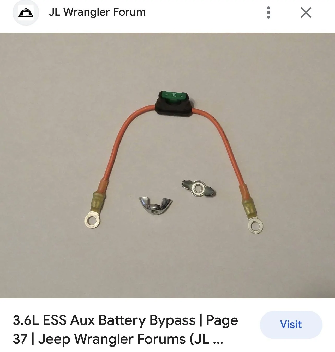

Also…… do you have an opinion or have you done your homework on the jumper cable that they sell for about five bucks that you could easily make yourself but it’s easier to buy that. It goes from post “N1” into “N2” I believe, it has a fuse in line on it.
I have not looked into it but looks like it might be an option. Aux battery change out is a pain in every video I have watched vs a one and done cable... sounds fantastic.

I have not looked into it but looks like it might be an option. Aux batter change out is a pain in every video I have watched vs a one and done cable... sounds fantastic.
I have done it and it is no big deal. Two ways of doing it, one from the top or one from the bottom, I have watched the videos that did it from the top, and it looked harder than how I did it from the bottom. Pretty simple.

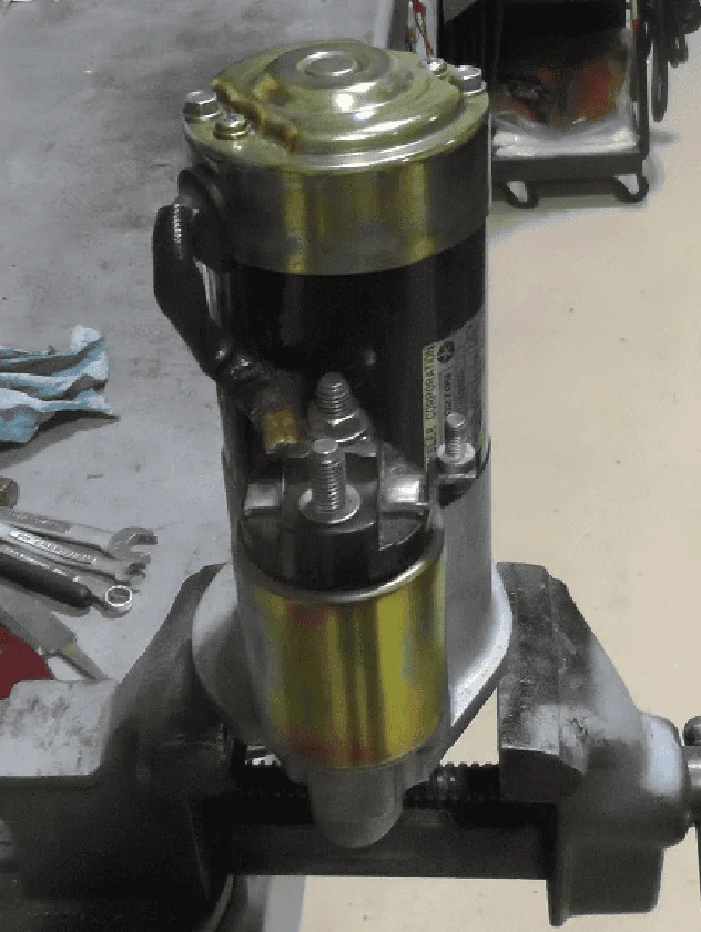

Go back and read all of the other posts on starters. I've been an automotive electrician since the 1970s- starters included.
These systems know exactly where each piston stops, exactly when each injector last fired and more - a hot start from an ESS event is no real load at all. In fact, a person who does nothing but short frequent drives will lose batteries and starters faster than I will.
Cold starts kill starters and engine parts, not hot ESS starts.
The engines are designed for ESS, the starters no longer use carbon brushes, they use real bearings instead of bronze bearings, I could go on with the differences............
The people spreading mis-information have no real experience with engines, starters or much else with these.

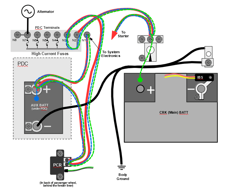

Is there any truth to the statement that is made often in all these posts that if you have your ESS button shut off most of the time that your ESS battery will not charge up correctly?”
NO!
Take a look at the wiring - these charge no matter what unless YOU cause a fuse to blow, or don't drive LONG enough to charge the batteries.
The batteries are in parallel and the aux battery has a semi-direct line to the alternator through the PCR and is also connected to the main/crank battery.........
Sitting around, short drives (less than 30 minutes, short commutes, etc.) and that sort of thing kill the batteries because they can't recharge fully.
Basically most of what you read out there about ESS is just bad info - or worse.
Why would shutting off ESS prevent either battery from charging?

Thank you to everyone about your experiences. Special things to ShadowsPapa. I’m pretty sure I have read over 40 pages on this topic while I have learned some from it, it’s still very confusing because there is not much information posted as a “”fact””. By no means do I think I am a dumb guy. While it is easy to separate the wild stories from real ones there’s still a lot of truth to uncover and no way on earth is it perfectly clear in all of these ESS posts. Thanks again to everyone for your help, Robert.

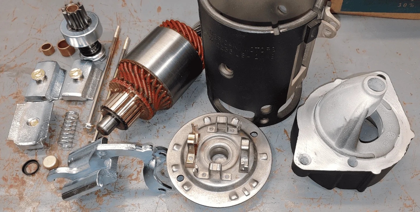

These are not yesterday's starters. Brushes are no longer carbon, commutators are totally different, permanent magnet motors mean a fraction of the amperage draw. Bearings, not bushings.
If an old-school 4.0 starter can last 160,000+ miles, I'd see these as lasting well over 200,000 miles. It's a safe bet no one here will need a starter replaced except under extraordinary circumstances (made by humans, anything can fail)
