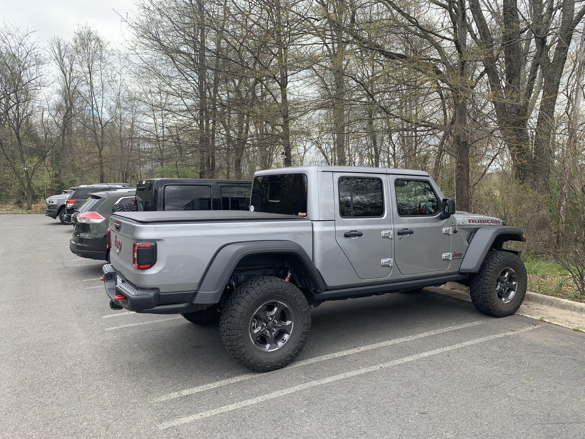

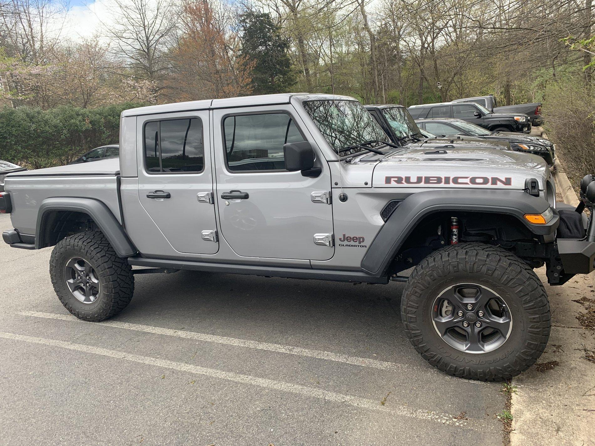

The 2.5” EVO lift is installed. It’s a perfect height. Added about 3.5” front and rear (with a steel bumper and winch). I don’t know exact him eight difference because I went from a smaller lift not stock. Definitely big for my 35s so I need to move to 37s now. The installed lift is a Enforcer stage 2 plus.
Jeep Gladiator Evo 2.5" Lift (True Height) E7B8BD68-D35C-401B-AFA5-3B716DF5BB6D
Jeep Gladiator Evo 2.5" Lift (True Height) 1CC99DD0-B9F8-4897-B775-AC488AD1F54D

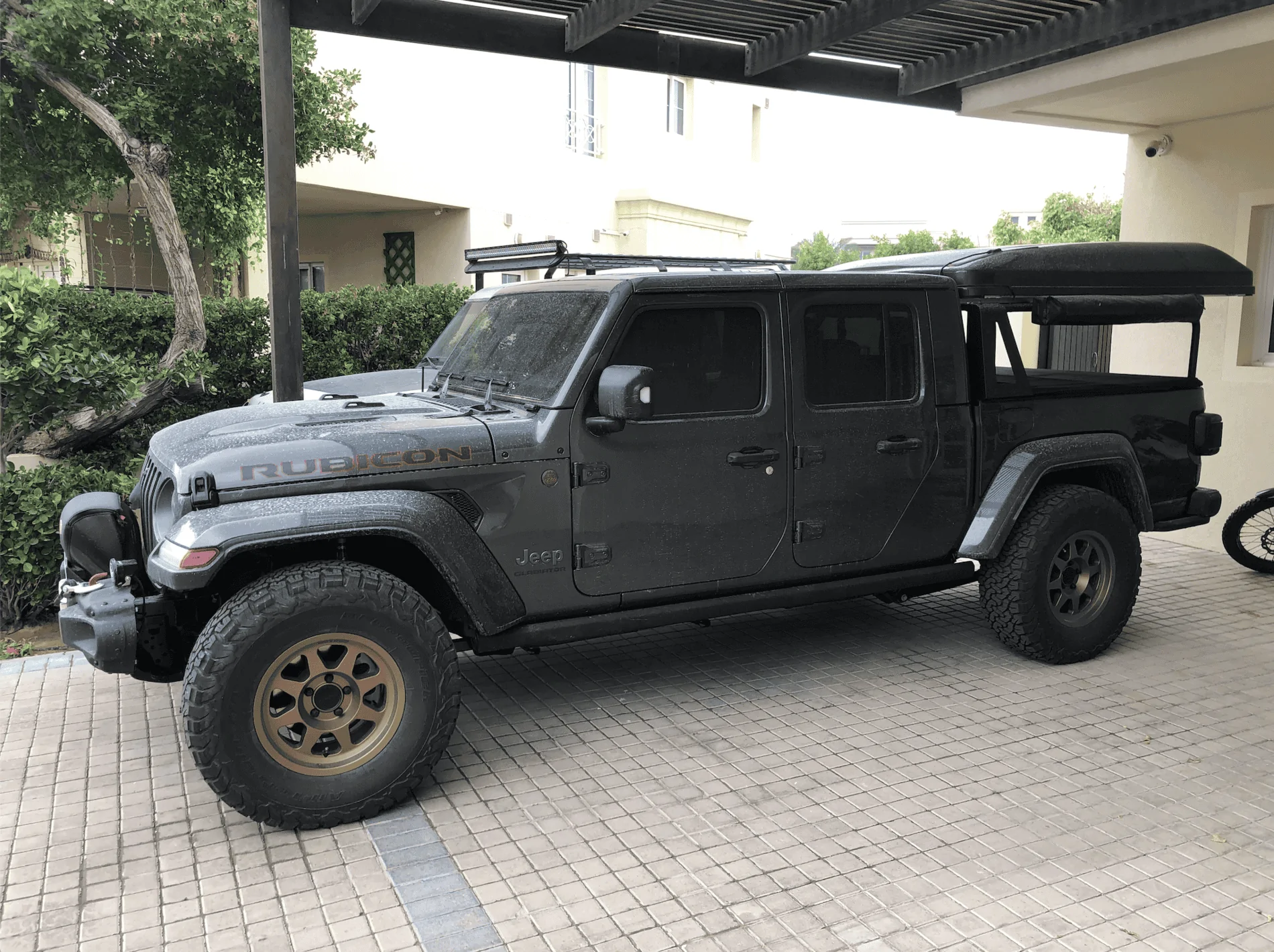

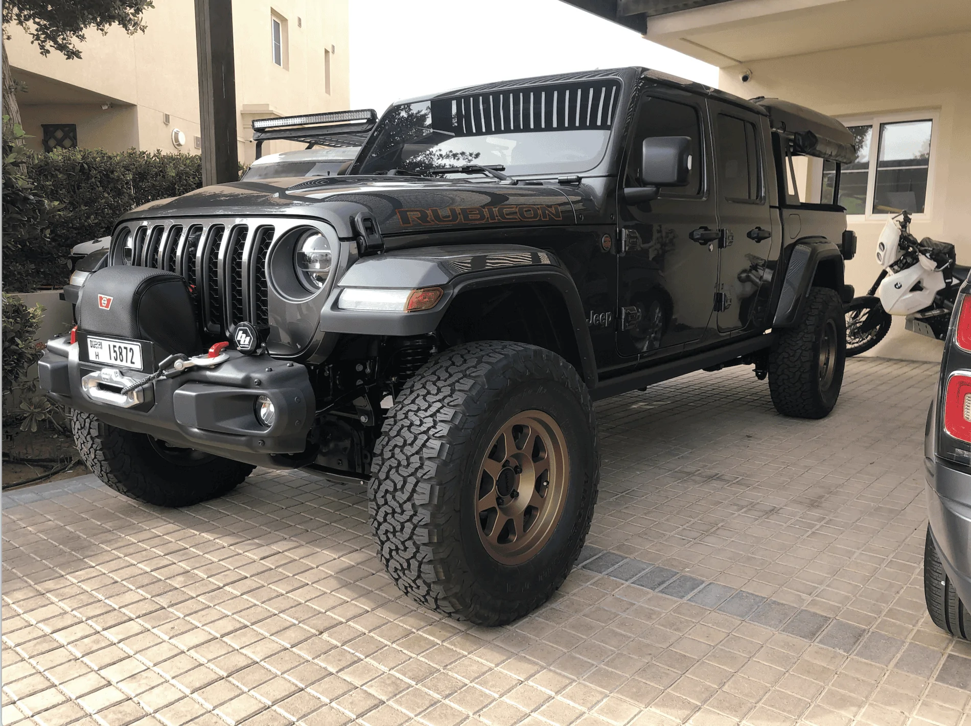

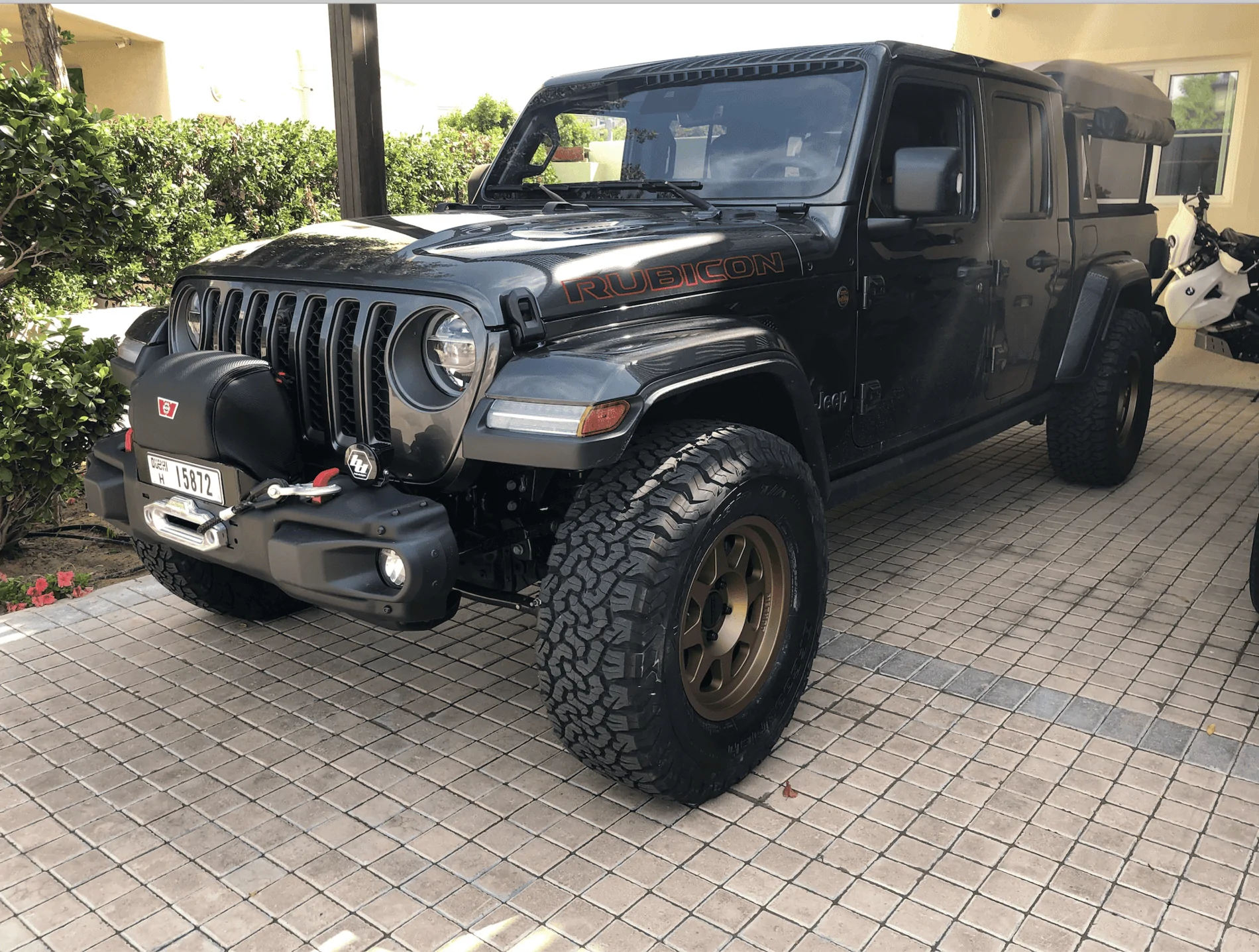

Before (stock Export JTR suspension with an M8274-70 up front, and out back an RTT, Rack, 65L of water, fridge slider, air compressor and tank, and an AGM battery), and after (same gear):
Front rock rail: 16.5-20
Rear rock rail: 17.5-20.5
Rear under tent: 69-72
So +3.5” front and +3” rear
Jeep Gladiator Evo 2.5" Lift (True Height) Screen Shot 2020-04-05 at 3.18.33 PM
Jeep Gladiator Evo 2.5" Lift (True Height) Screen Shot 2020-04-05 at 3.18.21 PM
Jeep Gladiator Evo 2.5" Lift (True Height) Screen Shot 2020-04-05 at 3.18.44 PM

Installed on Thursday and barely did more than 20kms...so hoping after the curfew we have in Dubai, will get some mileage and settle a bit...I'd like to order the high line Mopar fenders to make sure the 35s have enough space...
