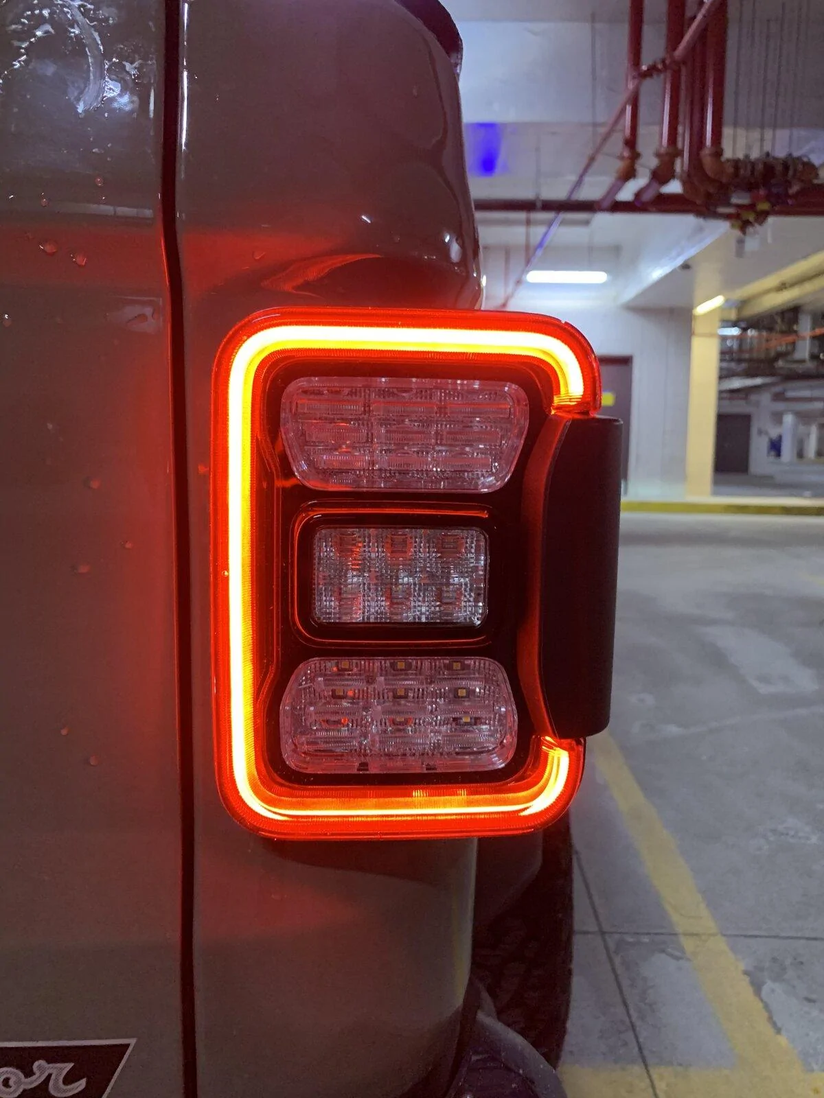

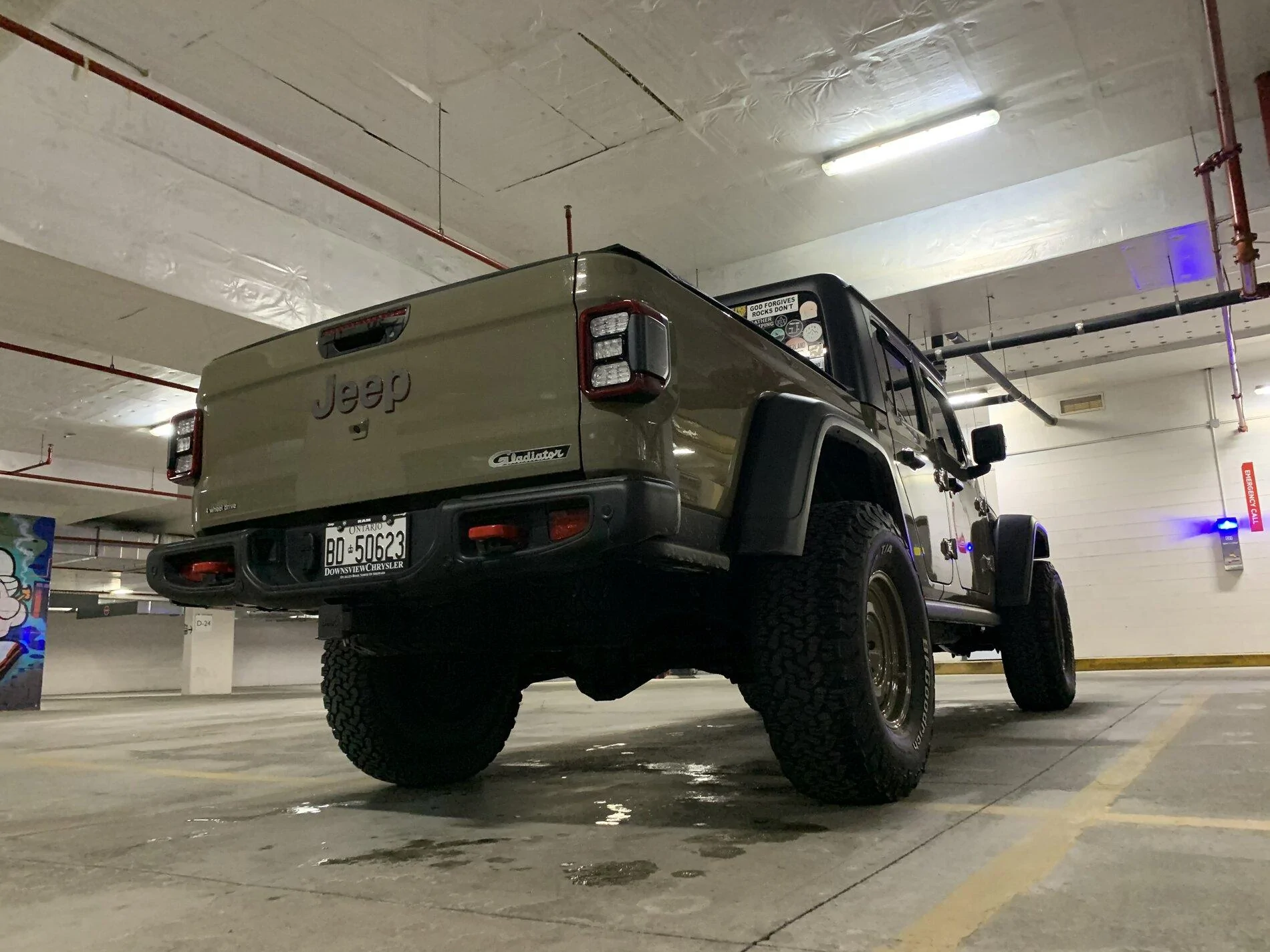

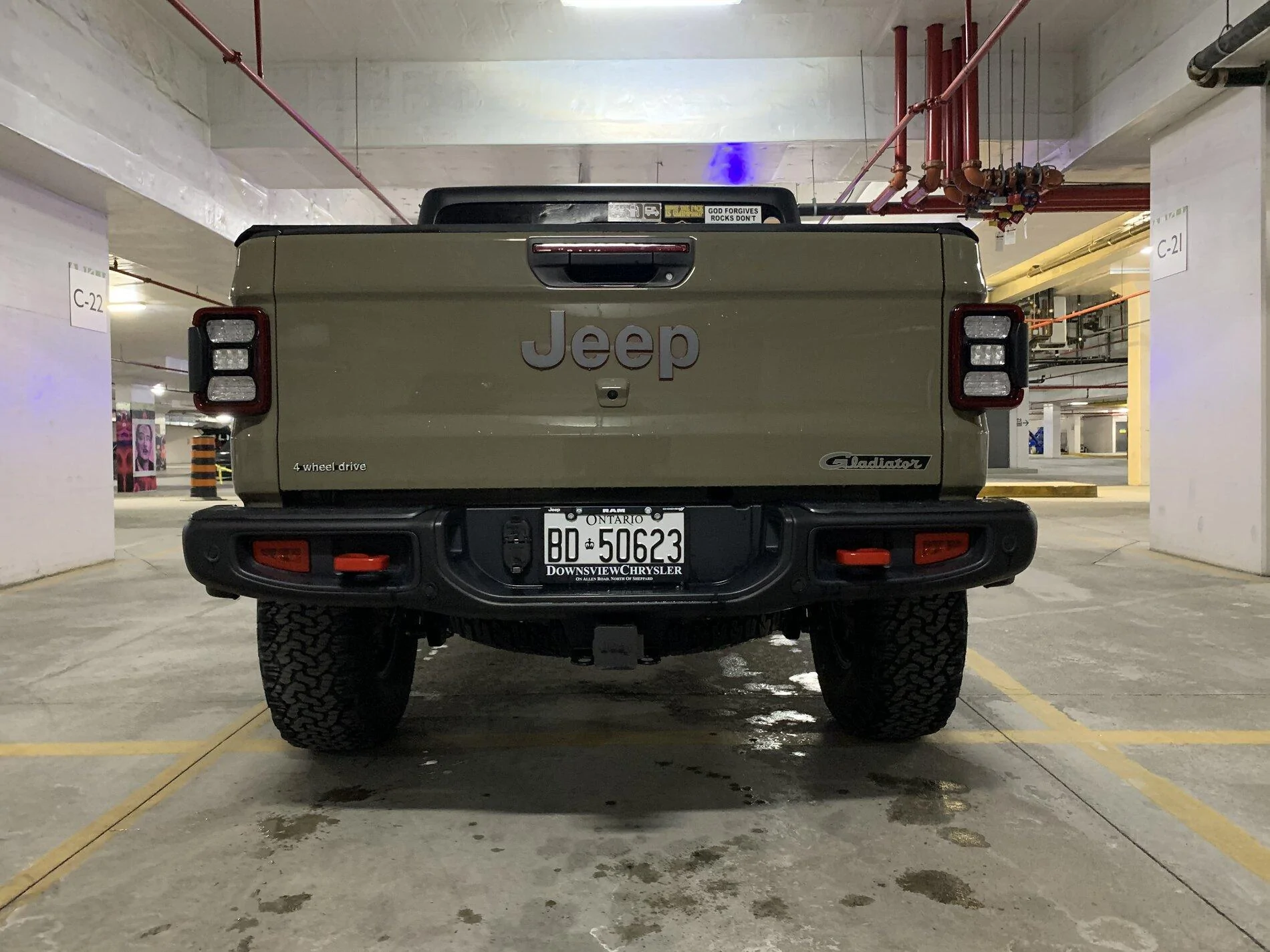

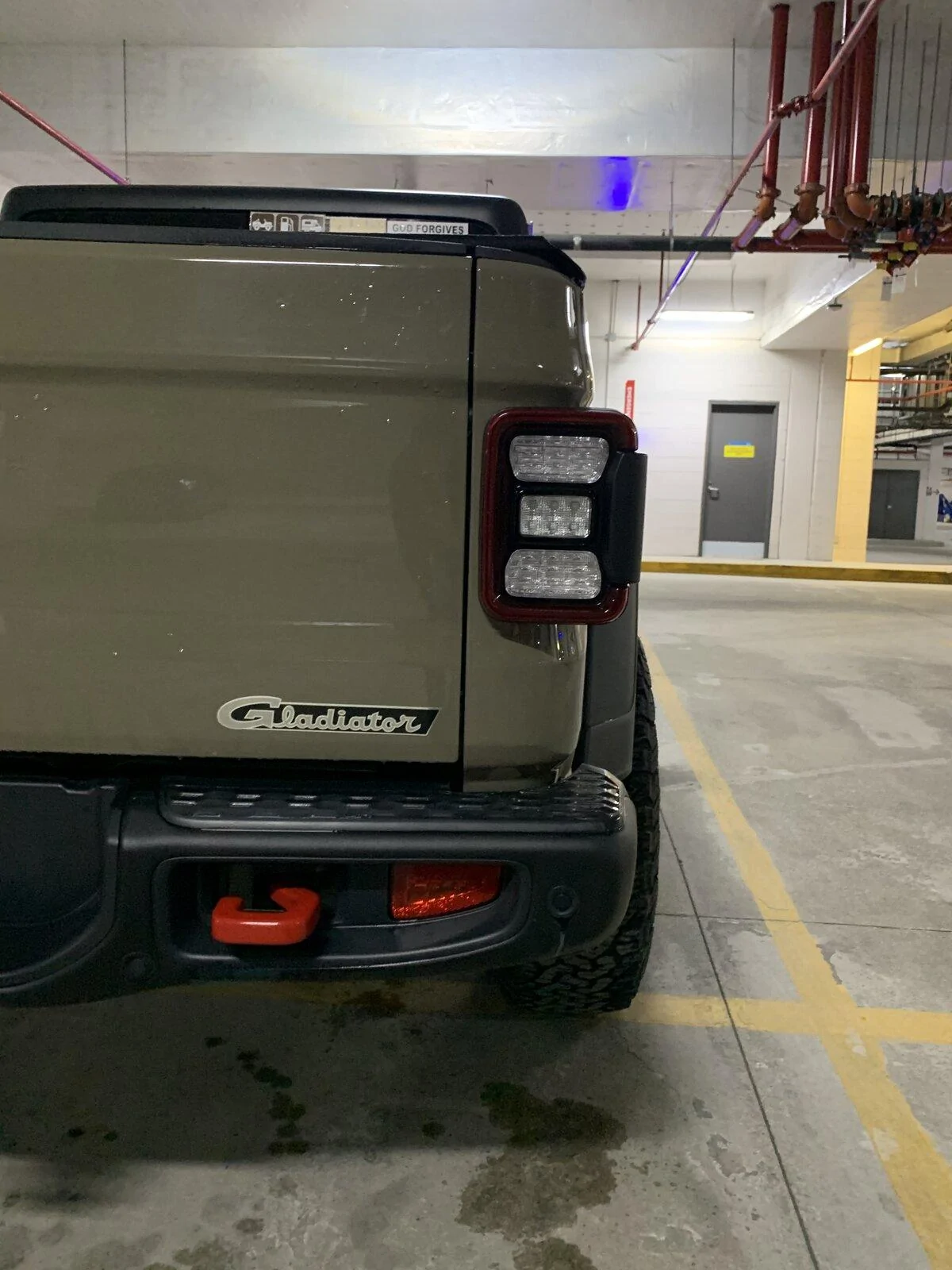

Ok so I just got my correct lights and honestly love how they look. I obviously still need to wire it up so the ambers are the signals. Currently the brake and signal are the upper red section. The only thing is on the dash it will hyper blink and sometimes says I have a taillight out. But it is still working.
Haven’t adjusted anything in JSCAN yet.
