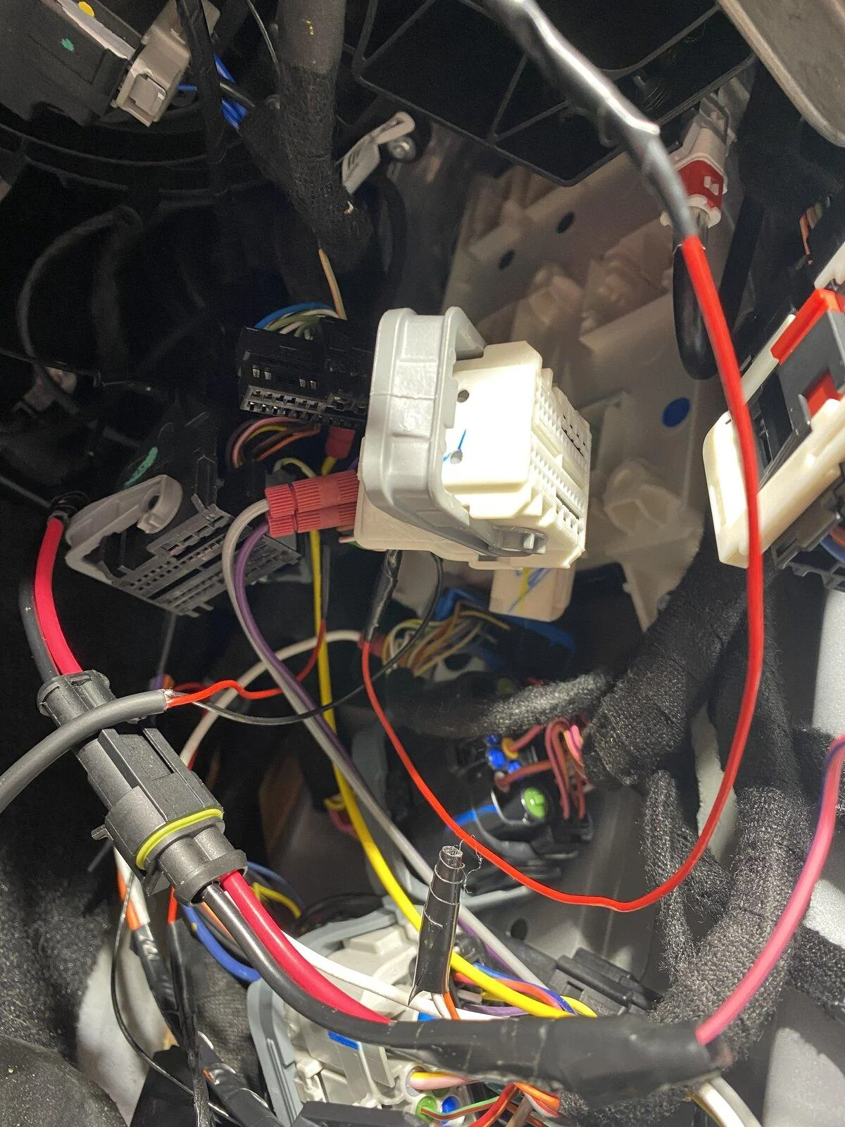

Well taillights are in, BCM is pinned, working with the JSCAN and i'm currently stumped. There's two settings in JSCAN that I mainly played with.
1. "Rear Turn Lamps Output Present" - the tip tells you pin E3 and F42 - which is how I wired them in the BCM currently. When you activate this, it changes nothing, the top portion of the taillight still acts as the brake and the turn signal, nothing on the bottom.
2. "Combined Rear Lighting" - This was active and I deactivated it and I got power to the bottom amber turn signals but it's just a quick hyperflash and for every 7-8 ticks on the directional, you get 1 flash out of the amber ones. With this deactivated, the top was my brake and did not act as a turn, which is what we want, just not the hyperflash.
I've messed with every setting I can think of relating to the taillights. I'm not sure if there's some combination of them needing to be activated and deactivated but I can't figure it out. I'll work on it tomorrow but if anyone has ideas.... i'll try anything.

getting closer.... I think. I just need to figure out how to get this setting to ON.
Jeep Gladiator Export Tail lights on NA Spec Gladiator 1611301164458
I can toggle it via modules > body controller > activations and it works fine, no short or anything. I can power it so the amber light is always on or toggle it for 5 flashes. Once I find this setting somewhere in this jscan app, we should be 100%

Just a little preview while I finish working the kinks out with Jscan. Still get some hyperblinking.

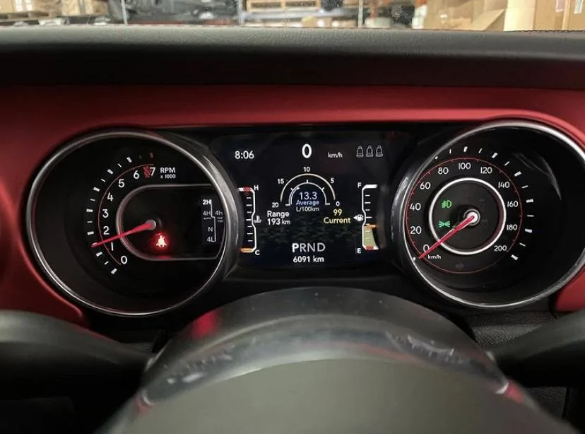

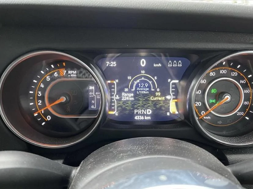

So one of the pages I follow on Instagram recently posted a picture of their Gladiators they have. Australian spec. And they posted two gauges cluster pictures and I noticed something we don’t have on North American versions.
It has a rear seat passenger indicator on them. When asking about the picture they advised me that it is due to the fact that there are no passengers in the rear seats.
See the top right hand of the gauge cluster.
Jeep Gladiator Export Tail lights on NA Spec Gladiator 028A6CA6-64F0-4F12-8632-1023B7C99954
Jeep Gladiator Export Tail lights on NA Spec Gladiator 49EEFD16-D5A6-4FE3-8A3E-3E1FF5523CF5

That's interesting, looks like something that can be selected in the cluster setup menu too, like you might be able to assign it to any position. I wonder what the purpose of having that info on the dash is? a regulatory requirement?
I think it might be regulatory so people don’t forget babies or children in the back seat.
