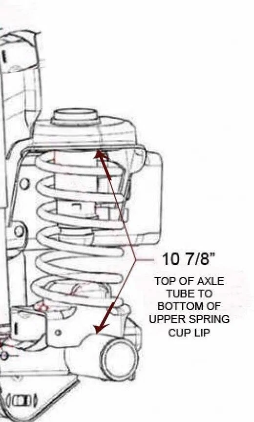

IMO the best would be front shock mount bolts top and bottom.
I'm curious why you think that would be best?
I think measuring the springs makes the most sense. You want to know how much taller the springs are, so measure the springs.
I guess in the end it doesn't matter. As long as you and the person you are comparing with are consistent.

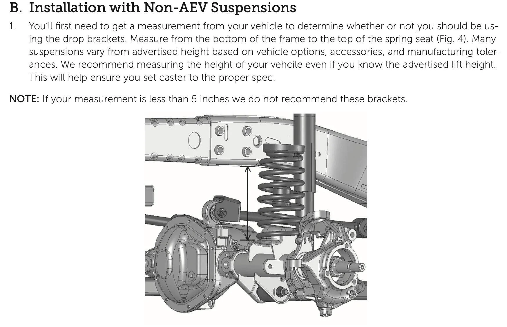

AEV geo brackets are for 2-4.5" of lift. Their install instructions say to take measurements from here and if it's less than 5" then they don't recommend their use. So does stock measure 3'"?
Jeep Gladiator Figure out actual lift height from swaybar link length? Screenshot 2025-05-24 at 10.55.47 AM
