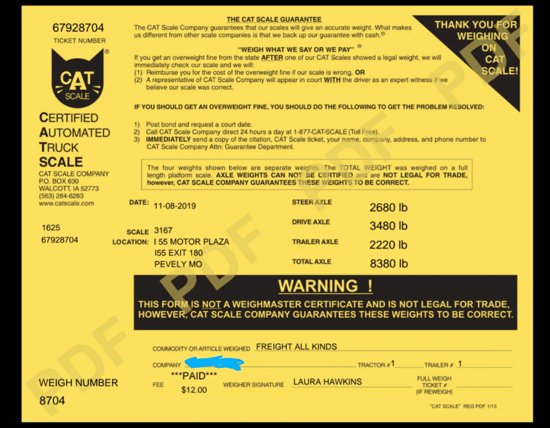

I personally use the cat scales and I'll be using the Haul Gauge once I get it to see how accurate it is.
Cat scale is super easy with the app they provide. All done through the app even reweigh. No need to go in the store for a printout nor talk to the attendant. Here's a sample output with my my cargo trailer:
Jeep Gladiator Figuring or weighing trailer tongue weight? 1568396245
If you use the app, they just email you the above.
As you can see, I have a tongue weight problem with that trailer. Long story for another thread.

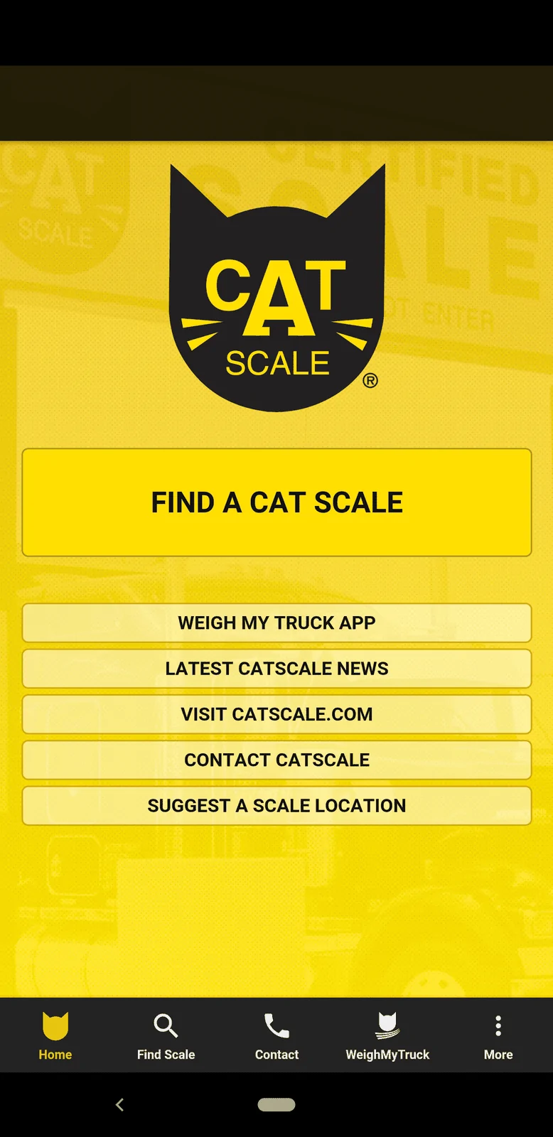

CAT Scale has an app for your smart phone. There's actually two of them. One helps you find a cat scale near you and the other is what you use when you're at the CAT scale.
Here's a Screenshot of the app that helps you find a cat scale:
Jeep Gladiator Figuring or weighing trailer tongue weight? Screenshot_20191124-180847
THANK YOU! Very helpful.
