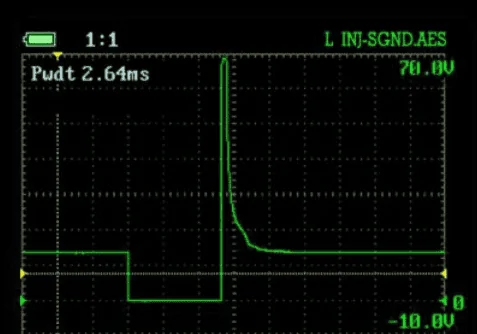

Refresh my memory here a bit if ya'll would. On the other posts about this thing, was the word "scope" mentioned by anyone?
They can literally watch the pattern of anything, including O2 sensors, with the right equipment. They can check for any electric irregularities.
They can even check the pattern to an individual injector -
Jeep Gladiator Finally fixed “maybe” misfiring 1695181629284
Or in some cases, a coil pack's primary can be looked at.
Someone good with a scope can really tell a lot - even about the health of an electric fuel pump.

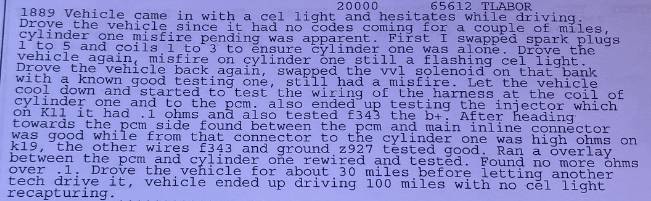

Here’s a breakdown of the work performed. I mentioned using a scope on day 1, but they are morons. They drove it 100 miles. Left me with zero gas. I went and bitched so they filled it up. Just like I filled up the loaner. 45 minute drive home and only a couple misfires total. Maybe someone can break this down for me ,.,,,,,

I have no idea what wires were touching. I am somewhat mechanically inclined, but I don’t know much about electrical. I can change the oil and fluids, etc., but not electric. I was hoping somebody would be able to tell me what happened by reading the mechanics notes.
