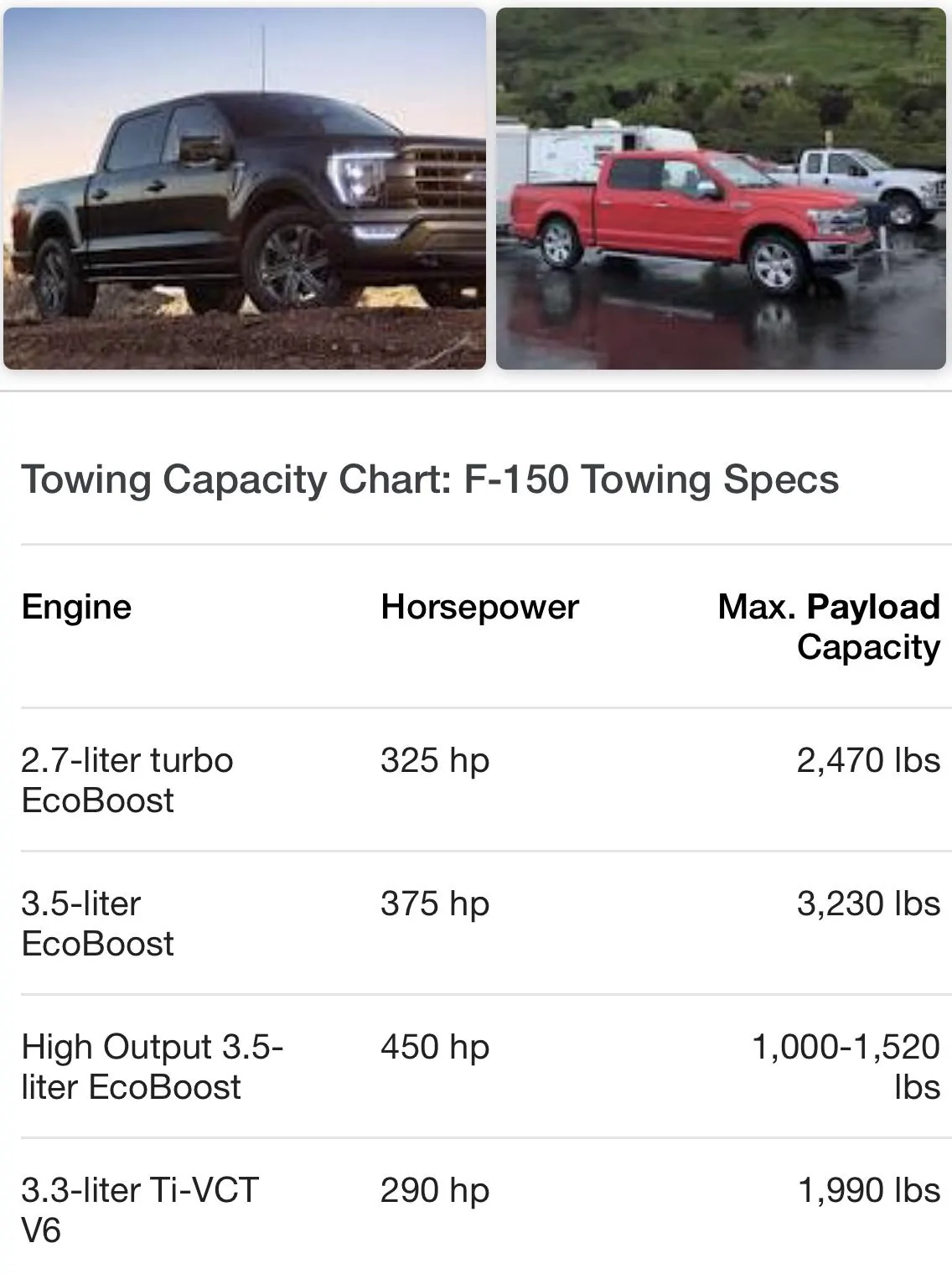

Agreed. The EcoDiesel is the Gladiator’s high performance engine. This comes at a trade off to payload. Still, the 932 lbs for the Rubicon trim is respectable. Check out the same scenario for the 2020 F150. What I don’t understand is the constant let down others express about the towing capacity. For me, it will do everything plus some that I want it to do. If I were someone who needed the towing power of a full-size truck, I’d buy a full-size truck and be done with it. This is a great light duty truck. Emphasis on light duty.
