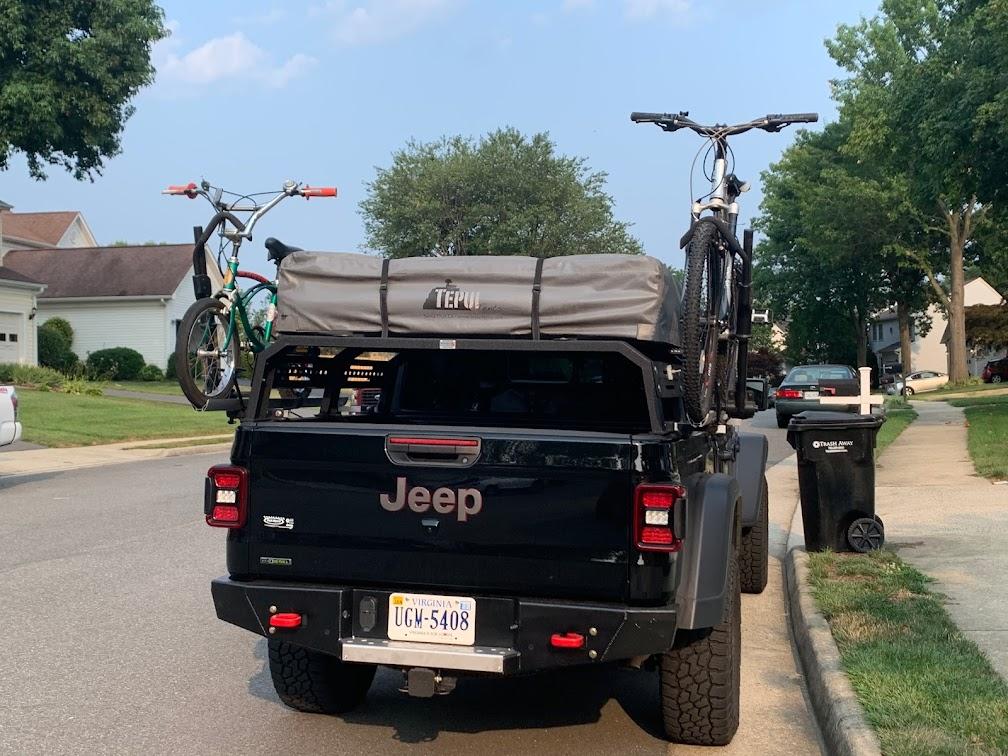

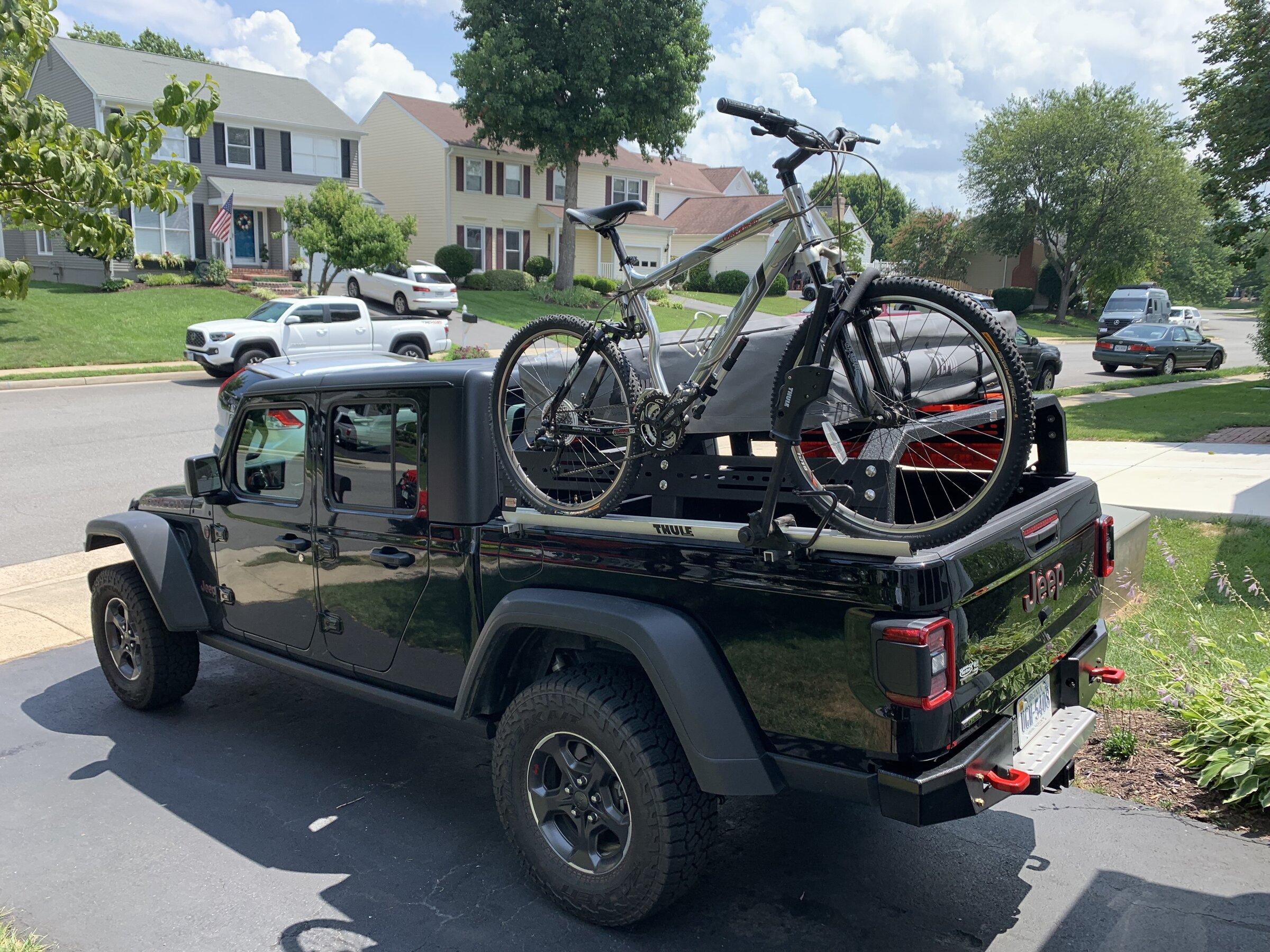

made my own bike carriers out of Thule bike trays and the square holes for one inch tube on the racks. I used one inch aluminum C channel from Home Depot, very thick and bolted them to the trays
