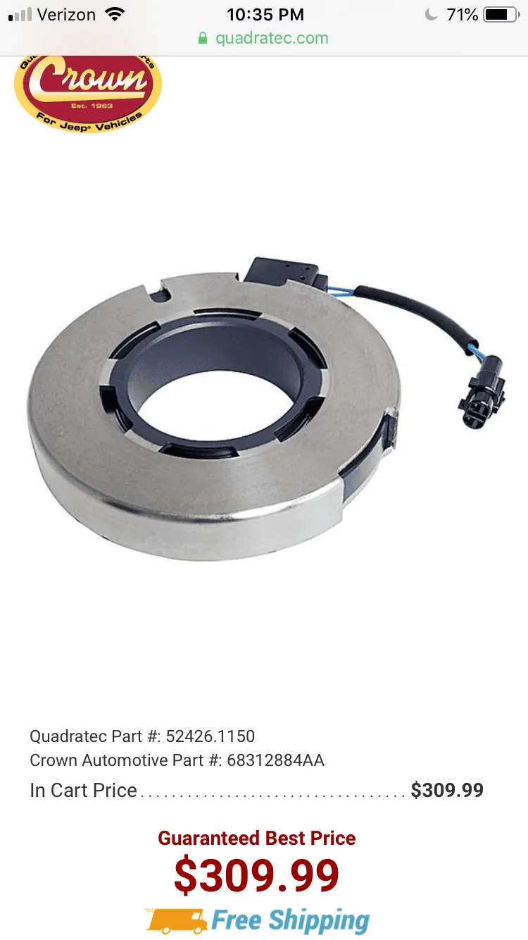

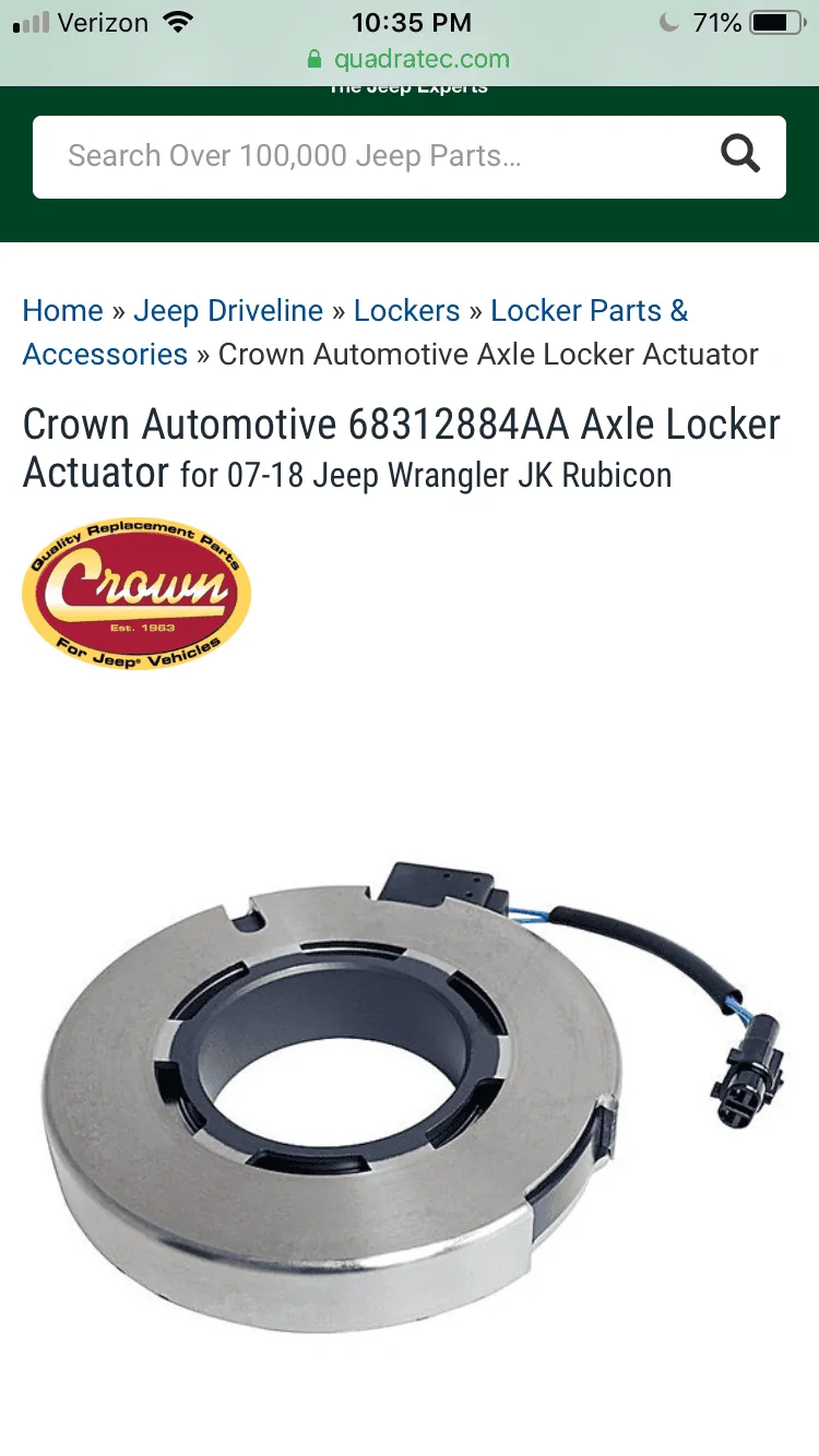

They had to take the diff apart to replace mine. Here is a picture of it
