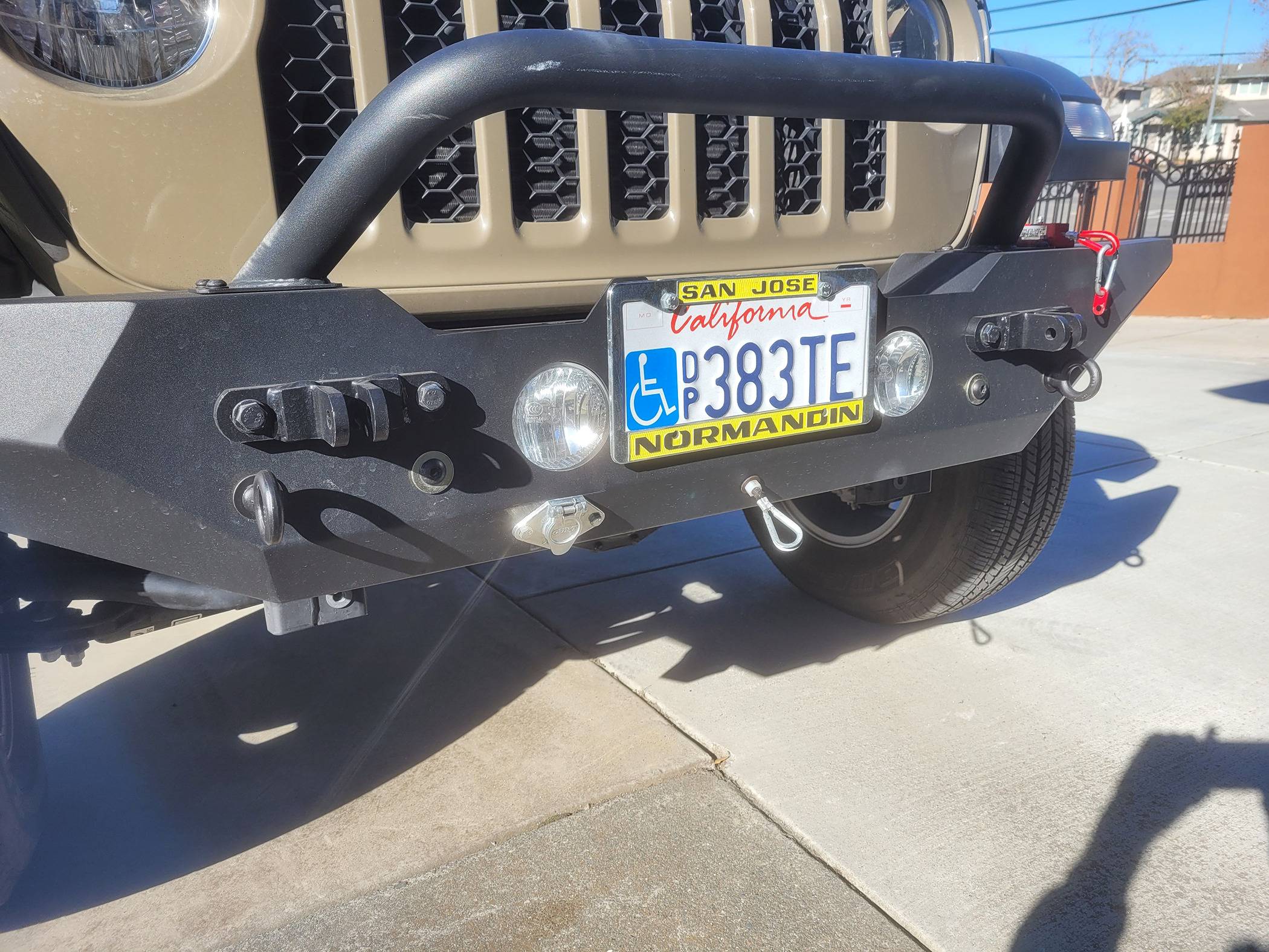

We go both ways: on my wife's 2022 JLU we use a Blue Ox base plate, mated to our NSA Ready Brute Elite tow bar; on my 2020 JT we use a Rugged Ridge Spartan bumper with Rock Hard adapters bolted through the bumper to the frame, mated to the same NSA tow bar. Both methods work great, although we need to use a 6 inch drop hitch on the motorhome to get the tow bar level on the wife's JLU.
Here's a photo of the JT bumper during installation:
Jeep Gladiator Flat tow behind RV: Base plate or new bumper? front bumper

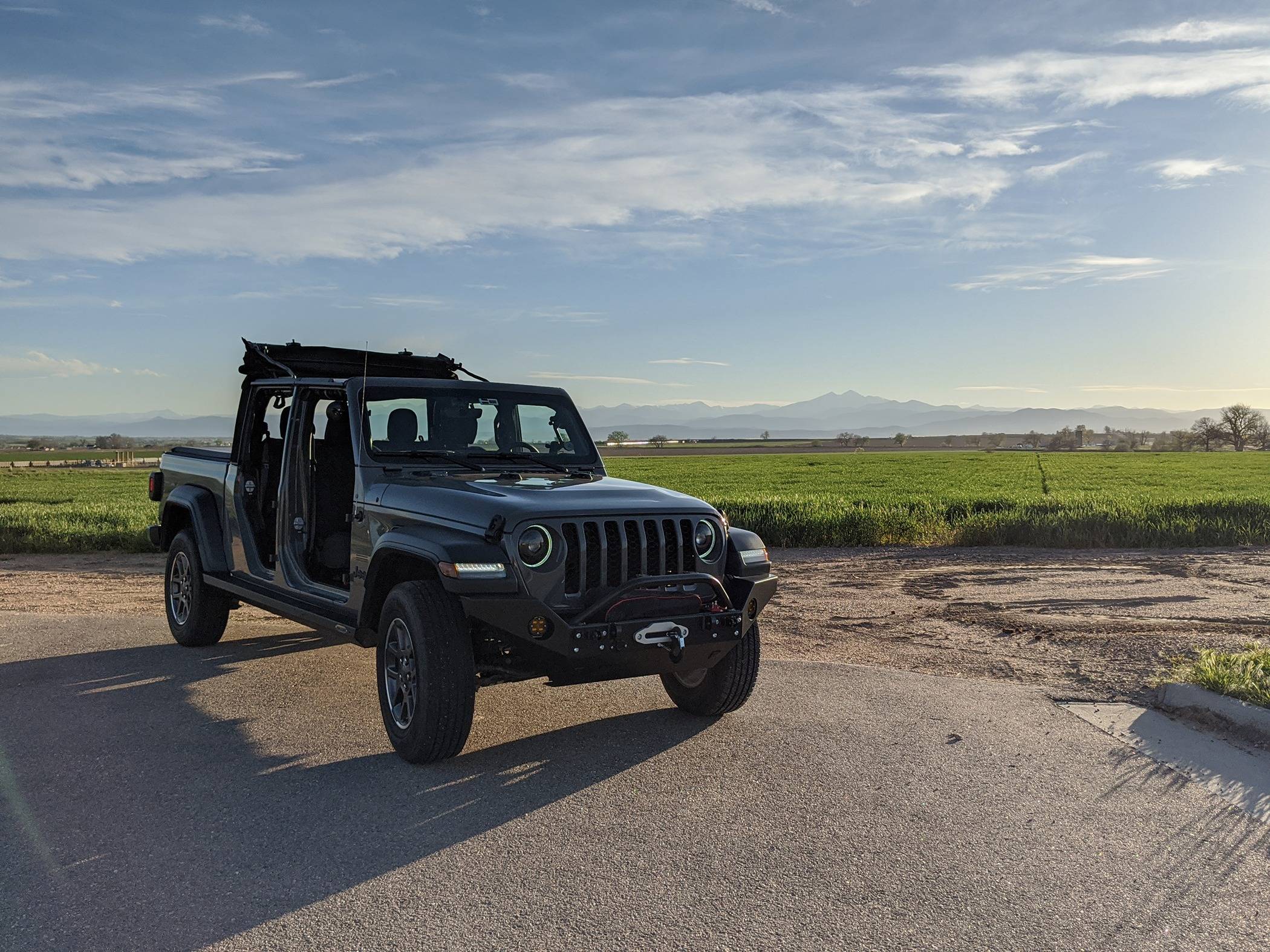

Rockhard Aluminum here as well. Love it, works very well. have towed 1000's of miles with it.
Jeep Gladiator Flat tow behind RV: Base plate or new bumper? IMG_20200518_191620
