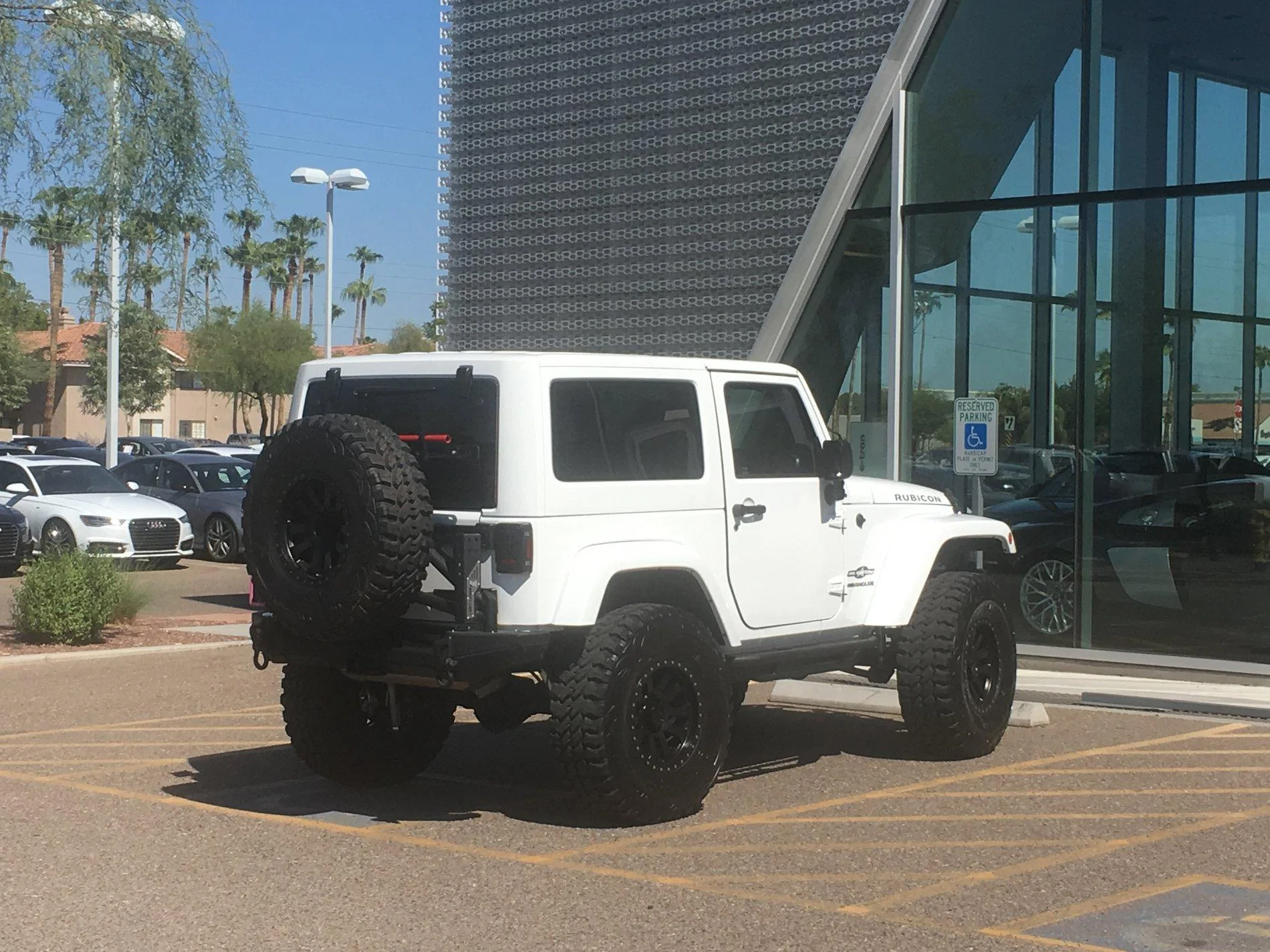

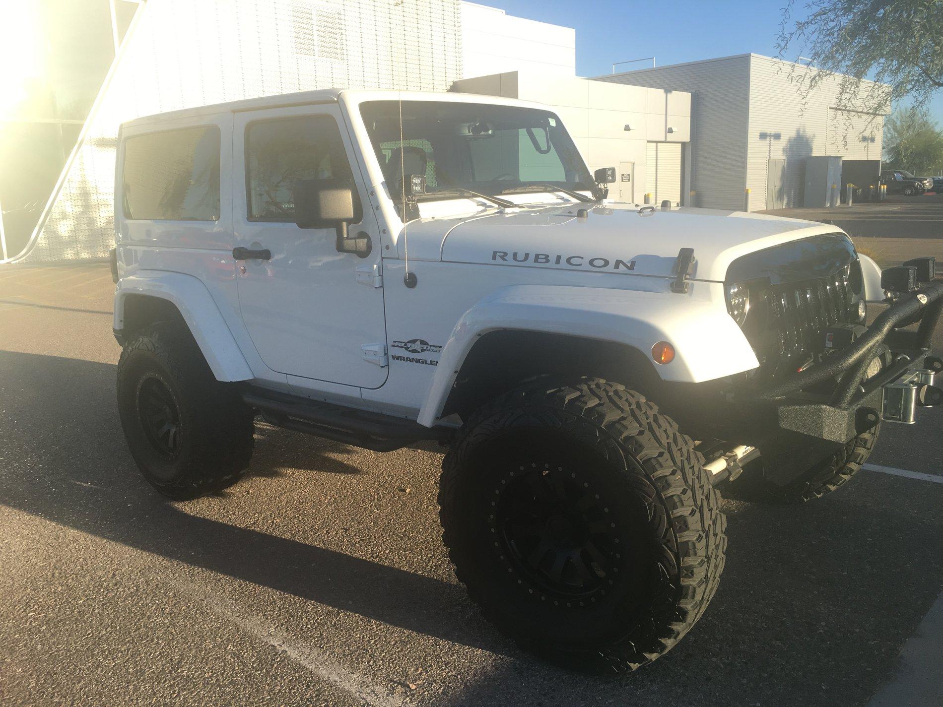

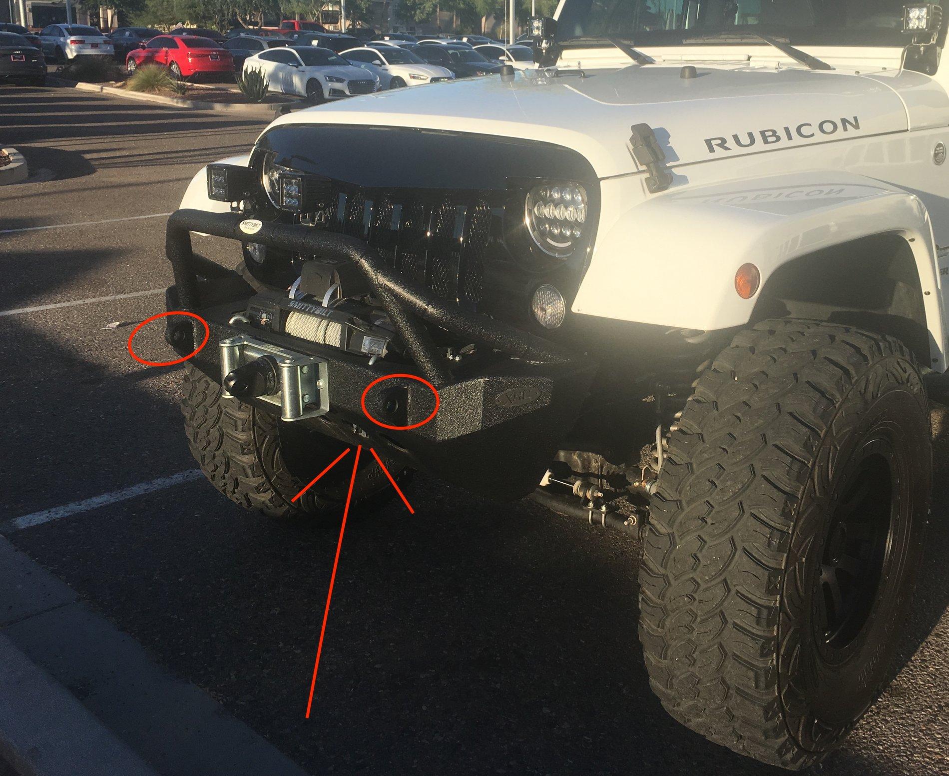

Simple answer is to get a bumper that you can tow from and ditch the base plate.
Thats what we did on a previous jeep. The problem you will find is many say "sure you can tow with our bumper..." till you find out you cant and the bumper fails, possibly causing damage to the vehicle, coach or both.
Over the years I only know of one brand and its Smittybuilt that welds and secures the bumper for towing. Their bumpers are heavier than most but they told me that they could winch straight up a wall using only the connection points on the bumpers and they could carry the full weight of the jeep. They told me thats how they do it on all their bumpers.
**** Disclaimer ---- There may be others, I just dont know any other brands. ****
We towed with a Blue Ox Avail 10,000 lb tow bar and straight attached it to the jeep bumper. We did have to replace the lugs to connect the Blue Ox up to the bumper. $215 just for the lugs on amazon.... feels like a rip off but cant be done with out it.
Then the install people ran the 7-pin wiring and the emergency cord thru holes in the lower part of the bumper and your done.... nothing that can be damaged, yet you can still tow it.
Hope this helps, good luck!
Edited.... I found some pictures of the Jeep I dont know what you can see but its all there.
The red circles show the connection points and the arrow is showing the break-away location, 7 pin is to the left but cant be seen. Click to make the pictures bigger.

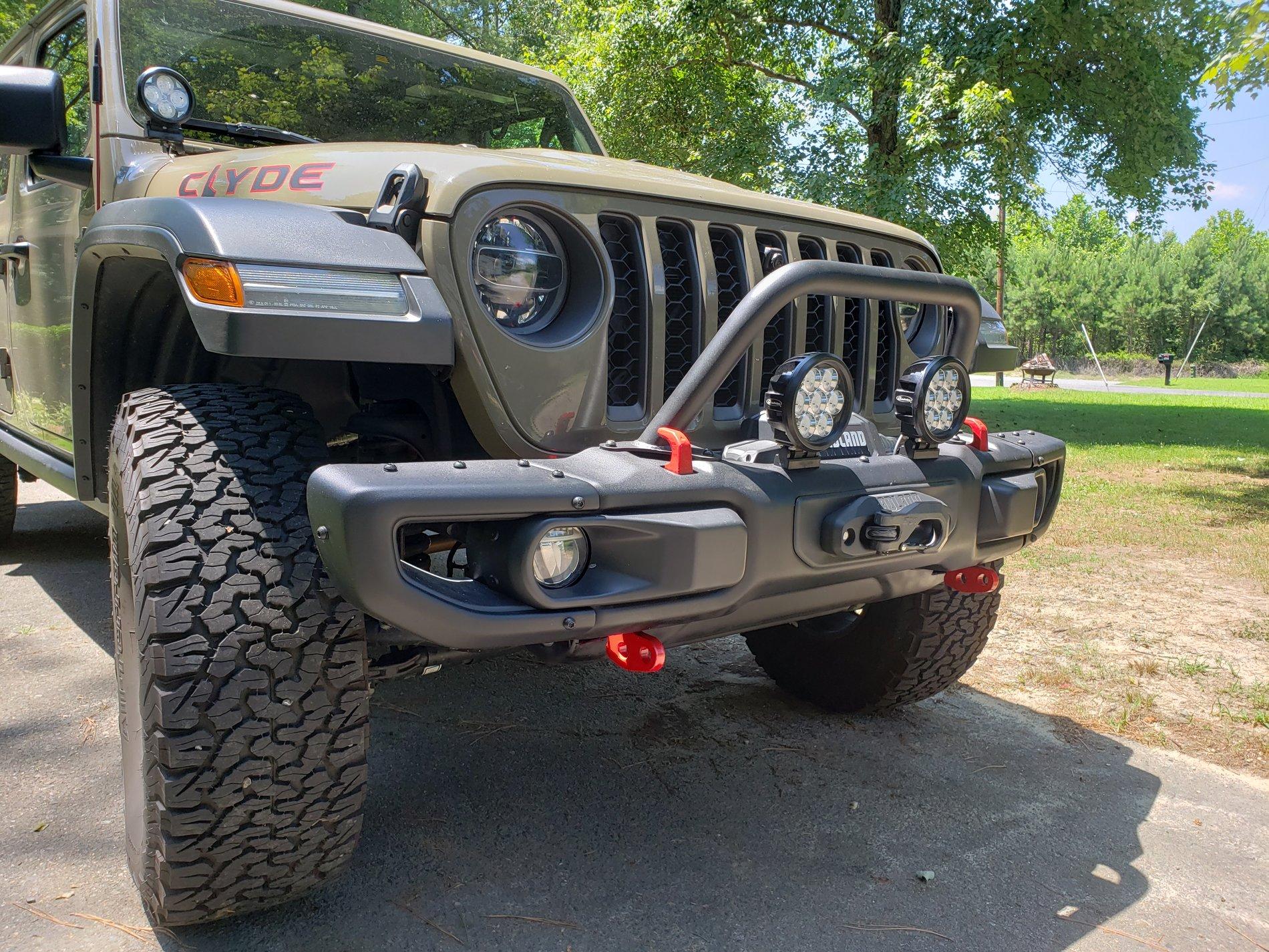

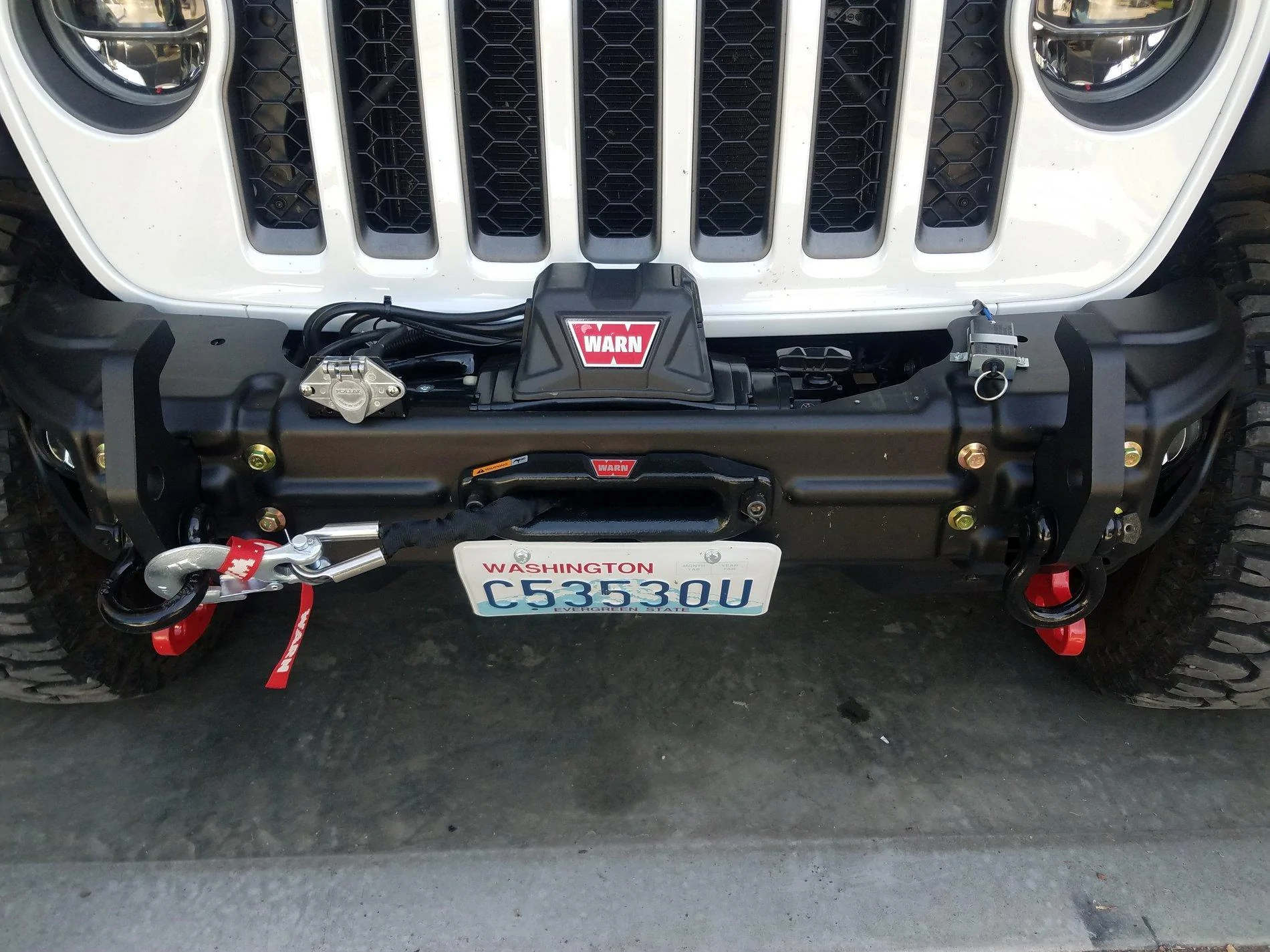

Maximus-3 tow bar mounts. Have them on the Gladiator.

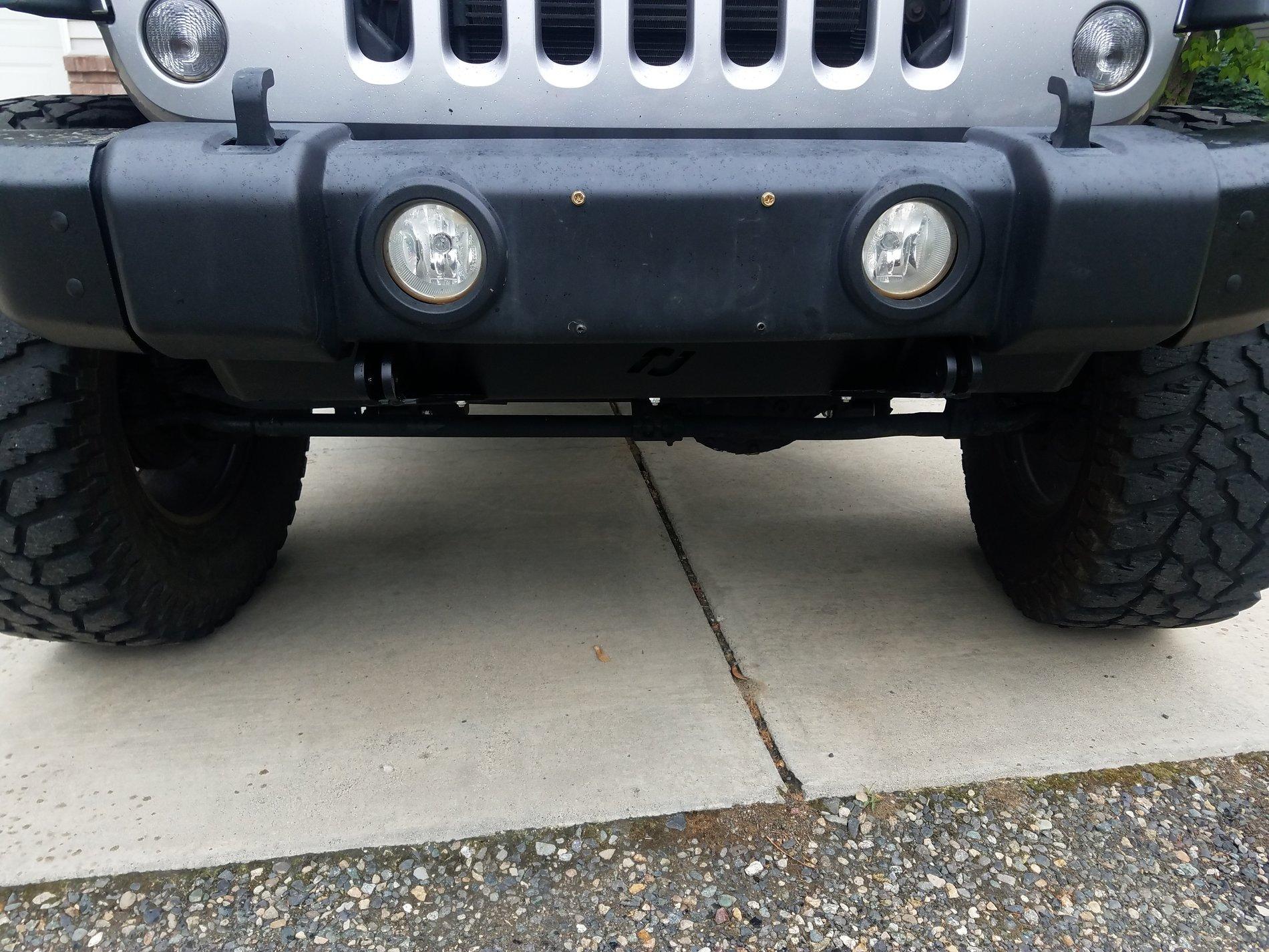

Currie Enterprises base plate/skid plate. Fits Blue Ox tow bars. Had it on my JK and it worked great. I would of put one on the Gladiator, but it was not available then.
It is now!

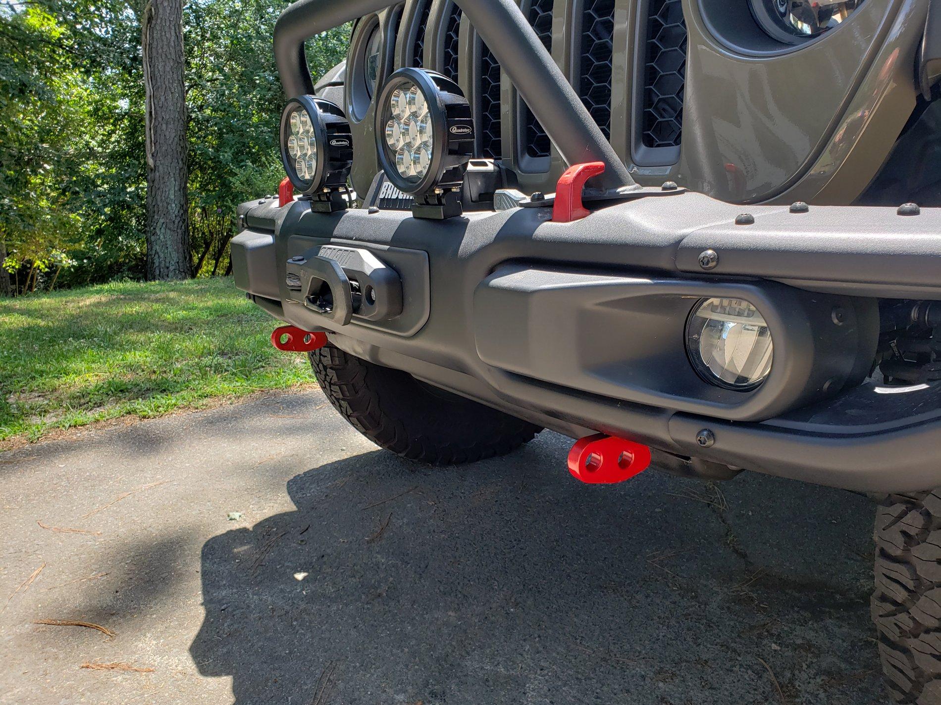

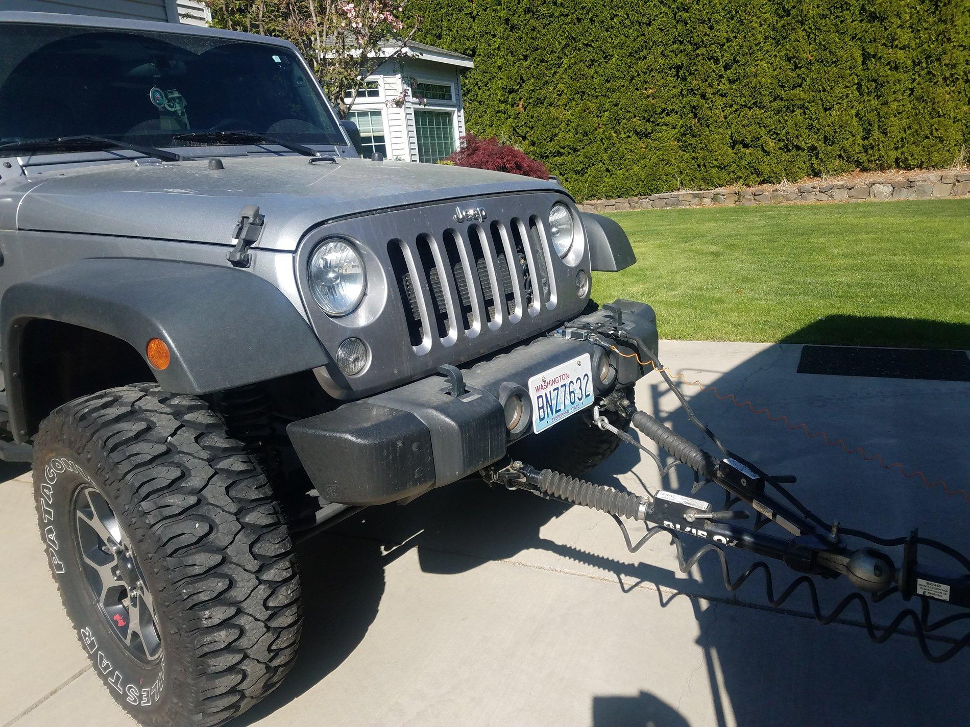

Maximus-3 tow bar loops on my Gladiator.
Jeep Gladiator Flat Towing and Rock Crawling, How do you protect your base plate? 20200724_162605
Currie tow bar mount skid plate on my JK.
Jeep Gladiator Flat Towing and Rock Crawling, How do you protect your base plate? 20190516_125053

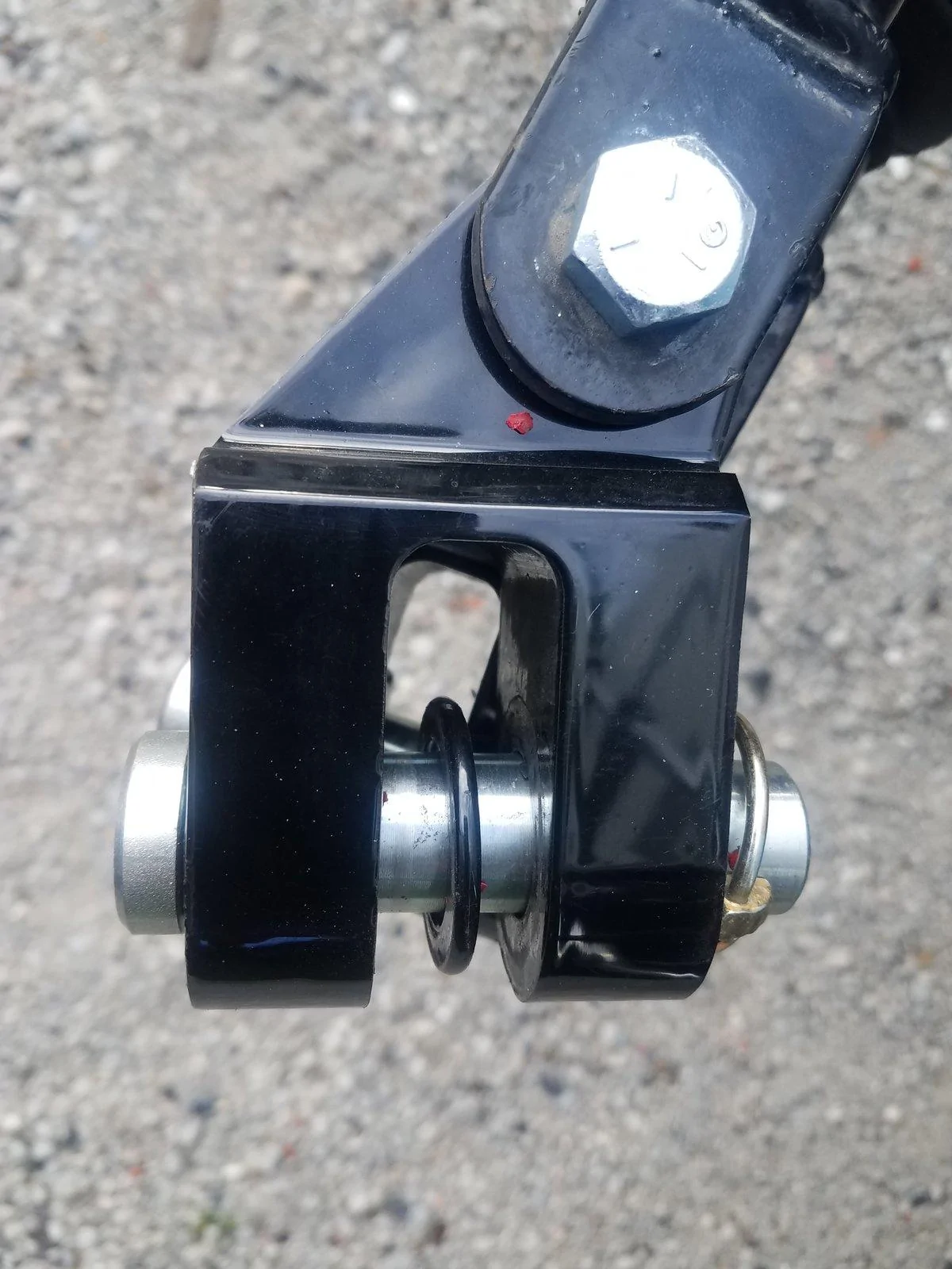

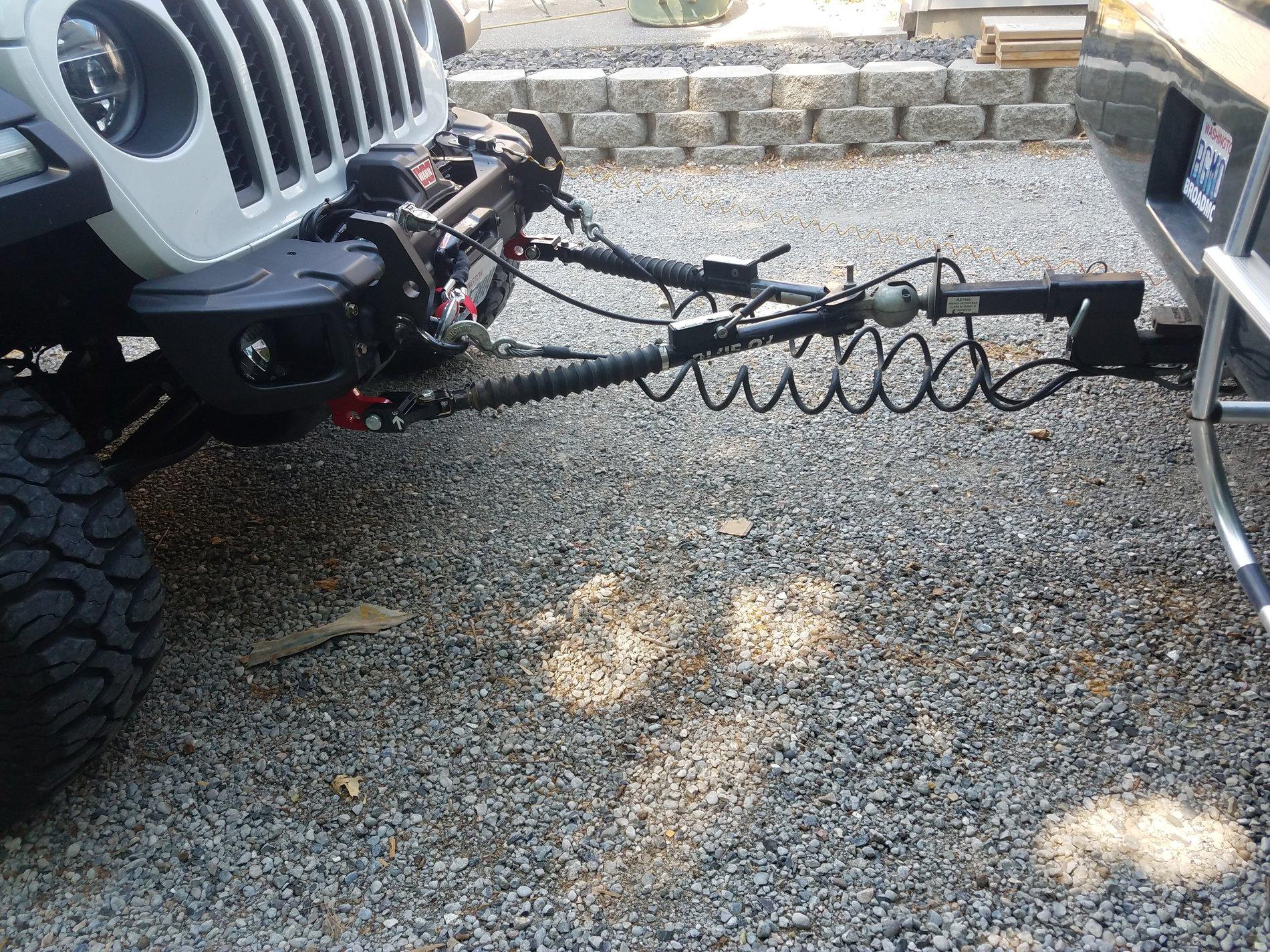

How does the Maximus-3 tow bar mount attach to the Blue Ox tow bar - do you have any pics of it connected? Also, how does the Currie base plate compare to the Blue Ox base plate as far as ground clearance? I'm trying to decide how I want to go.
I've also looked at the Rock Hard tow bar bracket kit, but I would need to replace the bumper to use them, and I really don't want to spend that much money!
I don't have it but it looks like you need these:
JL Tow loops
Adapter lugs
Had the Currie on the JK. Connects with standard Blue Ox towbar.
Have Maximus-3 tow loops on the JT. Had to swap ends with the adapters.
Jeep Gladiator Flat Towing and Rock Crawling, How do you protect your base plate? 20200802_184644
Jeep Gladiator Flat Towing and Rock Crawling, How do you protect your base plate? 20200731_124805
Jeep Gladiator Flat Towing and Rock Crawling, How do you protect your base plate? 20200501_094417

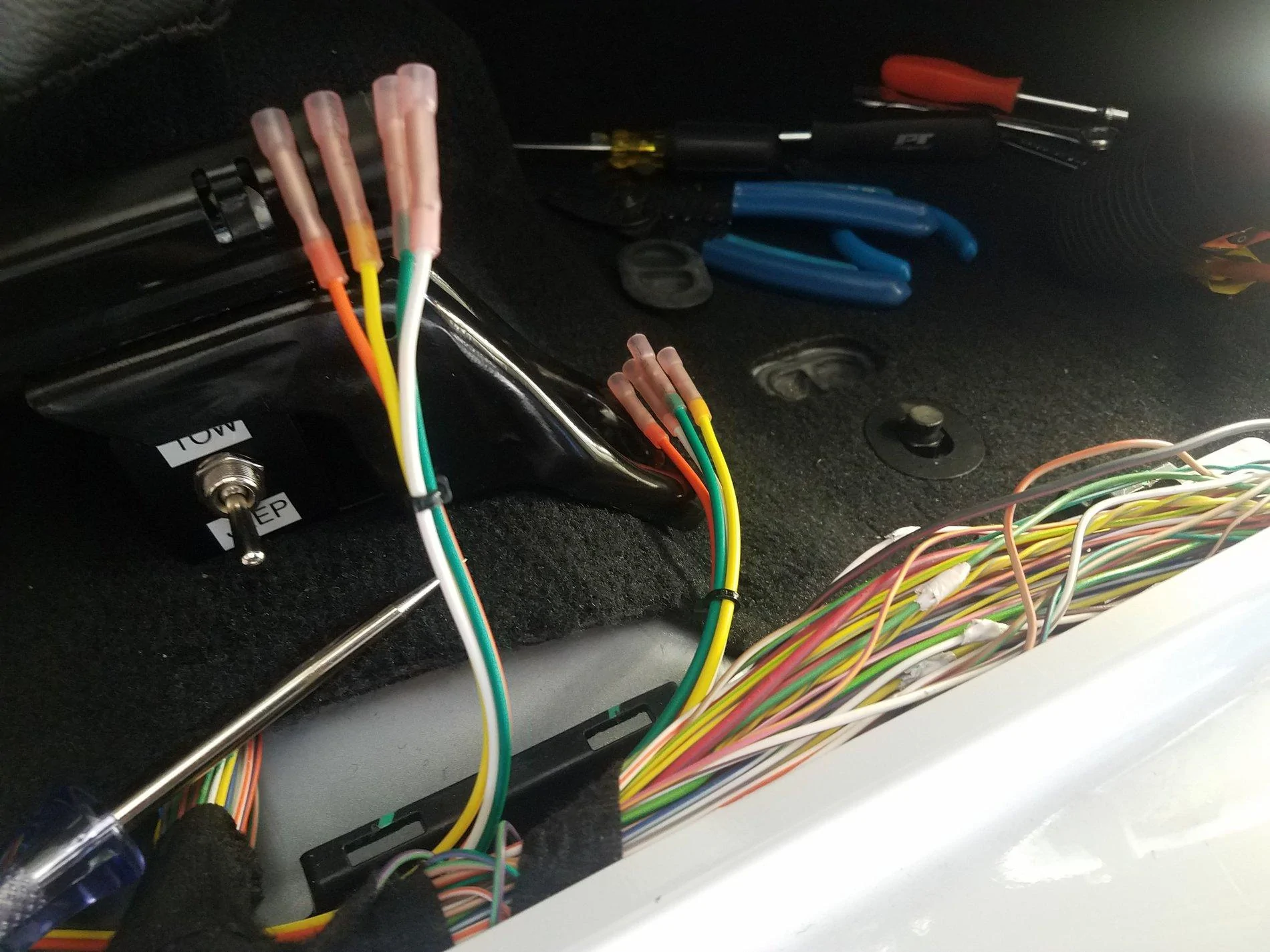

I would highly recommend the towed vehicle harness from Cooltech llc. Completely isolates the signal. Either from the Jeep, or the motorhome when towing. Fairly easy set up. My buddy saw my Cooltech light harness and returned his Mopar harness before installing. Both have been working flawlessly. Instructions are great, and install was fairly easy by myself. Find the 4 wires and splice in the isolation switch. I helped him install his, and it went even faster!
https://www.cooltechllc.com/2018-je...harness-kit.html#/69-jl_tow_harness_kit-basic

I've looked at this as well and ended up buying the diode kit, but the only thing I've done is run the 4-way wires to the driver's rear brake light cavity. I haven't cut into any wiring yet. How long is the 4-way wire whip that comes out of the control box? I like the way I have the 6-line plug setup already and think I would just splice the 4-wire that I have installed into the whip off of the cool-tech whip. Then, I am only making the simple cuts under the passenger seat like your video shows.
How do you have your aux brake setup?
The only wire routing is the main plug wire that goes from the grommet hole under the seat to the front of the Jeep. Wire grommet included! The old JK Hopkins kit, I had to run wires from the tail lights all the way to the front.
For braking, I chose the RVi3 system. I knew I would be upgrading toads in the near future, and I also have a gasser (no air brakes). It's worked great in both Jeeps. I ran the breakaway wire, and a 12v battery direct outlet through a plastic plug and hole in the firewall on the driver's side. Easy peasy.
