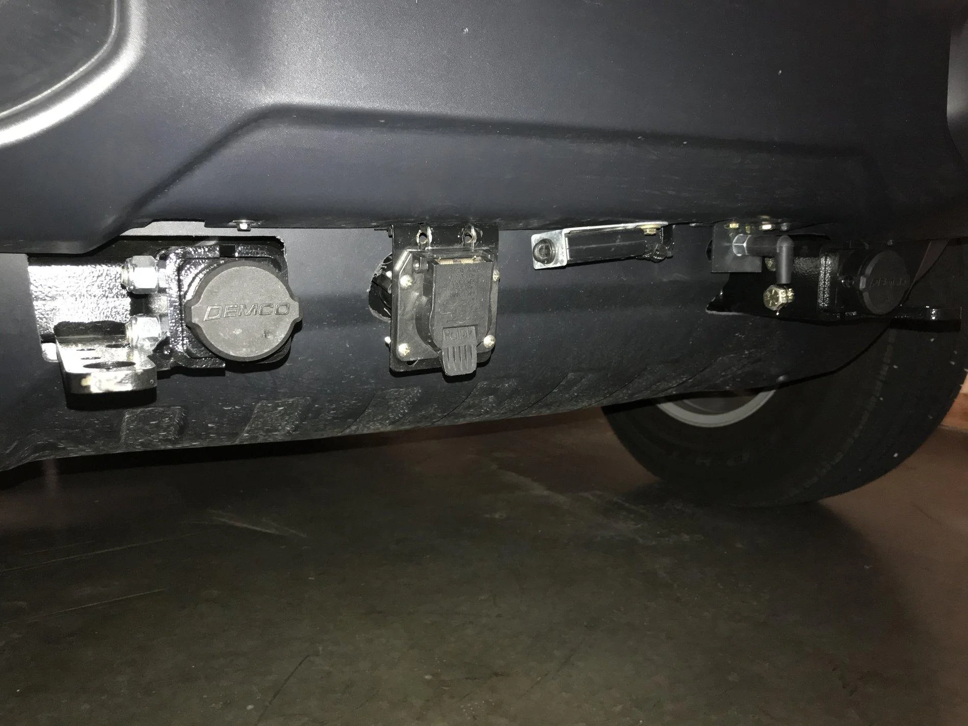

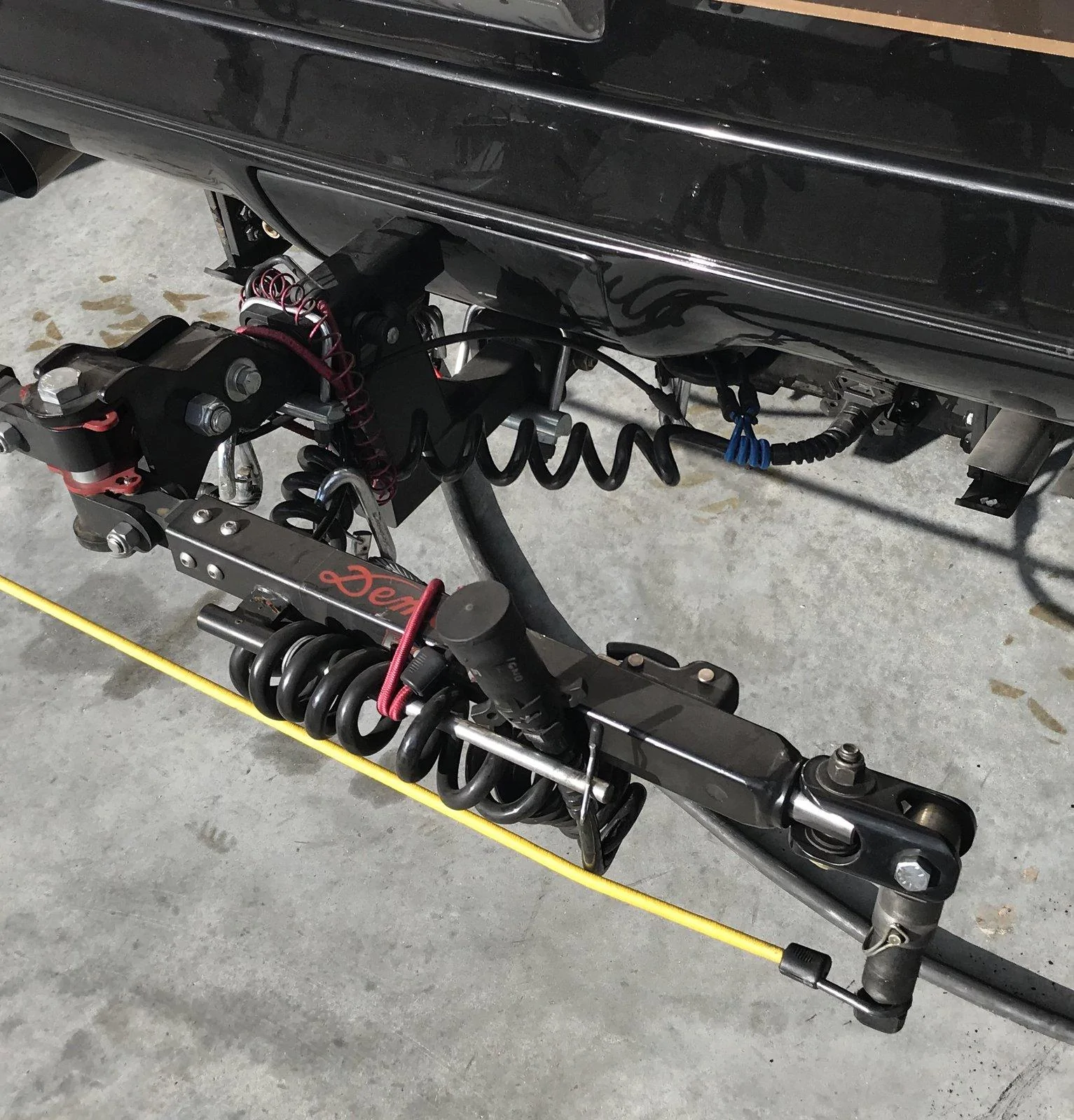

I bought a long male/male seven pin coiled cord. I leave it attached to the tow bar/coach.
Jeep Gladiator Flat Towing Setup B0D327A5-0169-4C59-8436-87DA8FE8A6CB
I mounted a female seven pin receptacle on the Jeep. You can also see the breakaway switch and M&G air fitting. It has a spark plug boot on it to protect and vent the fitting.

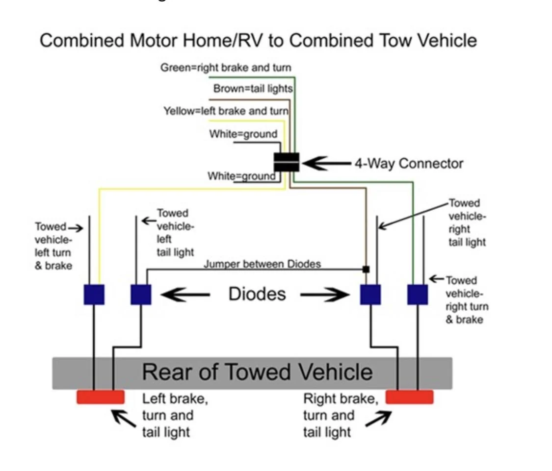

this kits super easy to install. Just splice 4 wires and run your harness up to your front bumper. If your going this route be sure to pack diode grease into your connections. Found that out the hard way on a f150.
Thanks in advance if you know the colors of the 4 wires above.
Jeep Gladiator Flat Towing Setup DEE525DC-F189-4F44-A593-7A74CD51940C

^ I can't comment on the Roadmaster diodes above, but I currently use the Hopkin's kit on my JK. It works so well, and they now make one for the JT, it is probably what I will use when I get it.
