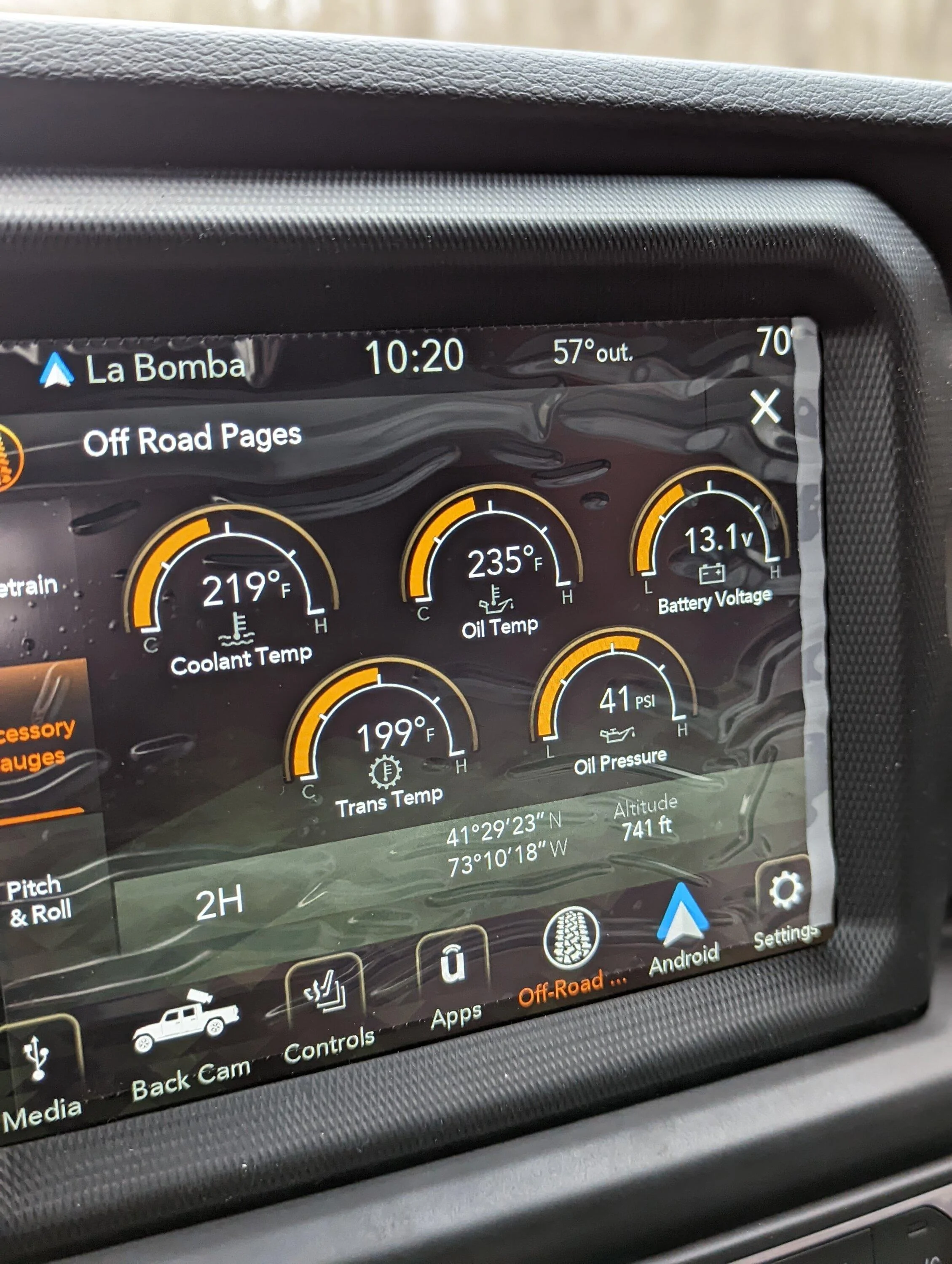

22EcoDs

Your temps look fine to me. These were mine towing a uhaul car trailer with car on it up a grade.
Jeep Gladiator Fluids temperature norms PXL_20220416_142100750.PORTRAIT
Thanks for the screen shot. I see your outside air temperatures are 57*. Do you think your temperatures would be higher with higher outside air temperatures?
Your oil temperatures are somewhat elevated. Do you know how much weight you were towing?

I'm not sure yet what your concern is. Your temperatures in the first post were well under any areas of concern, you weren't even close.
As far as parts in common, yes, but that's not a problem - it's because for transmissions the temperatures would all run the same, for oil - similar - oil temperatures would be comparable, and so on.
What is your specific concern? From what I see so far, there isn't any.
At least not now.
There have been multiple threads on the operating temperatures of the diesel in these - with a lot of images showing the various temperatures.
Unless you see things a whole lot higher in higher ambient temps, yours is running cool at this point.
That's not really elevated, especially not for towing. He's got a ways to go before there's any concern, especially is he's using a good quality oil with a high thermal breakdown temperature.
Yea I should have gotten a shot of my scanguage with turbo outlet temp, it was over 1100 for most the hill pass. I did not have a derate issue. It was ~5400ibs car and trailer. I plan on towing this summer and will see if the numbers change. Physics wise, yes I do think they would be higher with ambient temps.

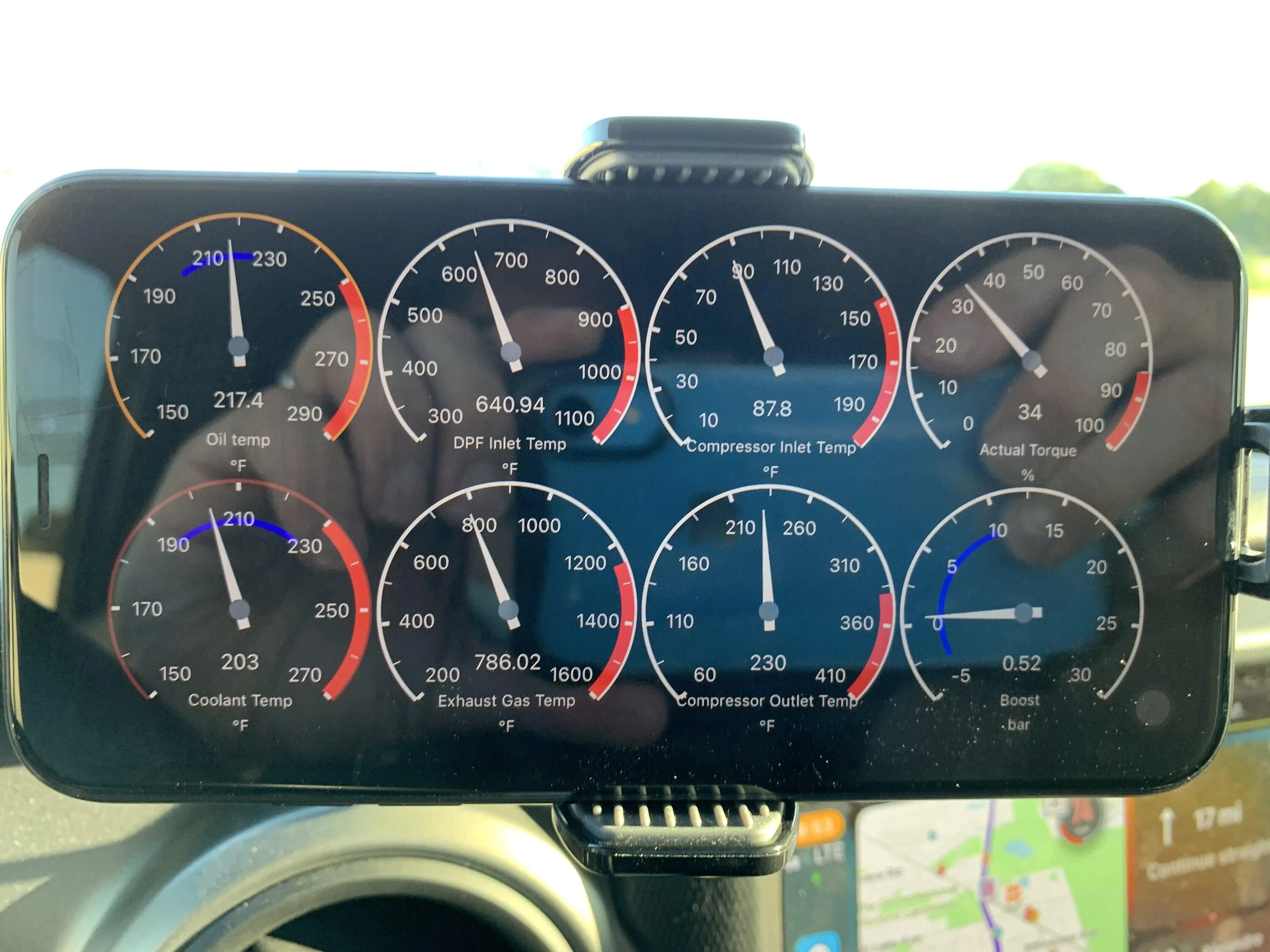

Been consistently in the 80s and some 90s the past week and a half, typically I’ve seen low 220s on oil temps. The pic below was today at 88 degrees ambient after driving on the interstate for about an hour. Was fluctuating between 217 to 220 oil temp but the wind was fairly mellow, so the engine was hardly working, at 70-75mph I was averaging 30mpg which is higher than normal.
Jeep Gladiator Fluids temperature norms 51EFA35F-8F50-4BA5-9EAD-43B8FD8626C9
