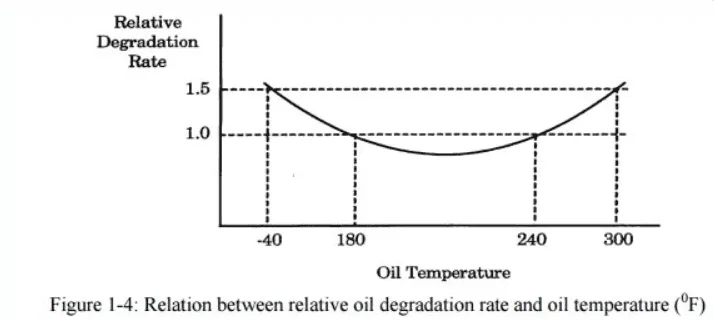

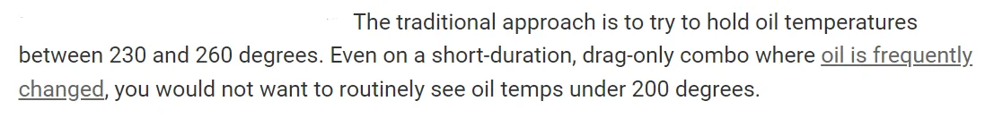

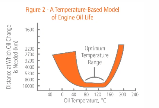

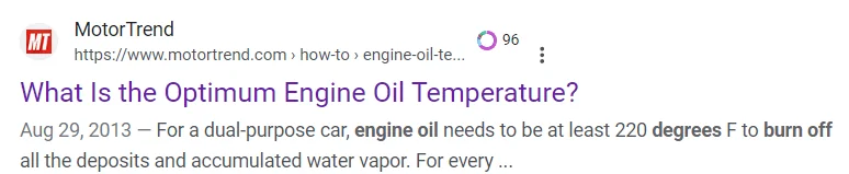

People get all freaked out when they can see numbers instead of a gauge with green and red, and they listen to the fear mongering about what's too hot and what's best.
They have no idea that for decades, engine temperatures have been running in the 220 range with oil in that range as well. This is a thread on normal fluid temperatures, so maybe some facts instead of fear mongering and "I don't like it that high" without and facts behind them.
I have the facts.
250
40,600
54,286
Jeep Gladiator Fluids temperature norms Screenshot 2024-02-11 163435
ideal oil temperatures to avoid acid built-up, to remove moisture and fuel contamination.
Ideal seems to be around 100 (C) and is fine clear up to 120 (C) and up to about 130 (C)
That translates to oil temperatures of 200-230 being ideal.
More than that, you need to keep the temperatures up for a period of time. Getting it up to 100 for 2 minutes then parking it isn't going to help the oil or engine any.
Anyone with a 4xe is familiar with FORM - too bad they can't force that on a gasser - the things would last a heck of a lot longer if you were forced to get the oil hot and keep it there for a few minutes.
Short drives and low oil temperatures suck. They kill engines, build up acids and sludge.
