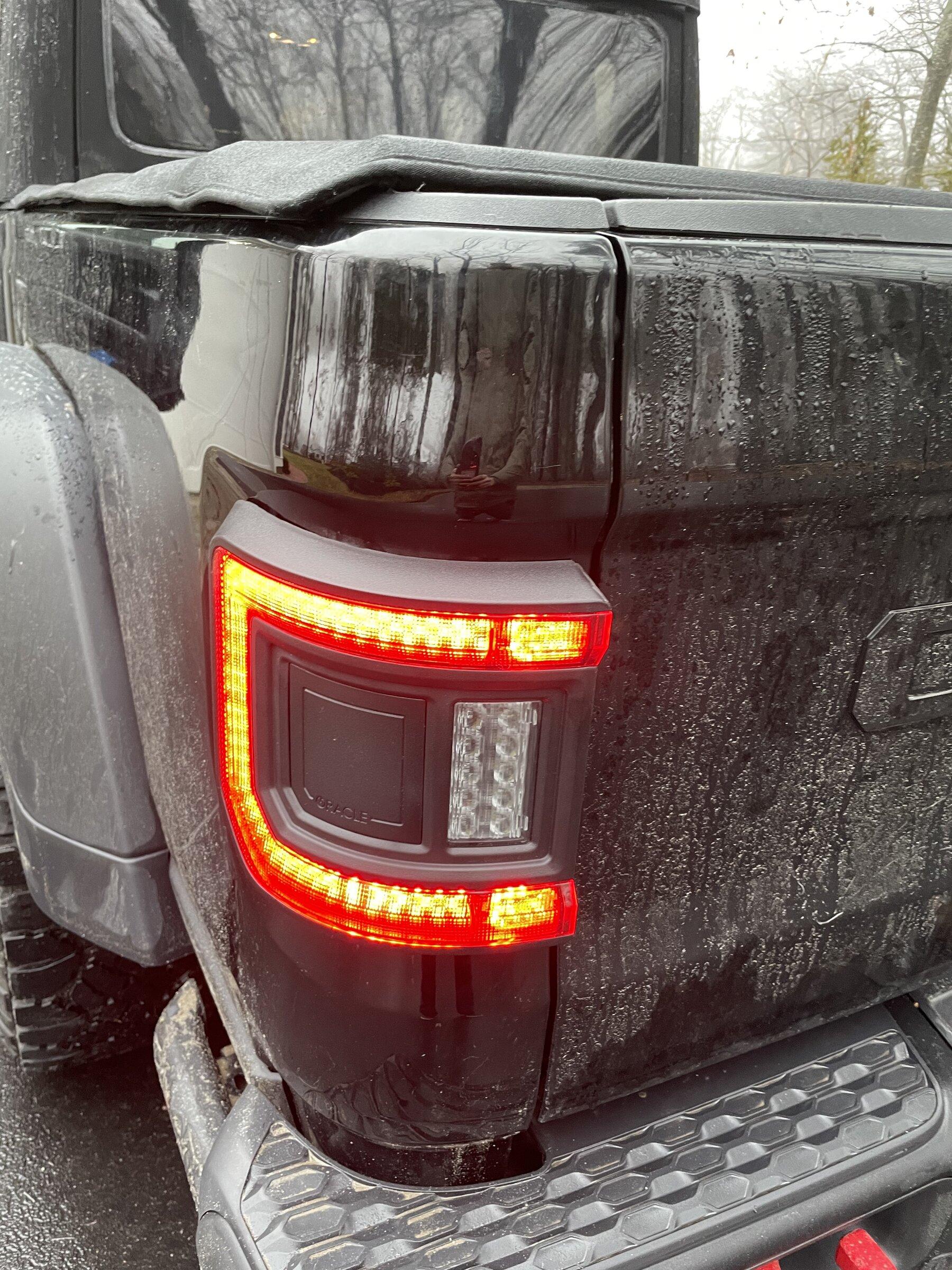

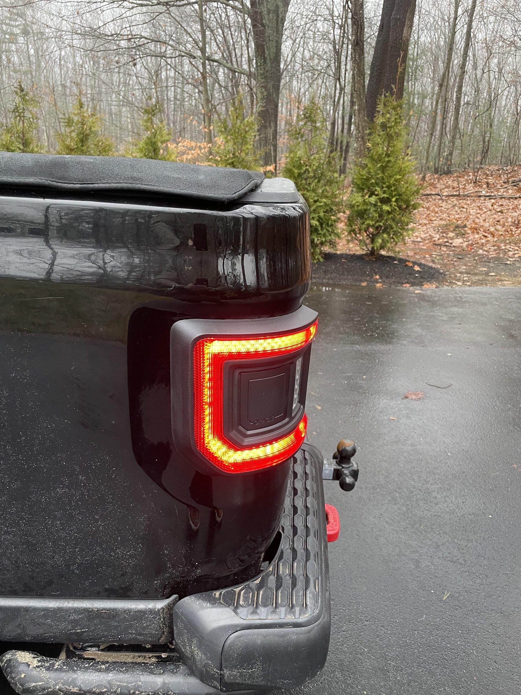

Okay, so I wish Lumens would have tested these lights a little more and I am sure there will eventually be a fix. However, I have to say these lights look fantastic on my Black 2020 JTR. I purchased these in the group buy and love them. I have LED package and the only thing that is not correct is that the blinker “blinkes” too fast. Pictures coming soon. Long Live TB12. The only true GOAT mode ???

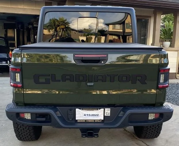

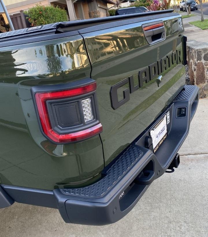

Finally got my Tail lights with the bumper reverse lights. Ordered these on October 15th. Received in the mail February 15th. I had no problems with installation, all lights worked perfectly with no errors. I was worried about gaps between the body and for me I had none, I pushed on the light while someone else synched it up. Everything works and fits perfectly. I say the 4 months wait was worth it.
Jeep Gladiator Flush Mount LED Tail Lights for Jeep JT | Group Buy Pre-Order thumbnail_IMG_8720
Jeep Gladiator Flush Mount LED Tail Lights for Jeep JT | Group Buy Pre-Order thumbnail_IMG_8725

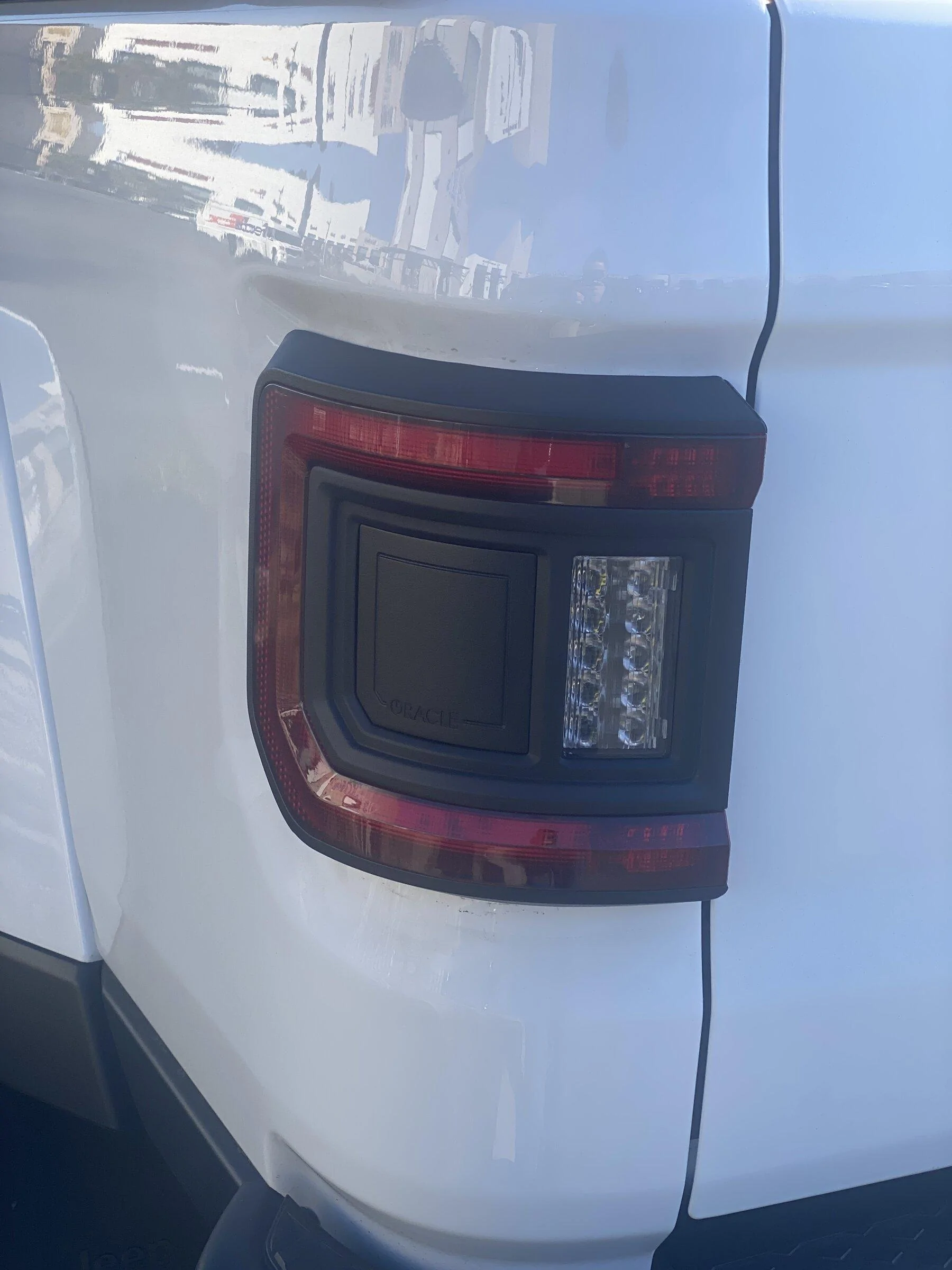

My Oracle flush mounts finally arrived.
Advice on getting these to fit without a gap. Before screwing these down, really push these things home until they seat and when you think they are fully seated push them even further.
Jeep Gladiator Flush Mount LED Tail Lights for Jeep JT | Group Buy Pre-Order IMG_1300
