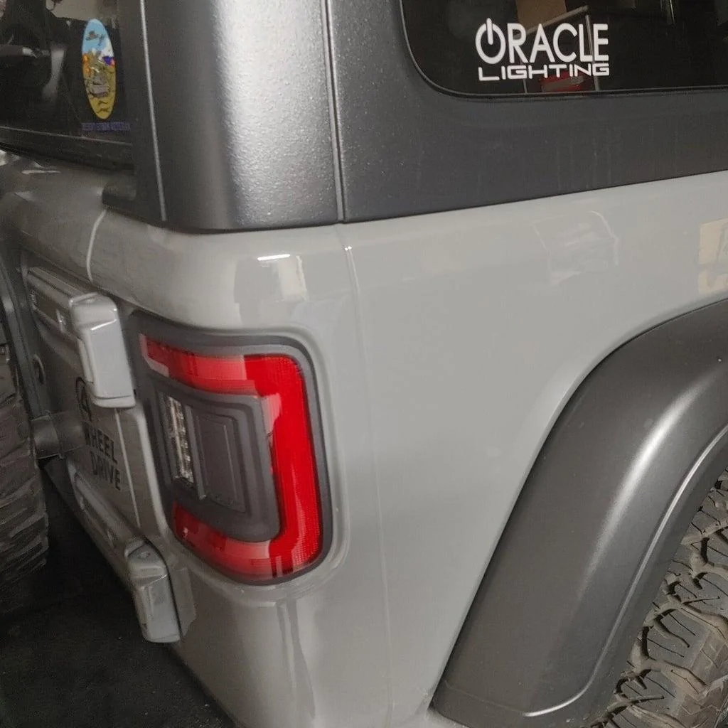

Hey Everyone!
At the moment, we have a confirmed working solution we'd like to offer those of you who:
  • Have a Halogen equipped Jeep
  • Have the Flush Mount Tail-Lights installed
  • Are experiencing the Reverse Light strobing or shutting down
This solution involves tapping in a small resistor to the reverse light wires on each tail-light. The wires are pictured here:
We will be happy to ship the parts needed to do this for anyone who has already installed the tail-lights and are experiencing this issue. Anyone who has not yet received the tail-lights, please install them first and confirm the issue occurs before requesting these parts, as it does not occur on every Jeep.
To request these parts, simply complete this form: https://forms.gle/amY935MWuiuGp7Gv8
Once this form is filled out, one of our customer support reps will get the parts shipped to you right away.
NOTE: Currently, this solution only applies to users with Factory Halogen Equipped Jeeps. We are still working on a non-programmer solution for signal out error for Factory LED Equipped Jeeps.
Complete this form to get on the waiting list for that:
https://forms.gle/BzUYkNamRzWuybqc9
**Please do not DM this parts request on the forum**

People coming from halogens are having worse problems than those coming from LEDs in some cases in regards to the built in reverse lights not working. The resistors are only for the taillights. To my knowledge, the only issue LED users have had are a hyper-flashing dash turn signal indicator (even though the turn signals flash at normal speed) and a tail light out warning. The current solution is to use a programmer like tazer or jscan to tell the computer to ignore any check for expected load in the taillight circuit thereby bypassing the taillight out and hyperflash issue.
So is this holding true? I have factory LED's and a local forum member with these lights who would like to trade for my factory LED's. I'm obviously hesitant given the issues lamented about here, but I am interested.
MrFahrenheit
Jan 6, 2020
478
792
Arizona
2020 FC Red Gladiator Rubicon
Yes, this is still the case. Oracle says they are very close to having a non programmer solution for Factory LED equipped JT's.
Basically, the breakdown of the issues are:
NON Factory LED JTs:
- Reverse Lights non functional/flashing. Oracle has a separate wiring harness that you install in line with the lights to resolve this. It's my understanding this harness is not included with the lights and must be requested from Oracle if you have the problem. It's not clear to me if this uses factory style connections or requires manually splicing in them but I believe it's the latter.
All other functions work as expected. There are two options for installing:
1) using an included resistor for the taillights and making no changes with a programmer
2) using a programmer to change the taillights from regular to LED and NOT installing the included resistor.
The resistor included with the taillights is NOT for the reverse lights and has no relation to the reverse lights working or not.
Factory LED JTs:
- Taillight bulb out warning on dash and hyper-flashing dash turn signal indicator. The actual turn signals themselves flash at a normal speed. There is no solution for this other than using a programmer at this time (JSCAN/Tazer). The programmer solution turns off the diagnostic settings for the tail lights which prevents the bulb out warning (by way of bypassing the ability for the Jeep to tell you if the tail lights are out) and hyper-flashing.
All other functions work as expected. You do NOT use the included resistor when installing these in a Factory LED JT.
When using in conjunction with Oracle Bumper Reverse Lights:
There were some issues reported in this thread about using these tail lights if you have their bumper reverse lights as well. This was causing some problems with the taillight reverse lights not working and it's my understanding the solution for this was to not have the bumper reverse lights connected into the factory tail light wiring but instead to tap the bumper reverse lights into the trailer wiring instead.
