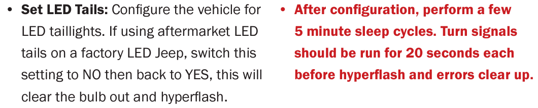

Shout out to the USPS for delivering mine a day early. I did just have a thought though. I have factory LEDs and a Taser. Seems like most of the problems are coming from factory LEDs while halogens with the resistors are working fine. Would installing with resistors and setting my truck to halogen be solution for any issues I might have, @JP_Oracle ?
People coming from halogens are having worse problems than those coming from LEDs in some cases in regards to the built in reverse lights not working. The resistors are only for the taillights. To my knowledge, the only issue LED users have had are a hyper-flashing dash turn signal indicator (even though the turn signals flash at normal speed) and a tail light out warning. The current solution is to use a programmer like tazer or jscan to tell the computer to ignore any check for expected load in the taillight circuit thereby bypassing the taillight out and hyperflash issue.
Use this setting in the Tazer - You will have no issues - No resistor for this

Just got done with the install. Busted a couple knuckles open disconnecting the harness from OEM lights. The 6 month wait was worth it, I love these things! If you work with it as instructed repositioning and retightening the screws the fit is pretty damn close to OEM.
Prior to install I used the Taser to switch rears to halogen, reboot, sleep cycle x 2, changed it back to LED, reboot, sleep cycle x 2. No hyper flash and reverse lights are working (but I'll keep an eye on those in the coming weeks).
