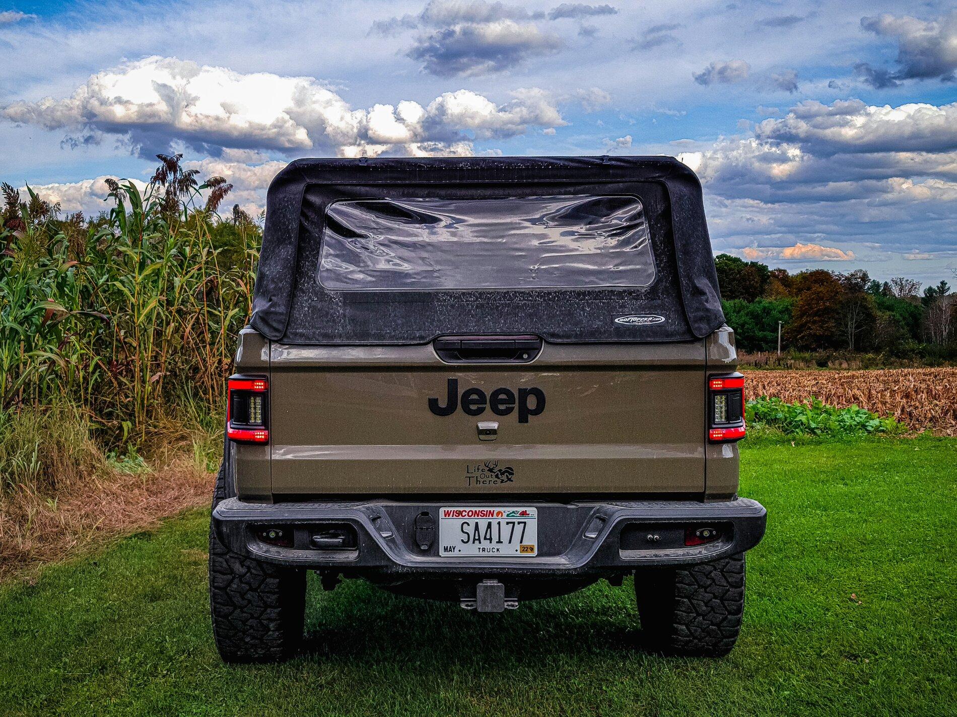

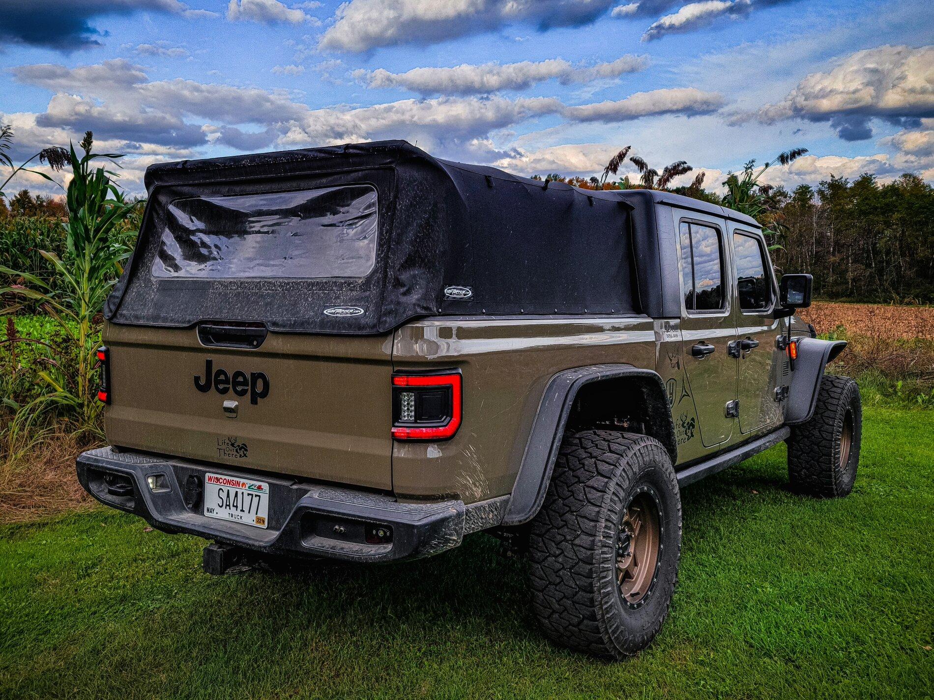

I received my lights and installed on Friday, without any major issues...I'm running a Sport S that came with halogens, but I swapped out the bulbs for LEDs and have the Tazer.
Since I have the Tazer and set to LED, I did not use the resistor, and these lights seem to be running fine at this time.
I felt I received a decent fit by pushing/rotating the lights slightly away from the Jeep while the "front pins" were lined up, this allowed me to "seat" the pins/lights deeper before fastening in place with the screws...I don't have a great way of explaining that, sorry!
Regardless, here is a quick video showing the functionality of the lights on my truck - with the lights off, and with the parking/running lights on.
Oracle Flush Mount Taillights - JT Functionality
The forum wouldn't allow me to embed the video in this post directly, so the YouTube clip will have to work if anyone wanted to see a little video.
