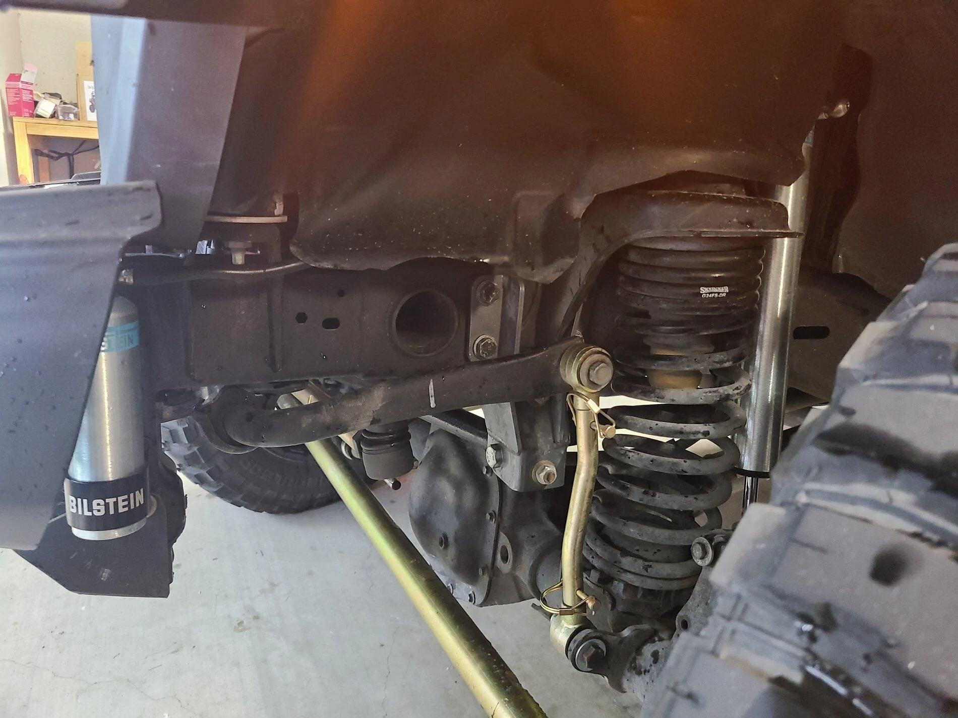

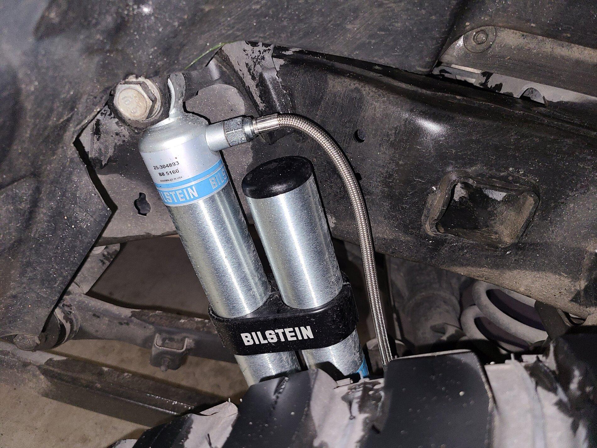

I went with the Bilstein B8 5160 remote reservoir shocks. They are $250 each compared to $350-$450 for the Fox and Falcon. I only ran the factory Sport S shocks for 700 miles, then I installed the 3.5" Skyjacker lift and their M95 monotube shocks. They were pretty nice but these Bilsteins are definitely a step up.
