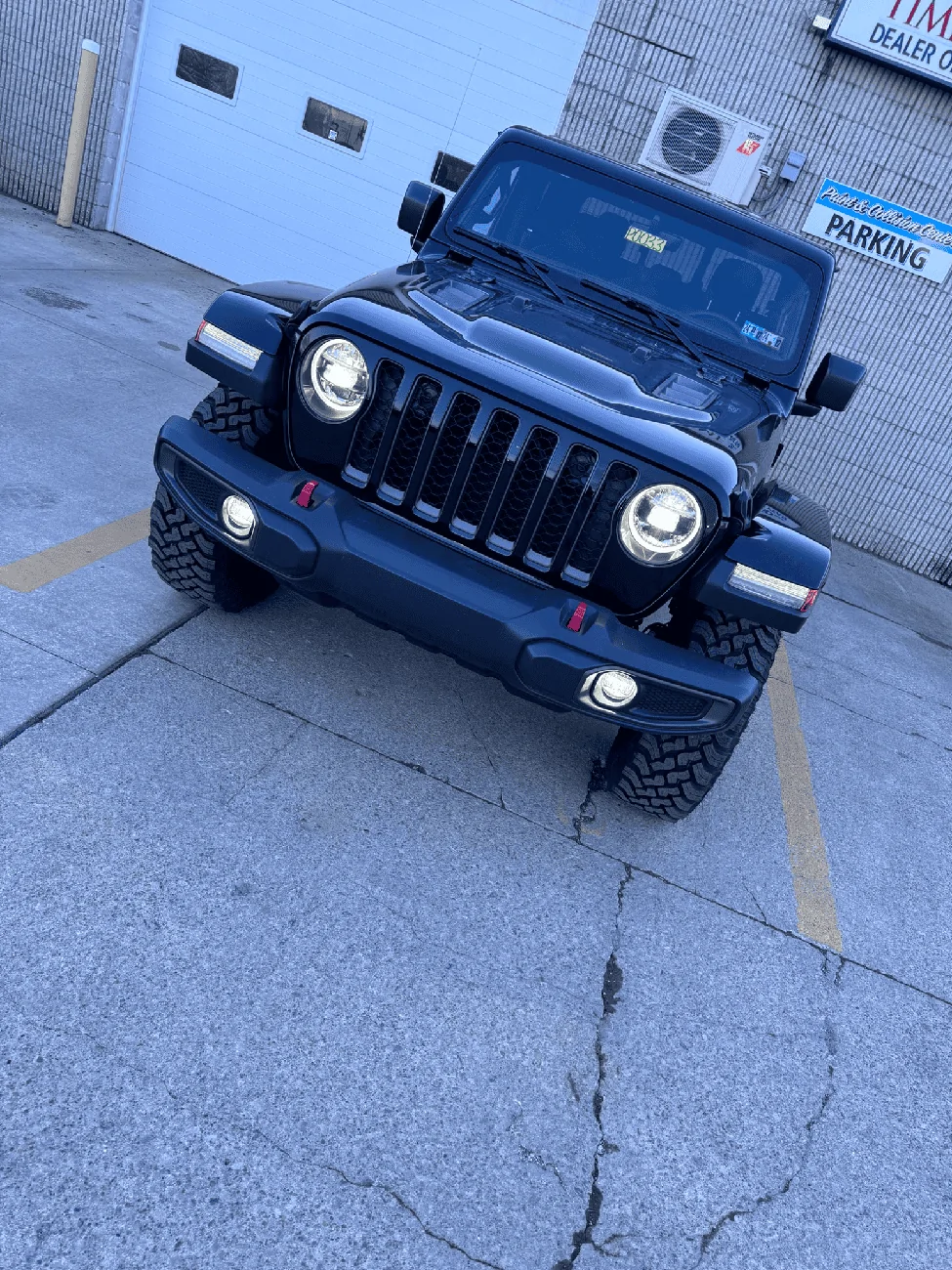

If your wife's JLU has a Steel 3 piece front bumper like the Rubicon, it won't work. My wife has the plastic bumper like the one that came on the Gladiator.
All the mounts should be there to mount a Mojave skid plate, but you would need to use a plastic bumper, aftermarket like the Rival (I am going to buy them for my wife's JLU and My Mojave) or grind some parts of the stock steel bumper where the skid plates hit it ..
Note if your JLU came with a plastic front bumper you will have to buy the mounts and crush nuts, they actually sell a kit with everything.
I had to buy the brackets and crush nuts for my wife's. But I had to buy them anyway because I was putting my Mojave shocks on her JLU... Rides great now!
