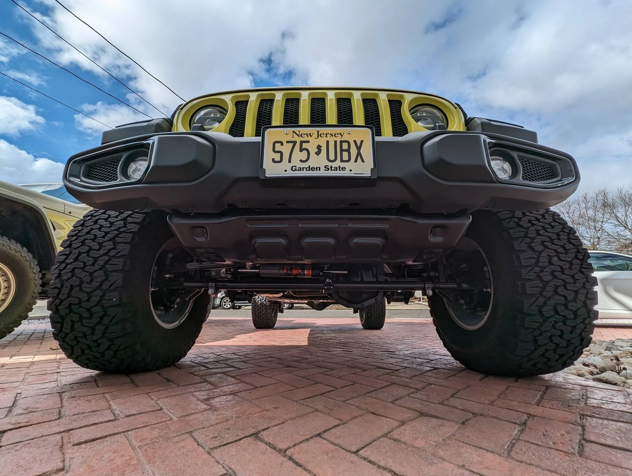

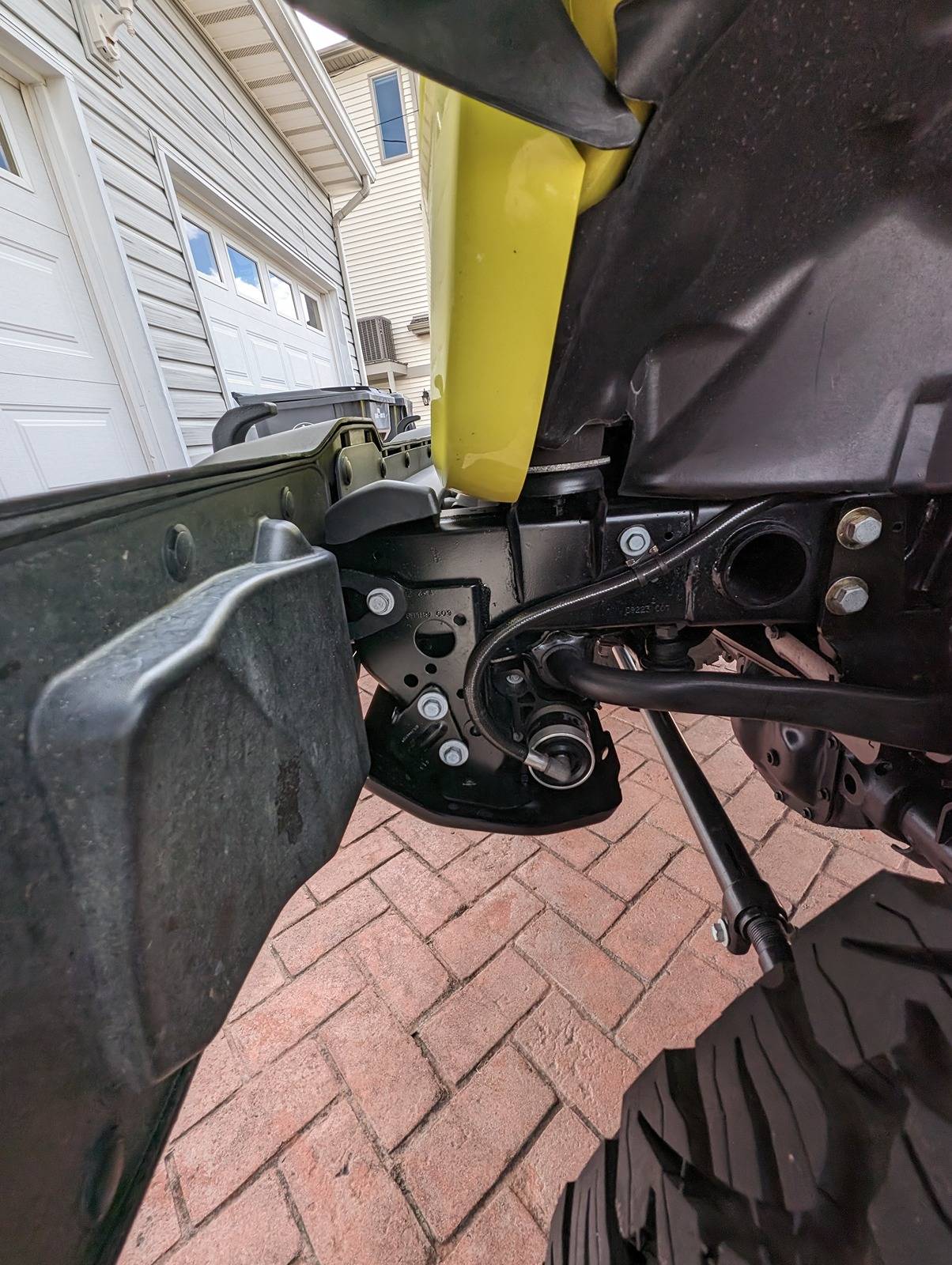

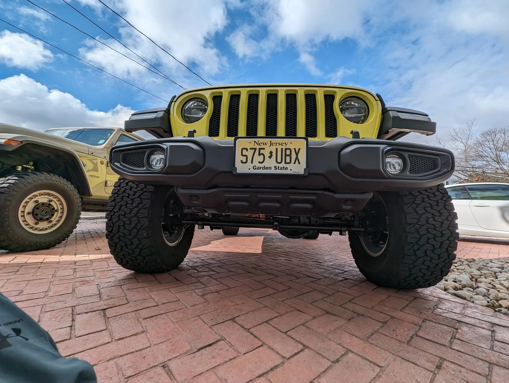

If your wife's JLU has a Steel 3 piece front bumper like the Rubicon, it won't work. My wife has the plastic bumper like the one that came on the Gladiator.
All the mounts should be there to mount a Mojave skid plate, but you would need to use a plastic bumper, aftermarket like the Rival (I am going to buy them for my wife's JLU and My Mojave) or grind some parts of the stock steel bumper where the skid plates hit it ..
Note if your JLU came with a plastic front bumper you will have to buy the mounts and crush nuts, they actually sell a kit with everything.
I had to buy the brackets and crush nuts for my wife's. But I had to buy them anyway because I was putting my Mojave shocks on her JLU... Rides great now!
Thank you for the reply. My wife has the Mopar 3 piece steel bumper taken off a Rubicon. Now that I wrote that I remember attempting to install the Gladiator Rubicon stock skid plate that came on my JTR with plastic bumper and it wouldn't fit. The Mojave silver skid is the same skid on the Rubicon.
dayusmc
Mar 6, 2023
60
969
698
Jersey Shore
2020 Gobi Mojave & 2022 JLU High-Tide
Retired Marine
No the Mojave skid plate is different than the Steel Rubicon skid plate. You need a Rubicon skid plate and the bolt kit and it will bolt right up, that is what I did to my Mojave.
The Mojave skid plate doesn't bolt to the bumper, the Rubicon steel skid plate does ...
Let me clarify as this has been debated many times on here.
The JTR comes stock with plastic front bumper and a steel skid plate, painted black. I have one.
The JTM comes stock with plastic front bumper and a steel skid plate, painted silver. I have one of these too. These two skid plates are exactly the same. Only the paint is different. Neither will bolt to a Mopar steel bumper without modification.
The Mopar 3 piece steel bumper requires a different skid plate on either a JT or JL, one that bolts to the bottom of the bumper and is bigger. I think the wrong information gets out because some people call the Mopar 3 piece steel bumper a Rubicon steel bumper.
Sorry, I meant the JLU Rubicon with steel front bumper with steel skid plate.
But good to know that the JT Rubicon comes with the same skid plate in black, that saves me from having to paint it!

I definitely prefer the Mojave steel skid plate over the steel skid plate for the steel 3 piece bumper. I put that on my Mojave, now I want to go back to the Mojave one, it looks meaner ..
