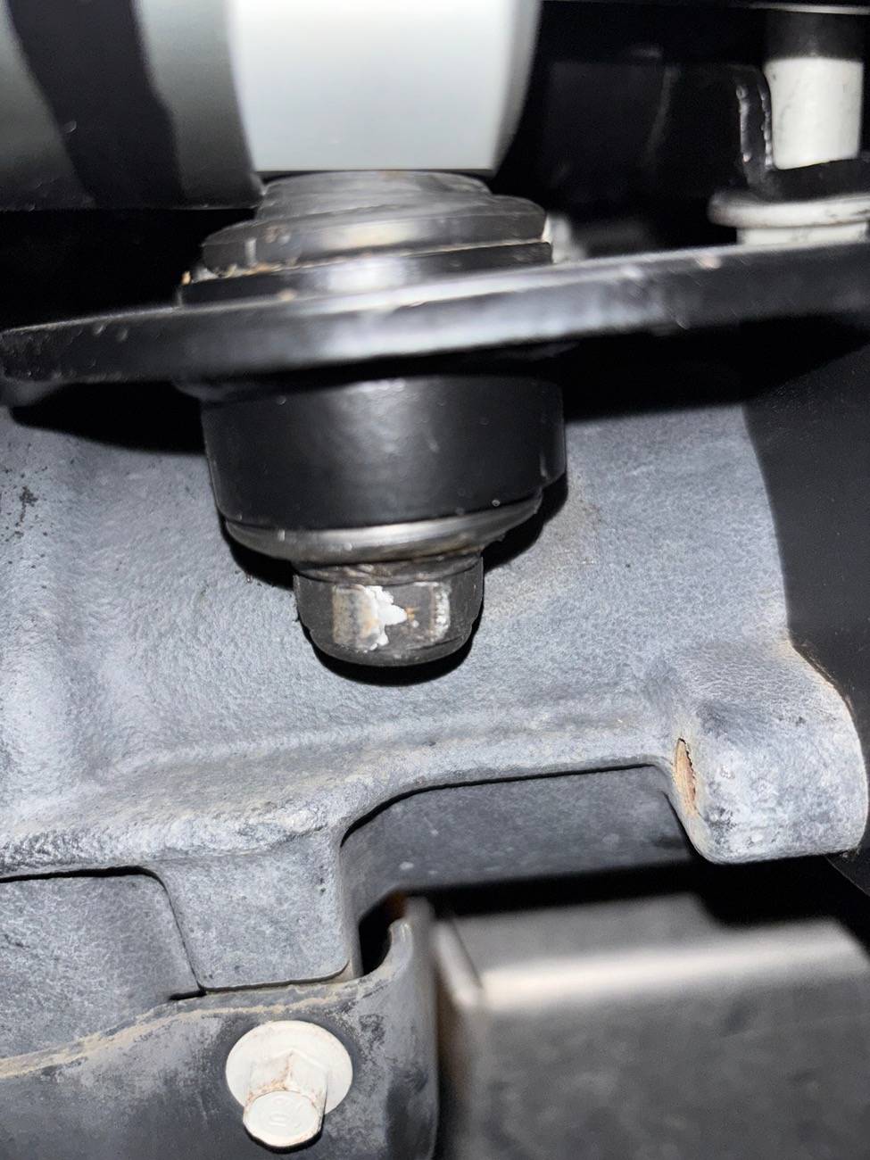

Long story short I went to a highly recommended specialty off road shop to diagnose and fix death wobble. Shop was a hour and a half each way trip. I purchased a steer smart drag link and steer smart track bar from the shop. I also brought in a falcon steering stabilizer new in box that I purchased online. I wanted to wait until the death wobble was addressed before adding the new stabilizer.
Shop installed all three items. The owner is an awesome guy but never once left our conversation to check on the work being done. I mentioned the stabilizer had very specific install directions included in the box as I was concerned about the toque specs.
After the trip home(death wobble free). I decided to check out my new parts. First thing I see is a nut on the back of the stabilizer that has obviously been beat to death with an impact gun. The instructions called for 40 ft/lbs. So I assume all installed parts were also beat to death with an impact gun. The whole reason to search out a specialty shop is for this very reason. I assumed I was paying a shop that had some sort of attention to detail.

If it was beat to death with an impact I'd expect to see all the corners of the nut rounded off the same. What I'm seeing there is the classic telltale mark of a slightly too large open end wrench (or crows foot) that's slipped past to the next flat while being torqued. There's a decent enough chance that they may have tried to torque it to spec, they just used the wrong size tool.

This is the first time I did not install items myself. Everything in my signature I have installed in my driveway except for todays additions. I bought the steer smart items from the shop and figured might as well have them install while I was there. With the purchase they were happy to also install the stabilizer. Just grumpy in my old age I guess. I suppose what the shop did would not be a large issue, but its on my mind enough that I'm going to uninstall/reinstall the new parts this weekend. Hopefully the over torque has not permanently damaged anything.
I think what happened is the tech tried to toque that nut down after installing the stabilizer. He probably did not have enough room to get square on the nut.
Instructions were to install the stabilizer(loosely), snug that nut up based on where it sits. Remove the stabilizer, put the stabilizer in a vice and finish torquing the nut. At that point there is no need to touch that nut again. Just reinstall the stabilizer and fully tighten up the assembly bolts.
