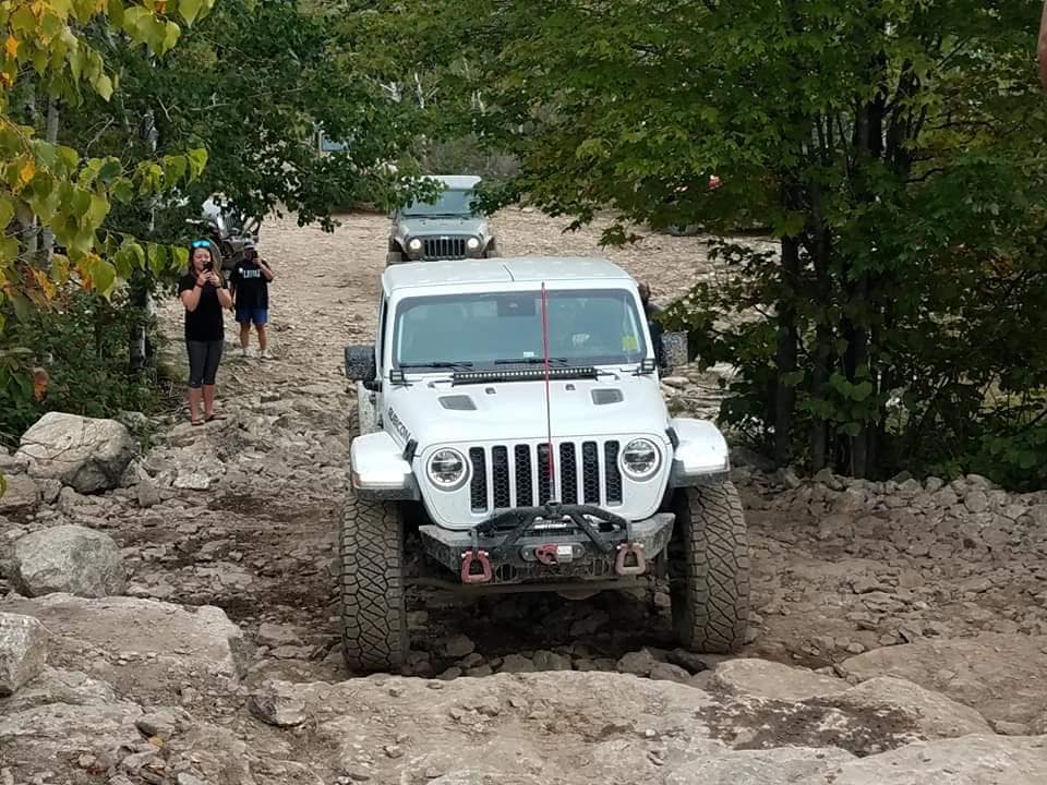

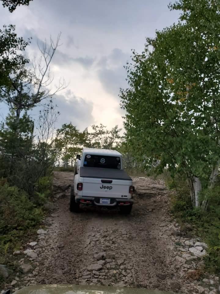

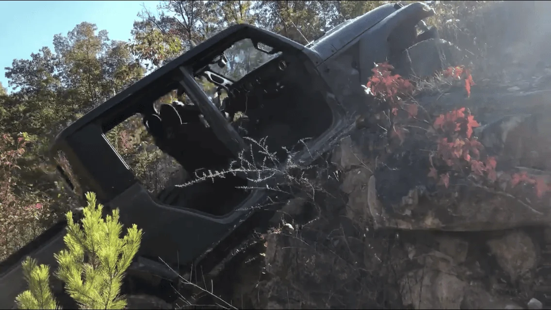

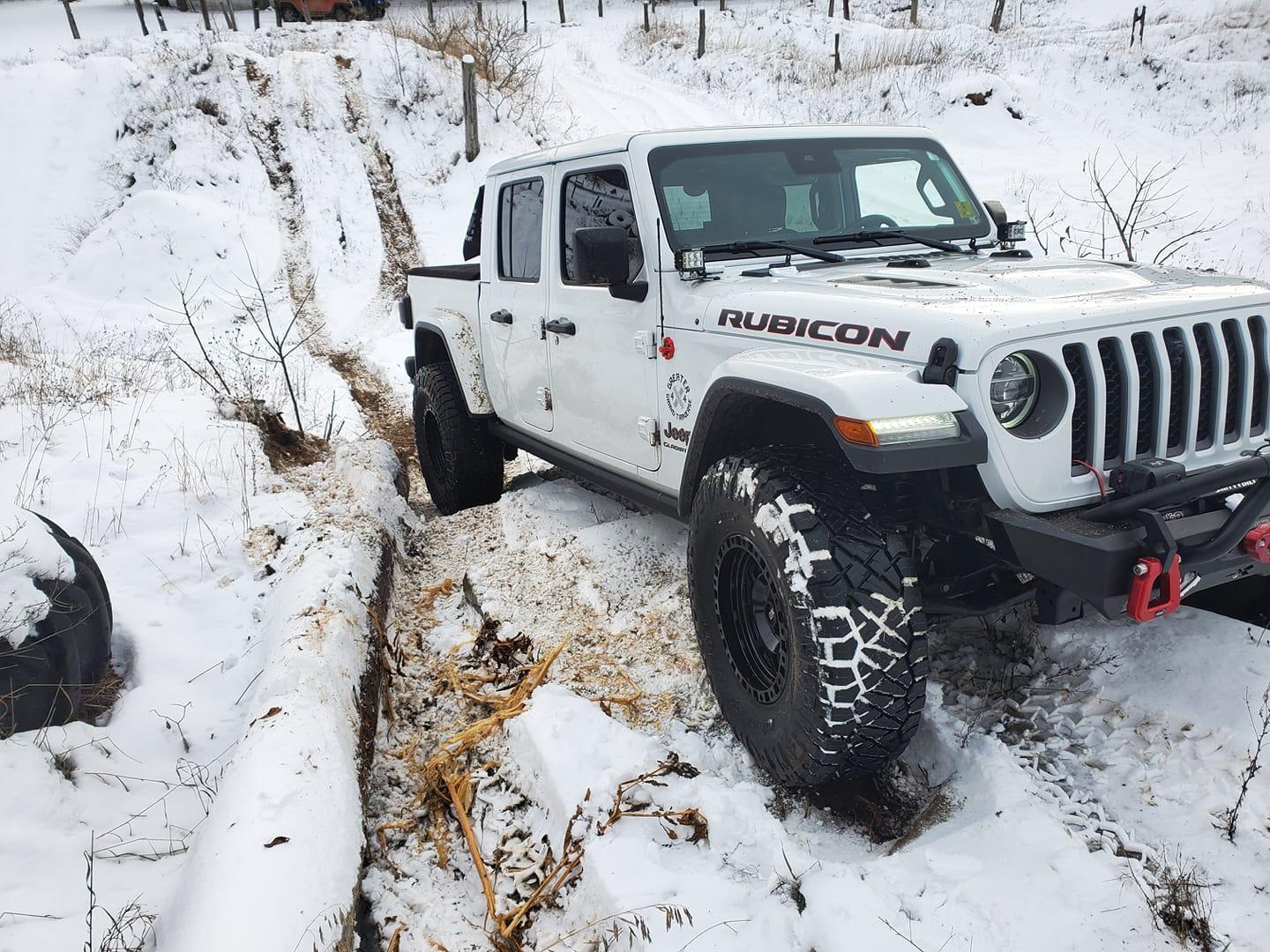

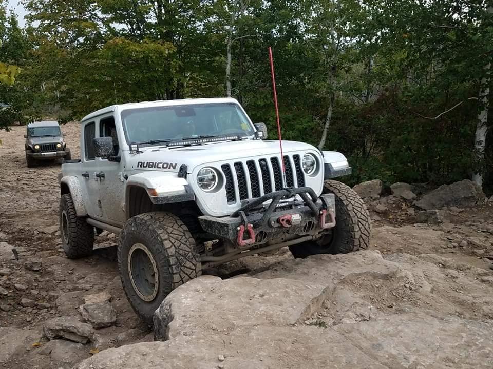

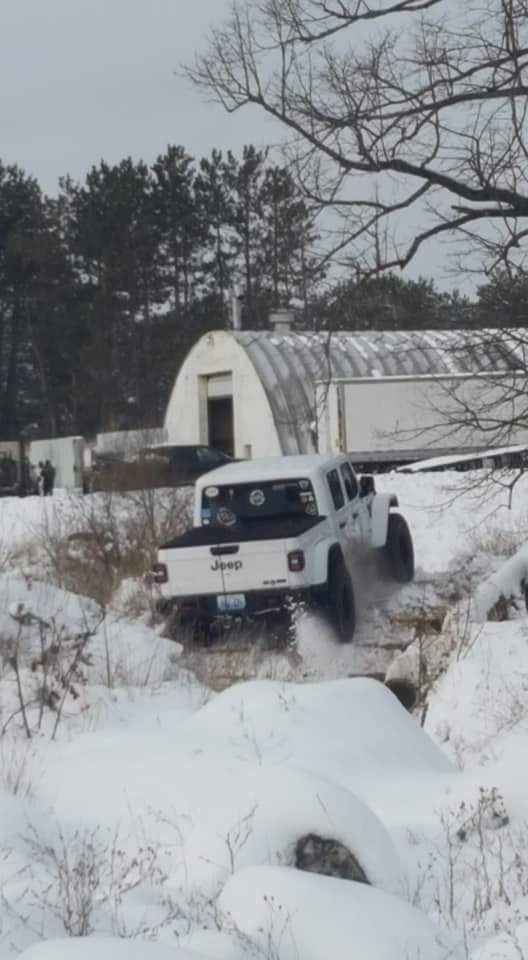

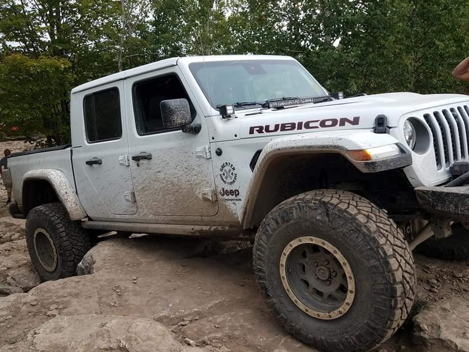

NItto Ridge Grapplers 37's , 4:10 gears and stock axles If I have not broken them yet you will be just fine lol
Thanks, that is great feedback! Do your 37s rub with the Rubicon fenders?

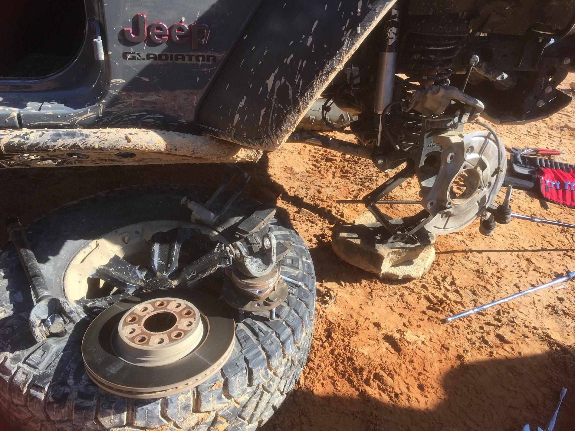

I broke a front axle u-joint this past weekend...
Do you know what caused it to break? Excess load while rock crawling? Big impact while rock bouncing?
I was climbing a very steep trail, and was spinning a bit to climb a ledge. It didn’t make it up the ledge, and I didn’t get my foot off the gas before the Jeep landed back down. Pop! Pulled the shafts and limped out.
