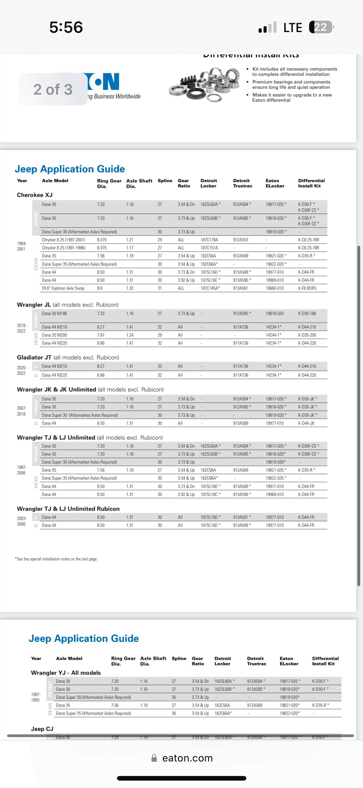

Plywood
Cody
Mar 8, 2021
165
205
Indiana
ā€˜21 Willys EcoDiesel
Pilot
So it'll fit the front as well ?. Would it make a difference over the standard BLD?
It would be much better than BLD. You can’t beat a mechanical lsd. It will engage smoother and quicker.
I think I'm gonna order one. I have an appointment on Jan 23. I hope it comes by then. It took a week to get the gears.
