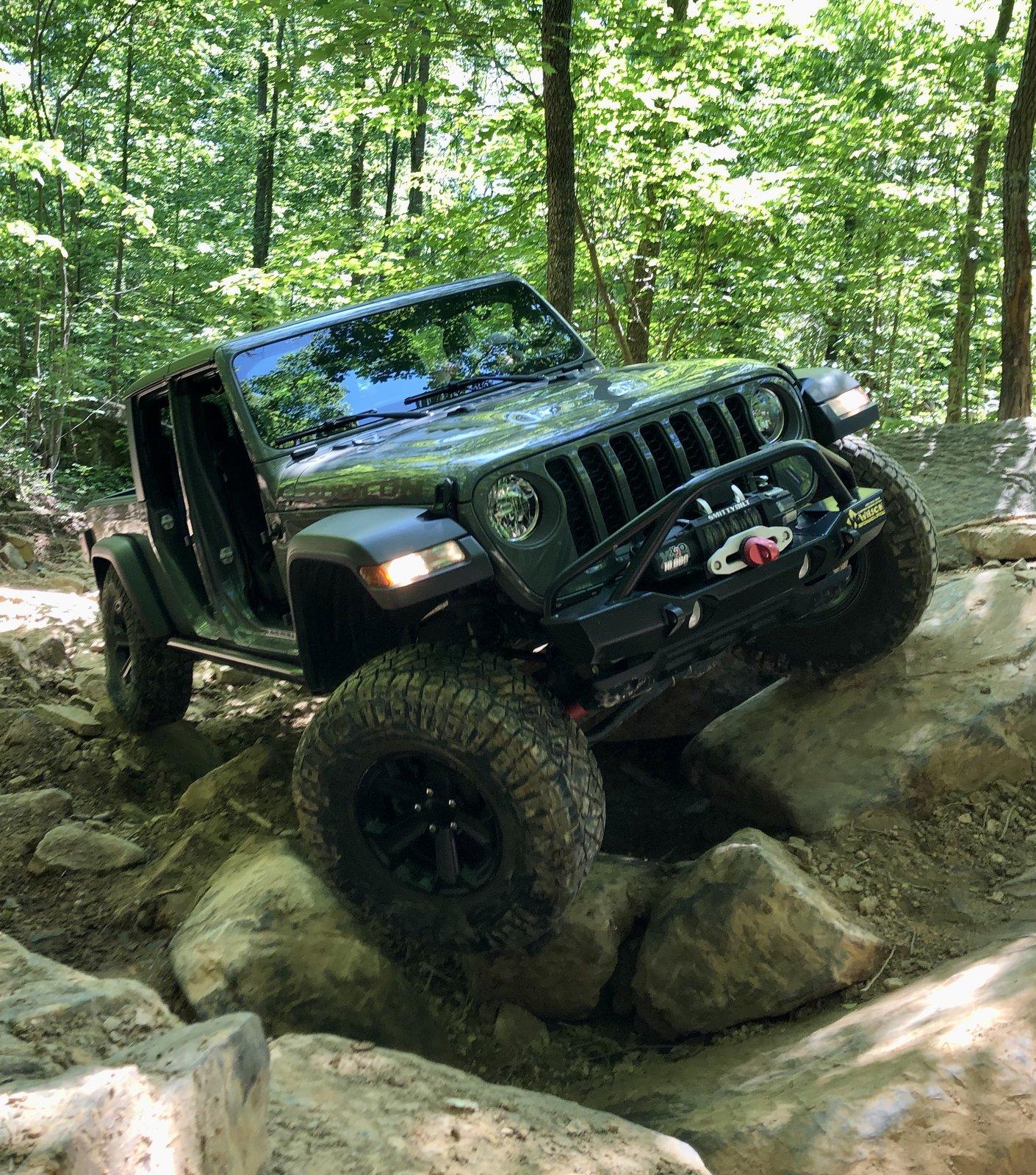

I am getting ready to go off roading for the first time since adding the Mopar lift and 37s. I have a Sport S with max tow, so the wider axels. I've read posts ranging from "stock axels with 37s will explode the instant you drive off pavement" (maybe slight exaggeration :)) to "I have stock axels and 37s and off road all the time." I have never seen the former group substantiate their claims, but have seen many from the latter group substantiate their posts with pics.
So, to give me confidence that my stock axels will not turn to shrapnel the instant my tires leave pavement, I'd appreciate seeing posts from people who off road with stock axels and 37s without problems. Pics would be great.
Thanks in advance.
Yes, and do so without fear just a little common sense.

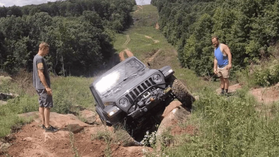

4” lift - 37s - 4.88s
No truss, no sleeves, no gussets
Still have the stock from axle shafts too.
And that’s 2nd gen D44s. These 3rd Gens are nearly D60s in some ways. I run 37s on my JTR and don’t plan on adding anything but gears.
Thanks, this is exactly the type of feedback I was looking for.

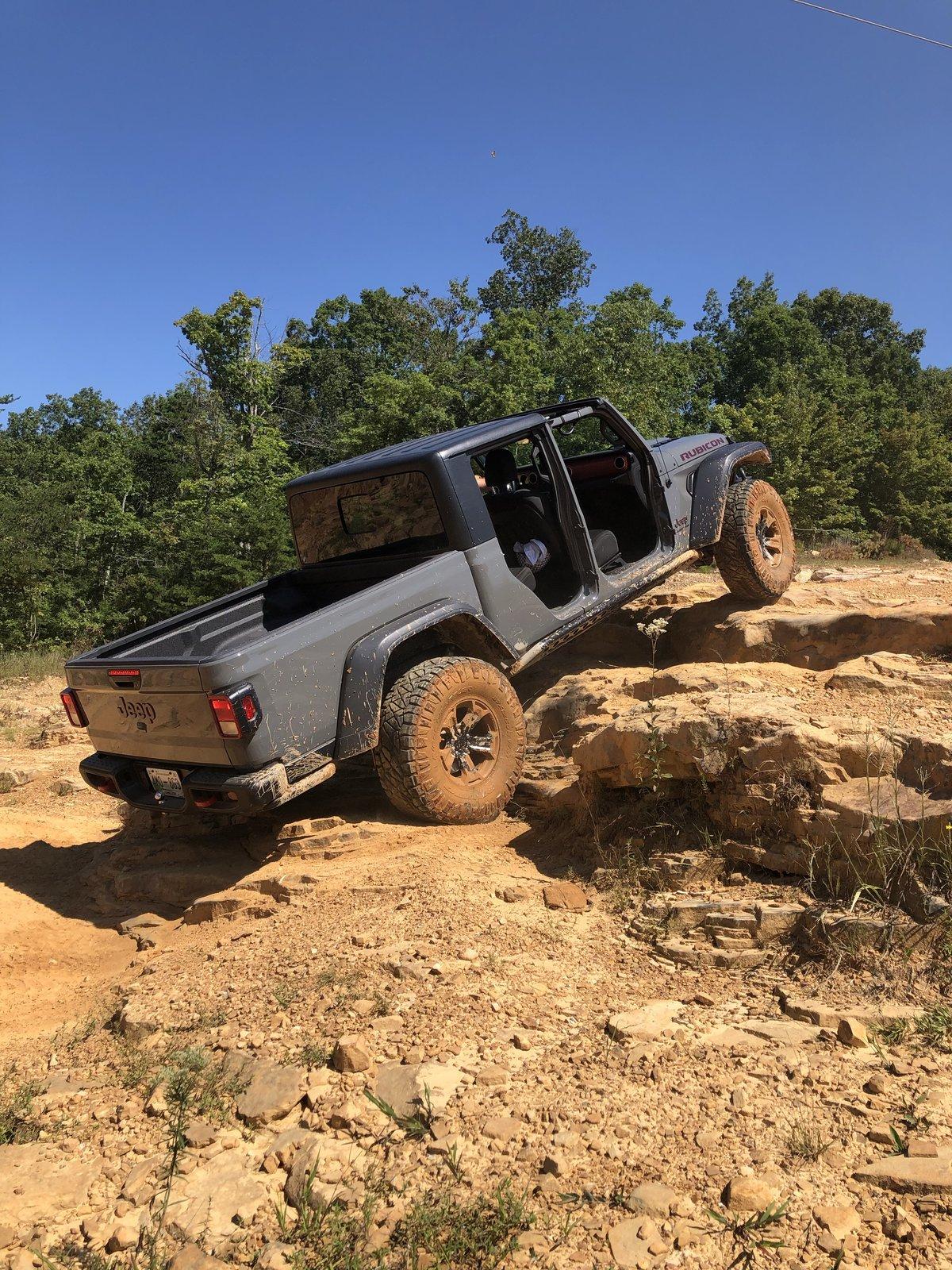

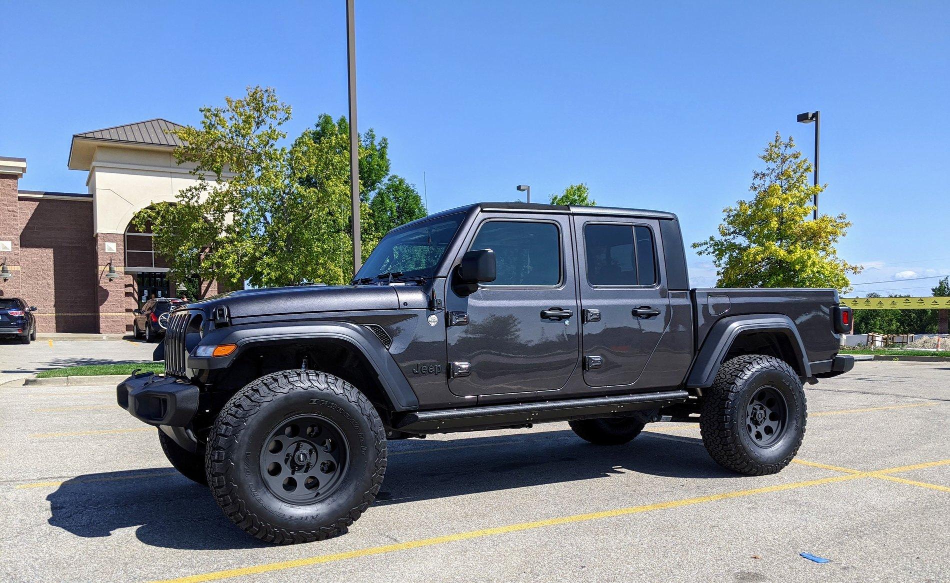

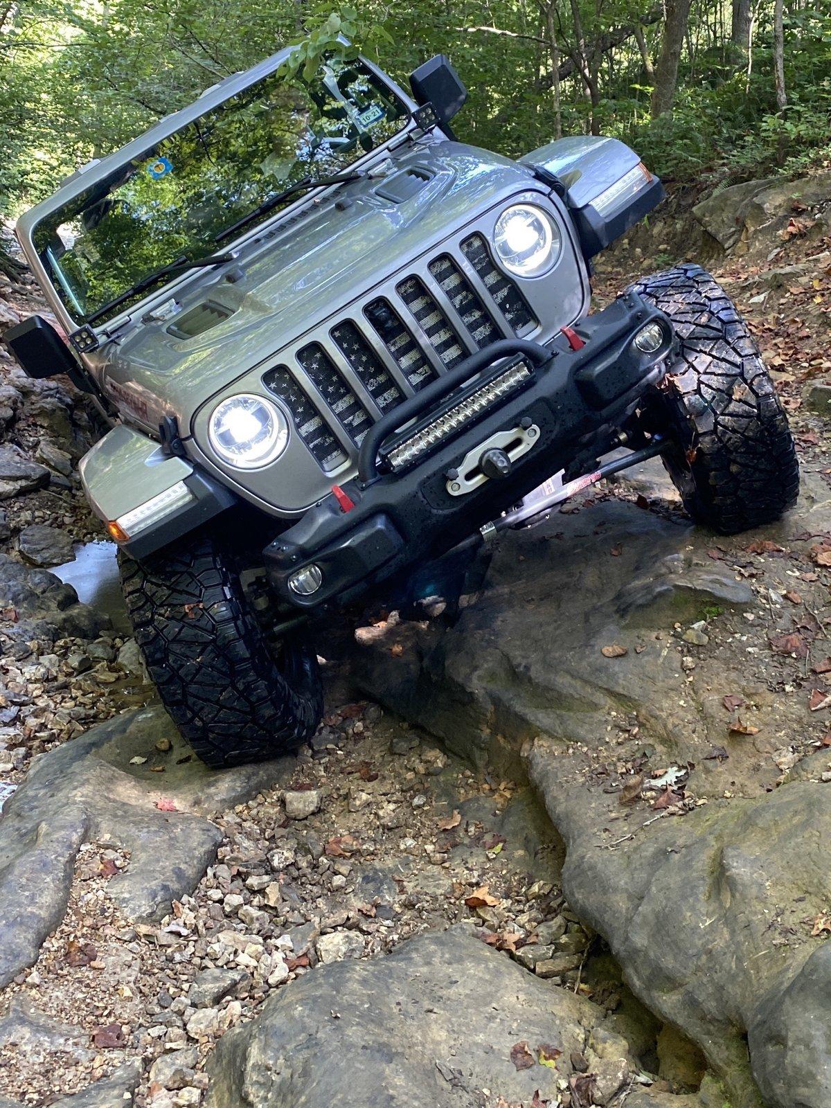

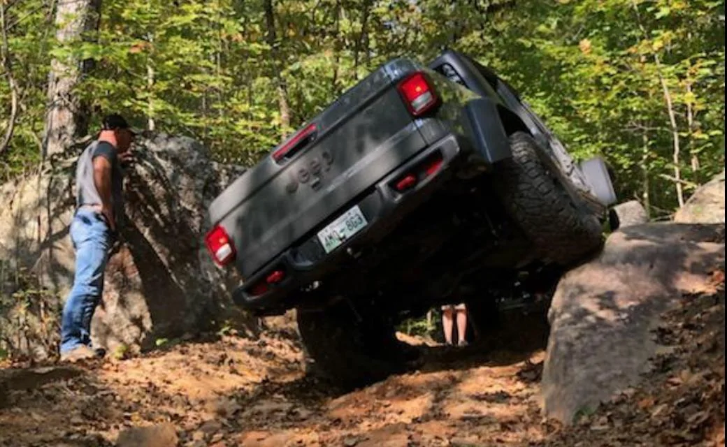

I attended the Jeep Adventure Academy at SMORR in Seymour, Missouri, over the weekend and did some trails I wouldn't have attempted before attending the event. I went back to SMORR the next day and did some more challenging trails and my Gladiator did fine--no broken axles!
I did find out, however, that 37s with the 2" Mopar lift with the say bar disconnected on a Sport S will absolutely rub the fenders (max tow, 17x9 wheels with -6mm offset, 37x12 BFG KO2s). Mine rubbed countless times over the weekend. Time for new fenders...
Some vids from my weekend at SMORR.
Cold Mountain, the fun part starts at about the 10:00 minute mark.
Get Ya Some, the fun starts about one minute in.

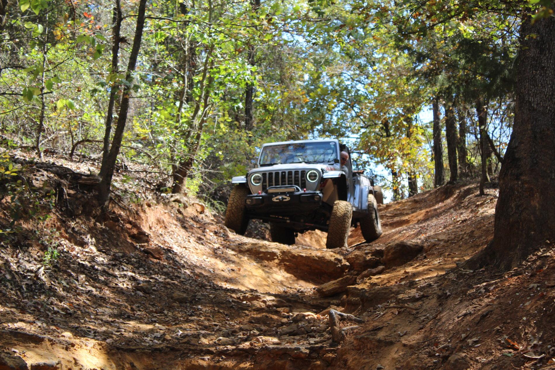

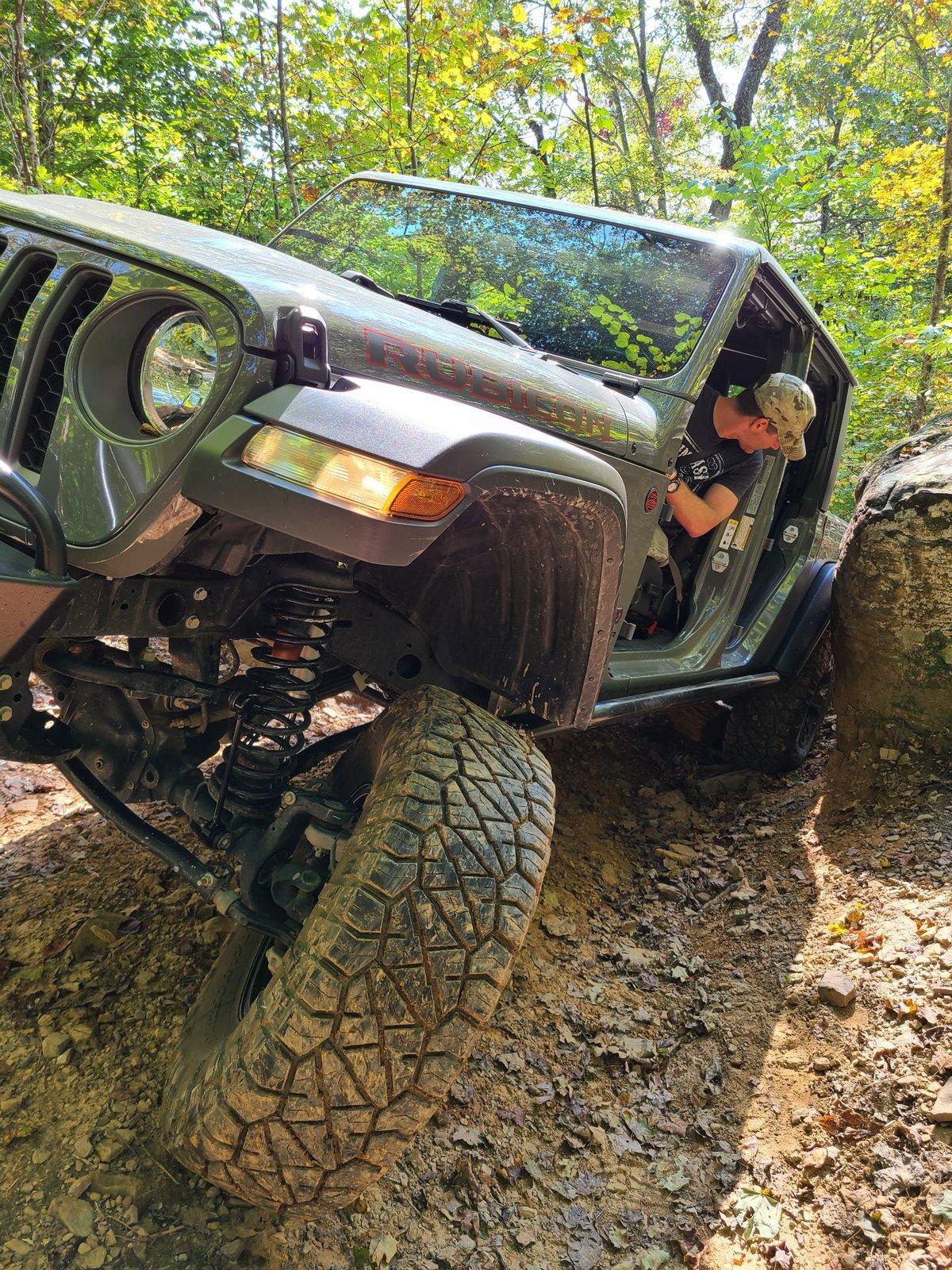

I’m on 3.5” lift with 37” nitto ridge grapplers and have had zero trouble offroad. I did regear a bit ago to 513s. But also ran the stock 410s for several trips.
Jeep Gladiator Can I Go Off Road With Stock Axels And 37s? 480E1545-C5BB-4E56-AFAA-CDEBBCD5E1E1
Jeep Gladiator Can I Go Off Road With Stock Axels And 37s? 03A4B55D-C404-4B4F-ABEC-B459266F4D7A
